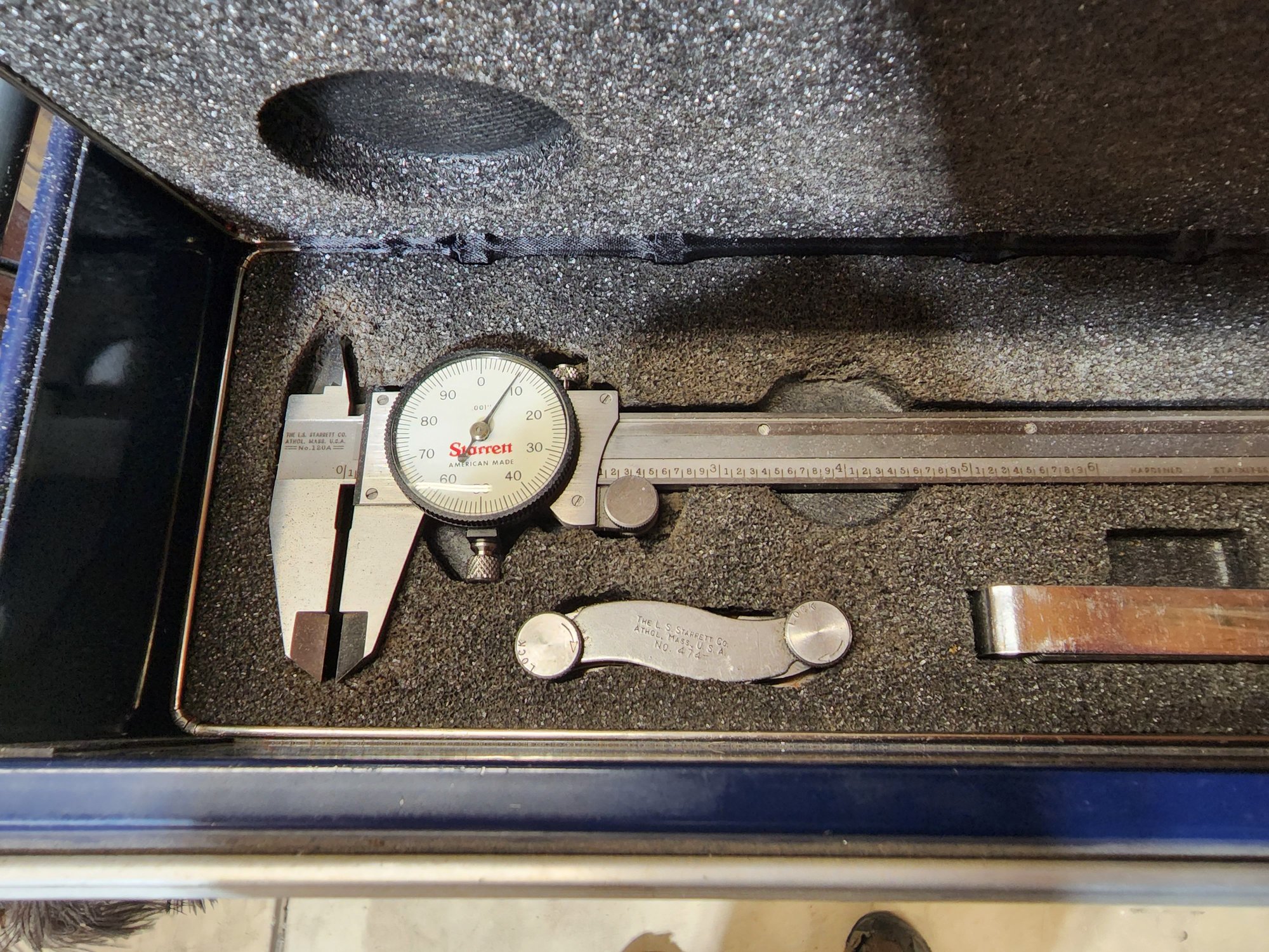

How did you measure the ID of the bushing?
Which direction did you install the seal?. Skirt spring needs to be on the inside.
Old Sep 18, 2022 | 07:18 PM
MotoJockey's Avatar
MotoJockey
Joined: Jun 2017
Posts: 4,652
Likes: 3,960
From: Near Yosemite
How did you measure the ID of the bushing? Starrett Dial Calipers....
Which direction did you install the seal?. Skirt Spring on inside....
