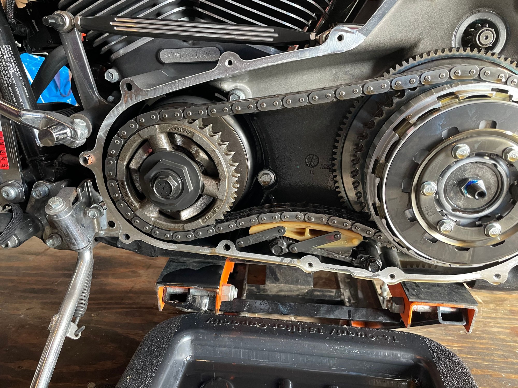

That is the manual tensioner we installed in the 2011 RK. Seems to be on the expensive side but if you do your own work it costs not much more than a good fluid change. I know there are those that feel the auto tensioners do a good job. We did my 2000STC and the RK side by side. We found my chain at 7/8 cold but found the RK chain so tight it couldn't be moved. Regarding the inspection protocol I would check it the same as a stock manual tensioner from the SM
Top photo RK with upgraded manual tensioner 7/8 cold
Botton photo OEM tensioner as we found it, no slack

Old thread brought up by another user, but anyone else see the issue of a supposedly stock 2011 auto tensioner too tight?
Interestingly, it's appears bottomed to me like when it's tied down when you install one. Is it me, mismatched parts or what?
I know chains don't wear evenly, especially if bike is driven hard and beat on.
Then the auto can possible get too tight.
However, why would it appear to have no play with tensioner bottomed?
