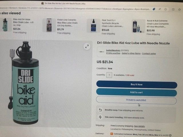

Old Feb 22, 2024 | 09:38 AM

https://www.cabelas.com/shop/en/waps...E&gclsrc=aw.ds
Get one of these bottles
