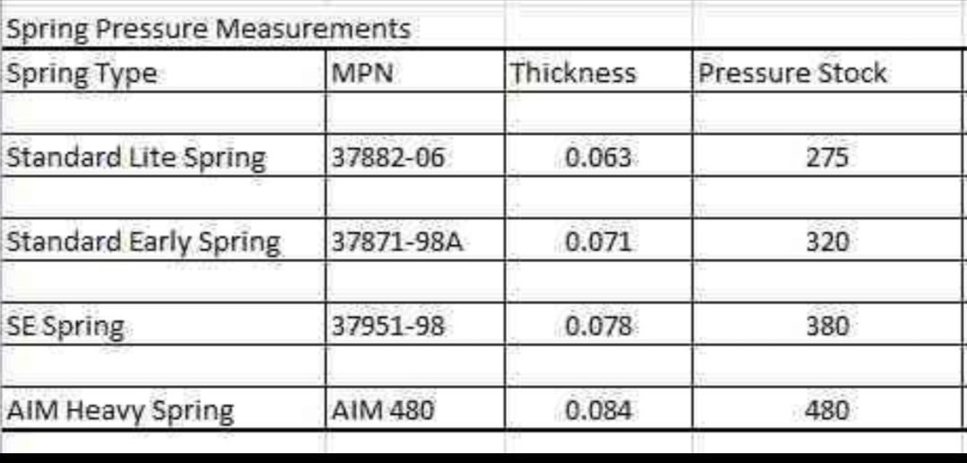

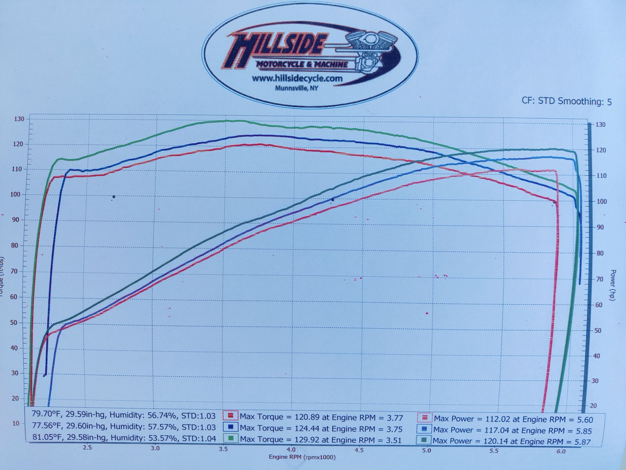

The Energy One Clutch pack with a Screaming Eagle Spring is all you need.. Mine is holding 125/130..
CORRECTION: 120/130.. I didn't want to mislead anyone...
The dip at 3500 was do to too small of a pipe 1 3/4 primaries to q 2-1. Hooker... That i have removed and installed a better breathing system...
And here's the clutch spring
