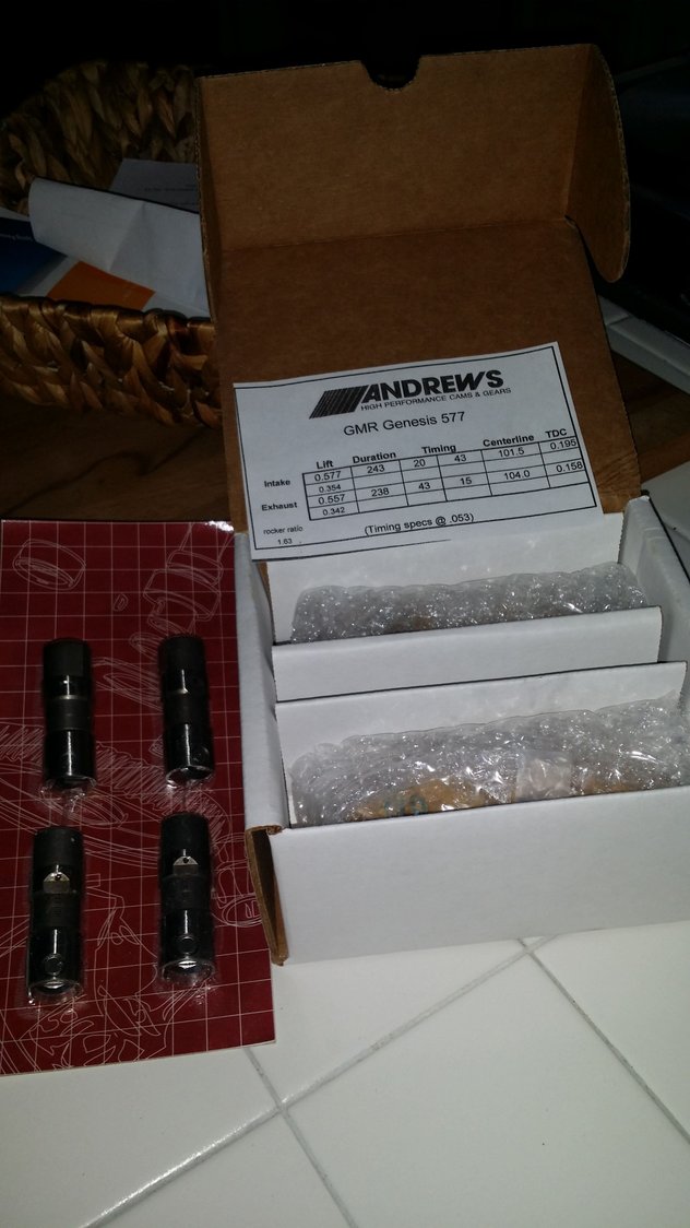

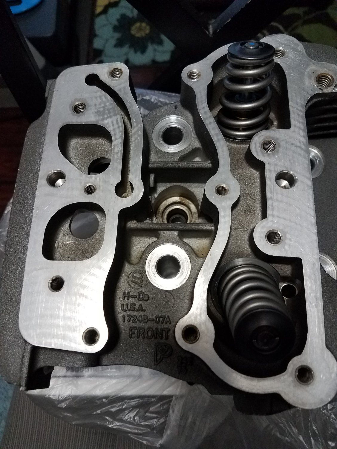

When I upgraded my motor to a 117" Pro Race Big Bore kit.
I had my cranks worked by Dark Horse, SE Timken bearing, Conical Beehive .650 springs, AV&V Bronze valve guides, Head work by HD Street Performace, GMR Cams/Lifters, new SE Comp Sprocket, along with a hole lot of other stuff.
It's as bullet proof as I can make it, and they way it should have came from the factory!
