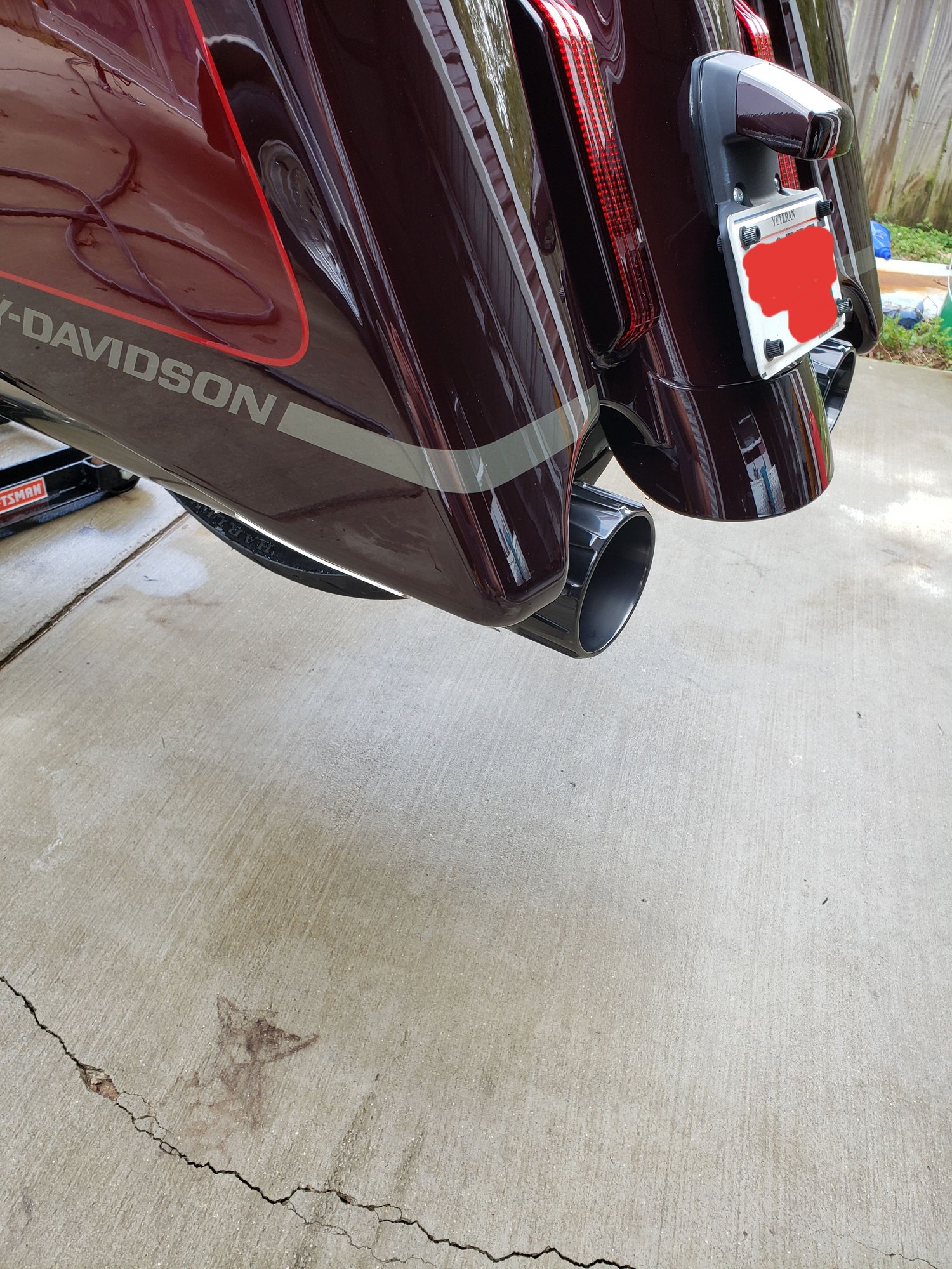

I thought about doing the fullsac but didn't really want to hack up the stock cans, I just went ahead and got a set of magnaflow knockouts, love them, very deep!

Originally Posted by Mofo67
Quik - what color are the heat shields on your mufflers or did you replace your entire exhaust? I did a little exhaust shopping yesterday and could not find anything in gloss black.
I kept the stock heat shields, they are kind of a antique bronze color, never seen the color til I got this bike, I really like the color so I wanted to keep them. The magnaflows I bought are black 4 inchers, put the slip on shields over them so it worked out great.
