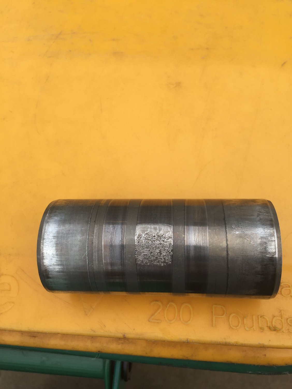

Originally Posted by Screamin beagle
My crank took a dump at just over 49k. I thought I had addressed all of the 110 shortcomings. Just got it back together a week ago. Put a man o war crank from darkhorse in. I hope to get at least another 50k out of it now before I have to go in again. Can you define "blew up", is it fubar or is it salvageable? There's alot that can be fixed...with alot of money of course. Let us know what is going on with it.
SB What exactly went on your crank ? I had one go at about 27,000 miles. Looked like the crank pin started to fall apart. Mine was a 2012 CVO Road Glide, and yours was a ?

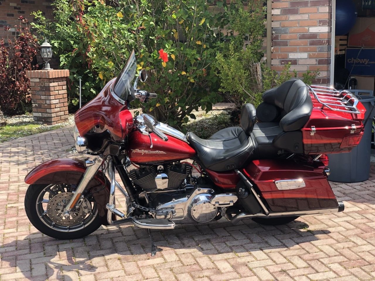

Default 70,000 and still riding like a dream

Originally Posted by DWCVO
What year is your bike?

From: FL
2009.
