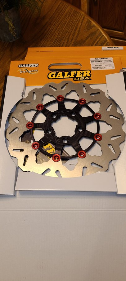

Sorry to bother but need assistance im looking for the torque specs for front rotors, front axle pinch bolt, an front axle. Trying to replace rotors and pads due to warpage have had the parts and orderd the service manual but it's been 66 days on back order just want to get the parts changed

front disc 16-24 ft lbs, axle nut 70-5 ft lbs, pinch nut 18-22 ft lbs
