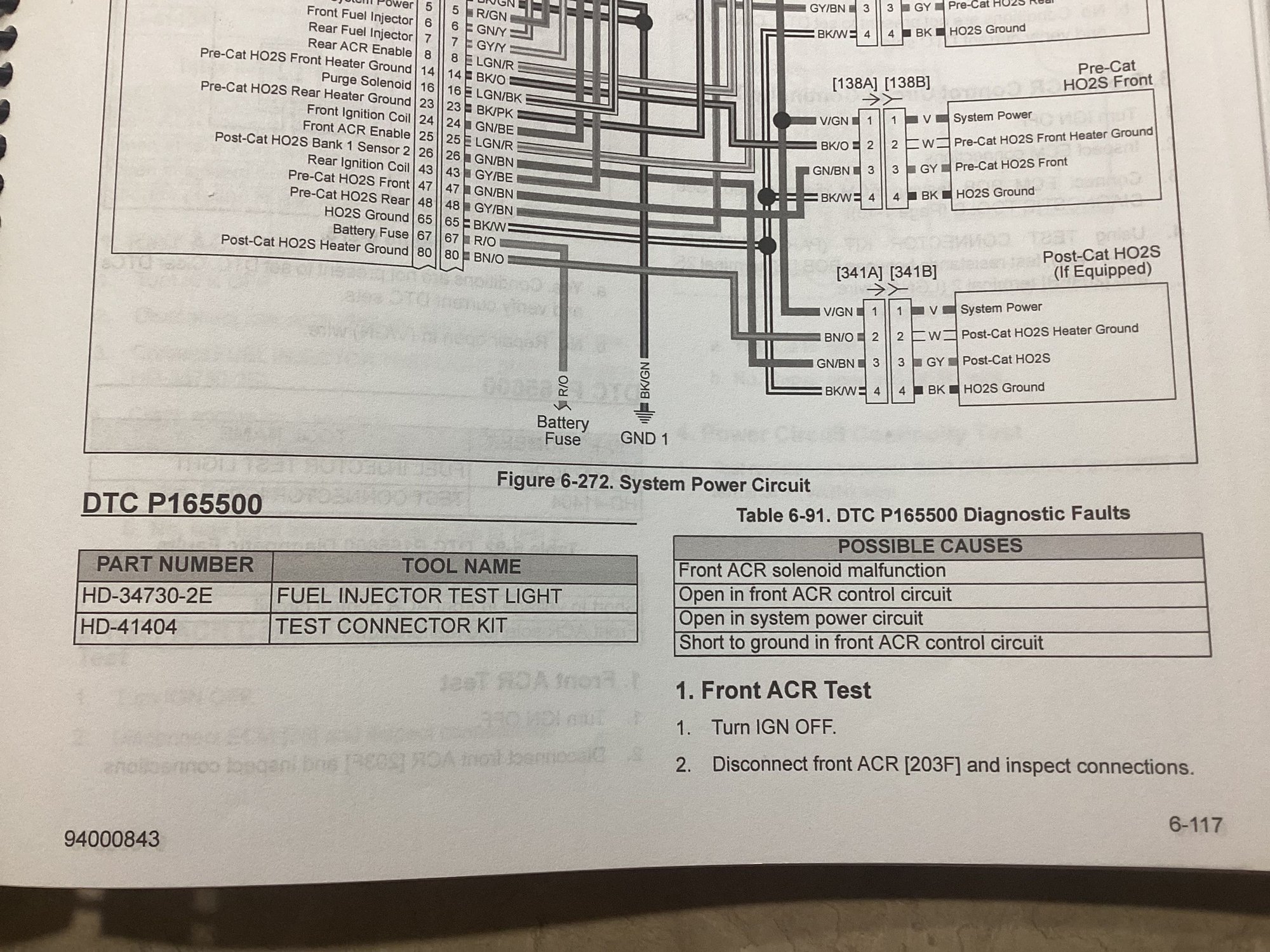

@FLSTFI Dave From 2021 Elect Diag. Manual: Front ACR Solenoid malfunction
The 2023.5 CVO has an all new ECM. It's also a 2nd Gen M8.
Could be the same thing for the DTC. Internet search shows three possibility's , ACR, Cam position sensor and cam actuator. I have not been able to find the DTC list for the 2023.5 or 24 CVO 121 VVT.

@Vernal You were correct front cylinder ACR.
Road over to the dealer yesterday for the P165500 Code and to load test my battery as bike wont start when cold. Also to check the fluctuating volt meter. Also have the the recent 1-27-2025 Skyline OS software update.
ACR tested good. Software updated. Battery load tested good. Dealer test rode bike, no issues.
Put my gear on, start bike, check engine light come on. Shut bike off, get service writer to come out. Code P165500, so they now have an ACR on order. Restart bike CarPlay will not load, an issue the new software was to fix. Two attempts and it loads. Riding home the Voltmeter is fixed, very steady. Stop for gas, First power up, CarPlay won't load Turn off try again and it loads.
