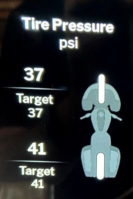

Not a CVO, but my Skyline TPMS does an odd thing every now and then. I've never had it go to dashed lines, but...
Normally the display will show the current tire pressures front and back. Underneath the current pressure it shows the target pressure. Normally 36 PSI for the front and 40 PSI for the rear (As in the owner's manual).
But every now and then the target pressure changes to match what's in the tire currently. As in the example below:
I live with it
