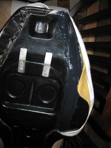

Found two cracks in seat that i am repairing, using fiberglass cloth and flexible 5200 sealant.
