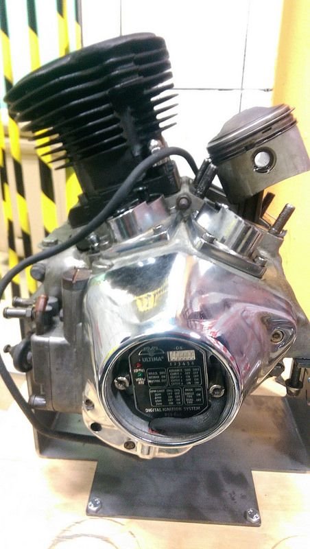

I just wanna say, I picked this bike to have fun and to also Experience what the Harley feeling was about. I never thought I would meet all you guys, ALL THIS IS A PLUS AND A GIFT Well, i didnt even have a chance to see if I like this fkn motor. So giving up this easily is not a option!!!
SO HERE SHE IS WILLING AND WAITING, where do we begin to find out what the problem was?,,,

Luke, what's the cylinder walls look like? Are they gouged or tore up badly? Also, didn't you mention in your first post the engine just had a fresh top end job??
I believe a rod bearing went out nuking that rod. It's welded itself to the crank pin. In the pic your seeing just a piece of it. The connecting rods are a closed end set up. The crank pin slides through them and thrust washers, then a flywheel on each side.
Like mentioned before, unless you've split engine cases to replace rods and crank pin before, I would recommend a shop do this. You've got the hard part done, pulling it out of the bike.
You also want to look real close for any signs of a crank in those cases. The damage done here can cause this. If there is, the engine is junk.

After a second look of your other pics it almost looks like maybe a piece of piston skirt stuck in there. Hard to tell from the pic.
Can you determine if that is aluminum or steel, soft material or hard??

Hopefully after i dig deep we will find the culprit needa make me a piston removal tool first, geeez now i need wood tools also... will see what i come up with! Probly gonna try beating on her with the rubber mallet somemore first its just the caveman in me letting off steam ...but Gently!!!
Gonna try to answer all your questions and get more pics soon!!!

How about 2 piece of threaded rod long enough to go thru the cylinder/head bolts holes and stick up 3-4 inches. A piece of flat stock or angle iron drilled to accept the threaded rod. A block of wood that would fit inside the cylinder and stick out the top by 3-4".
A few heavy washers & nuts for the rod and you would have your own press to remove the piston from the cylinder. And yes, beating it with a hammer would relieve more tension.

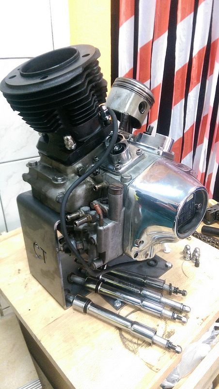

Ok this is what we got after getting REAR head off!!!
https://www.flickr.com/photos/152682.../shares/iMwN9h
Feels like front rod is broke off cause it wiggles around loosely and back rod seems to still be attached and did a back bent but is still hanging on!!!
