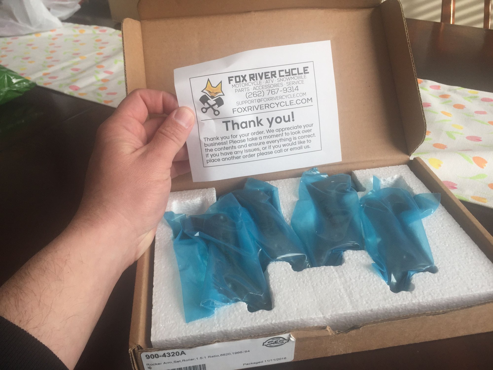

Well, after not being able to find much online about S&S rocker boxes and rocker arms I figured I would get a set and post something up about them. I didn't actually buy them just for research, I bought them because I am rebuilding my 84 shovel and I had finally worked up to the top of the top end. I posted recently about some aftermarket issues that I had with rocker arms. The combination of being flustered and having a sudden big overtime paycheck led me to say eff it and I went for the S&S stuff. I already had replaced my cylinders and heads with the 80 ci S&S kit so I figured I might as well get the new tech all the way.
I have to say, their engineering ideas are pretty cool. Here are the "unboxing" pics:
