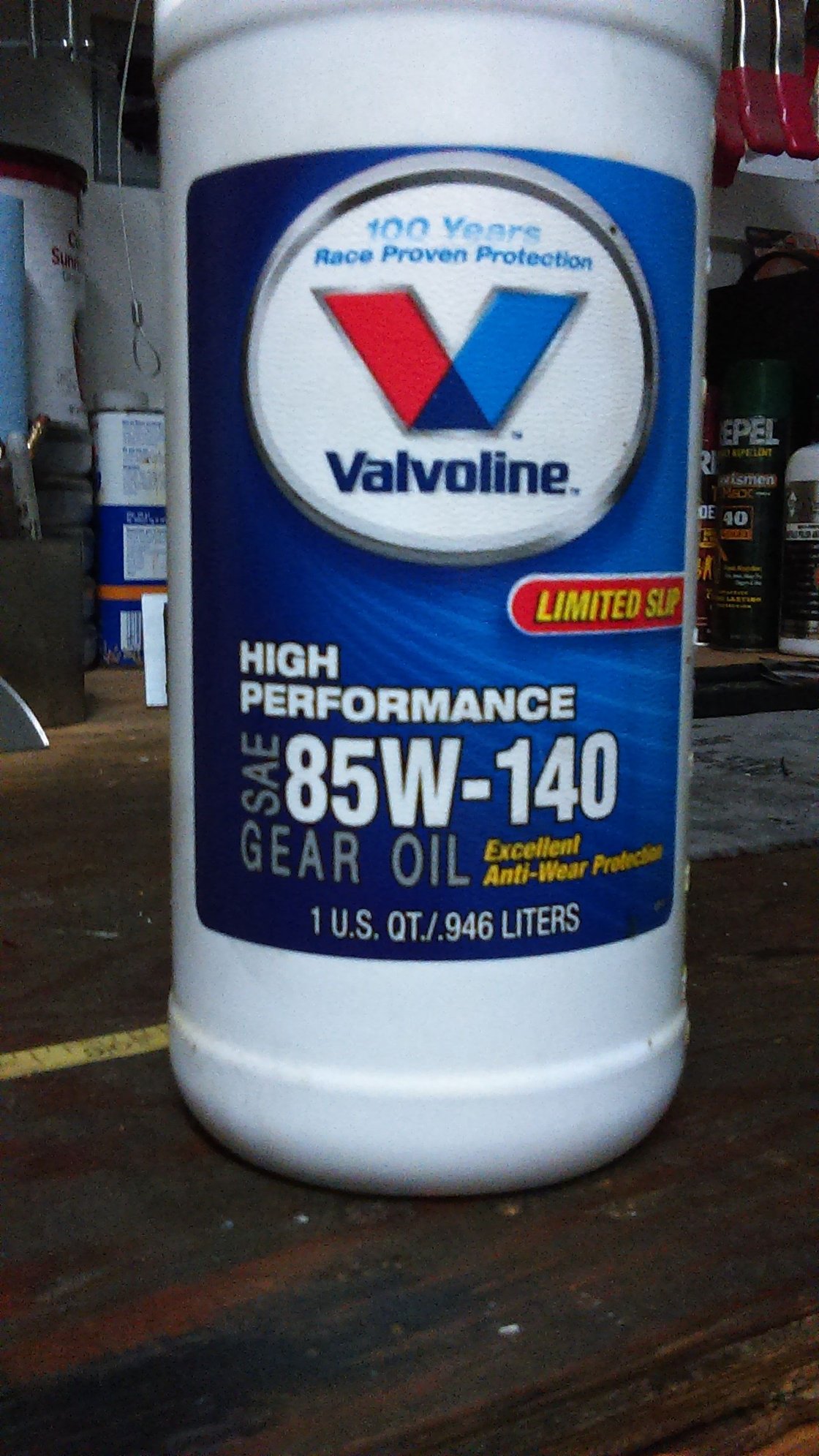

Valvoline has always been my preference for many years on a numerous application ,hasn't let me down ever.
