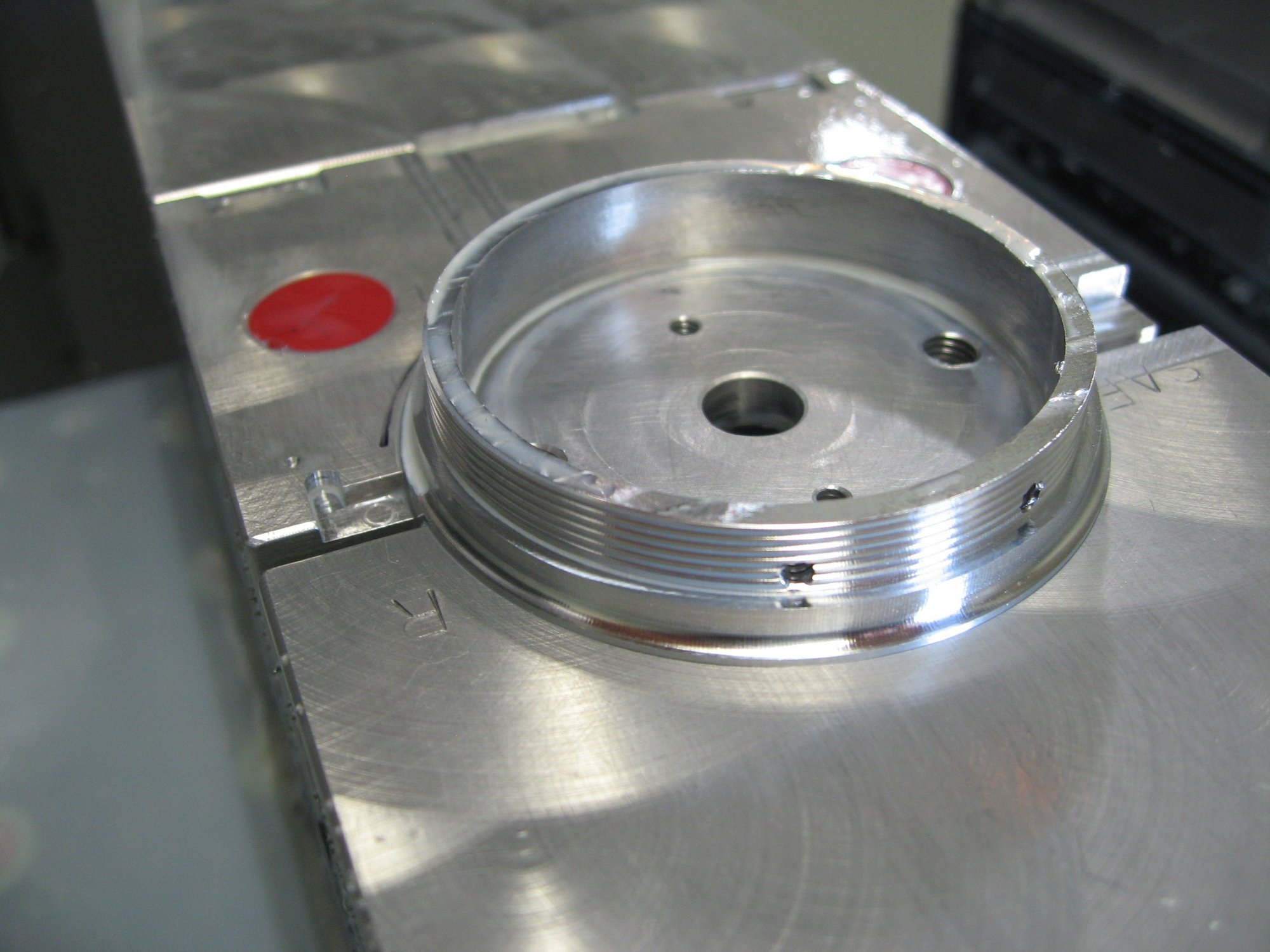

Originally Posted by RHPAW
Hannibal, is that ridge on the left-side case by the stator cracked? Mine was. Instead of trying to repair that, I milled it completely off and went with a flat gasket. It worked.
Originally Posted by Hannibal Smith
Yes, it was cracked, so the previous owner just gooped it to seal with an enclosed primary. Since I am running an open belt, I just machined it all off.
I have tigged a new ring on those before then remachined it using an arbor I made to chuck the case half up in a lathe using the timken races & bore. Never tried the flat gasket trick, always went belt if they where roached and it was my sled.

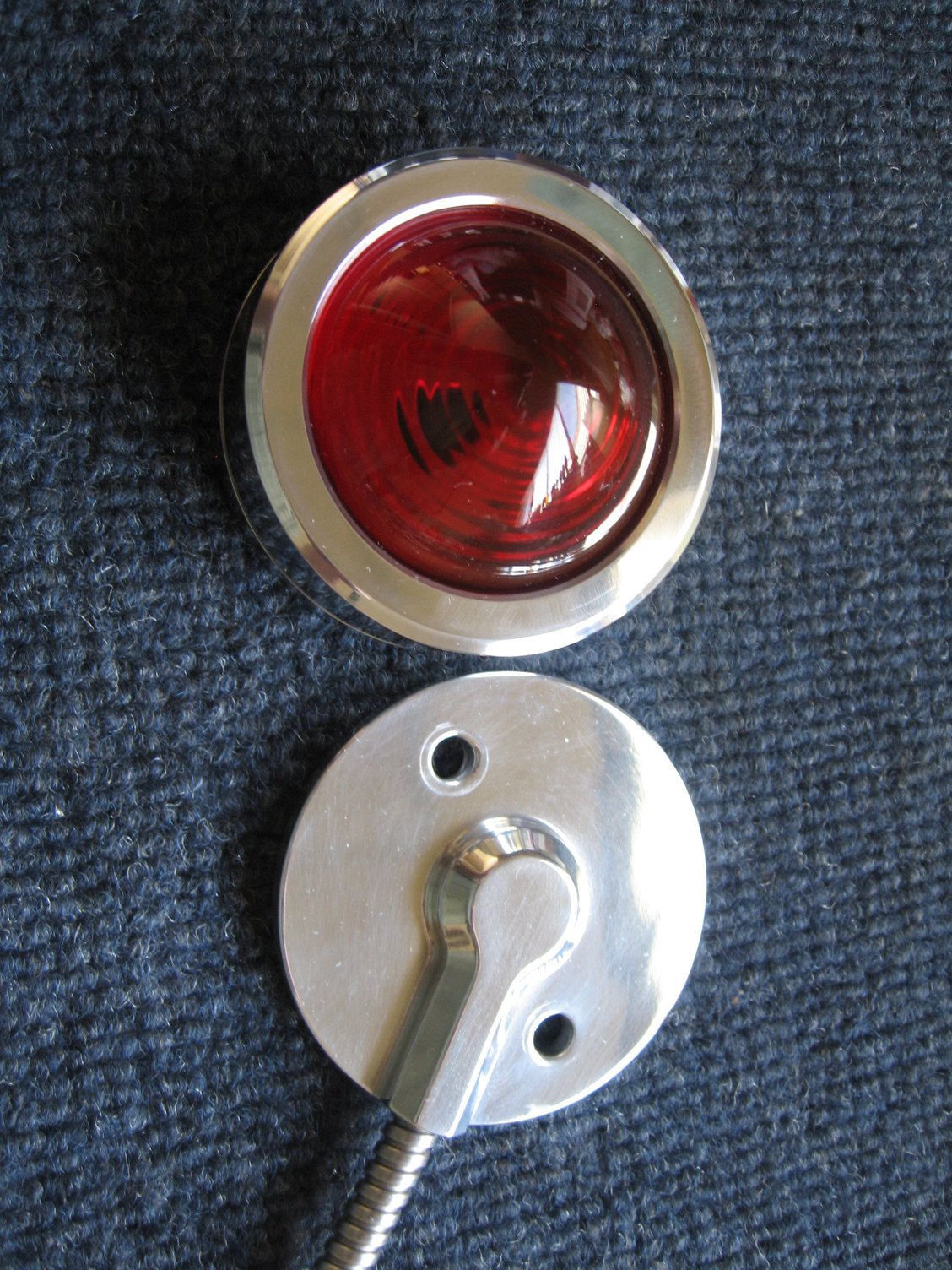

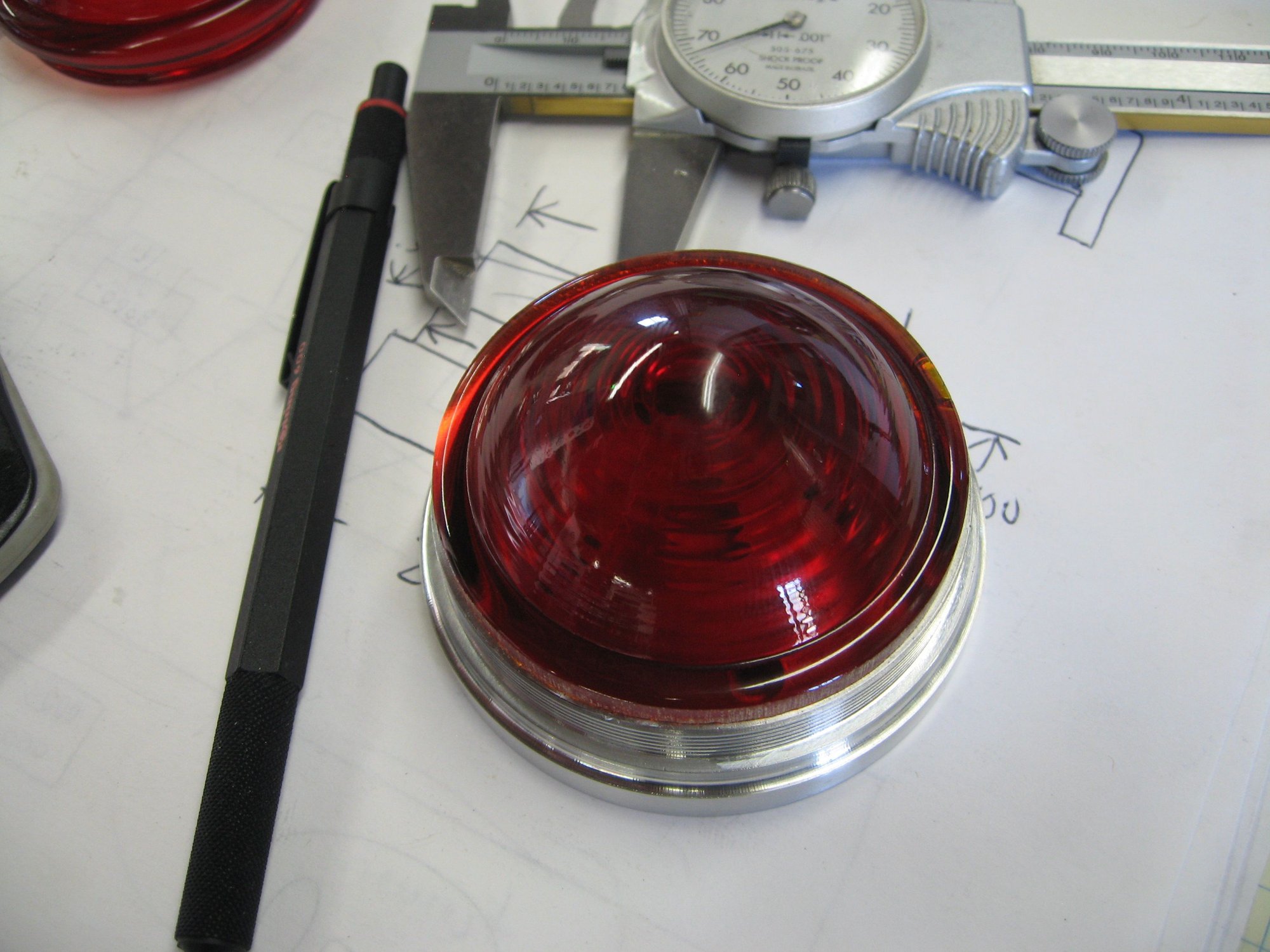

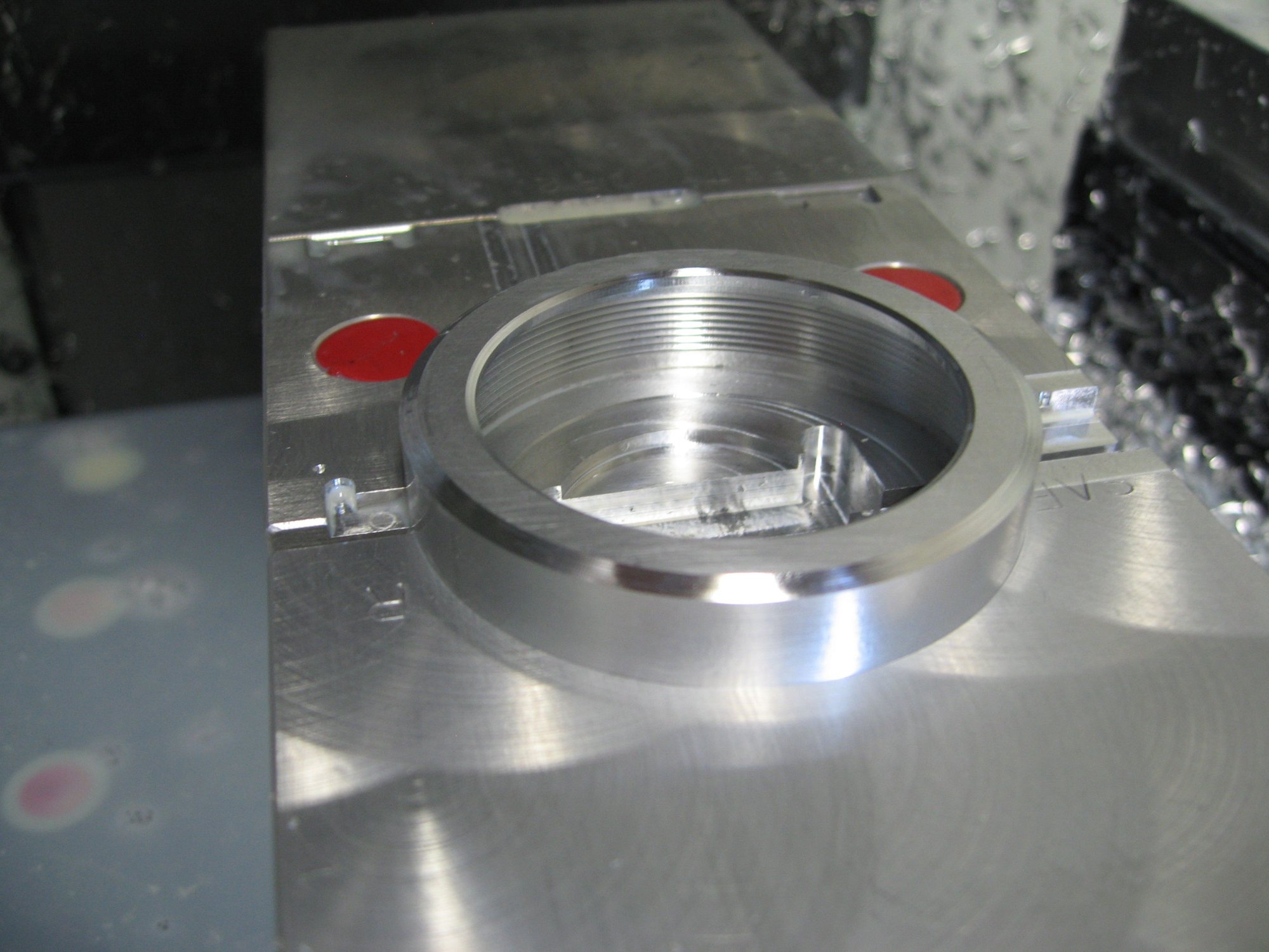

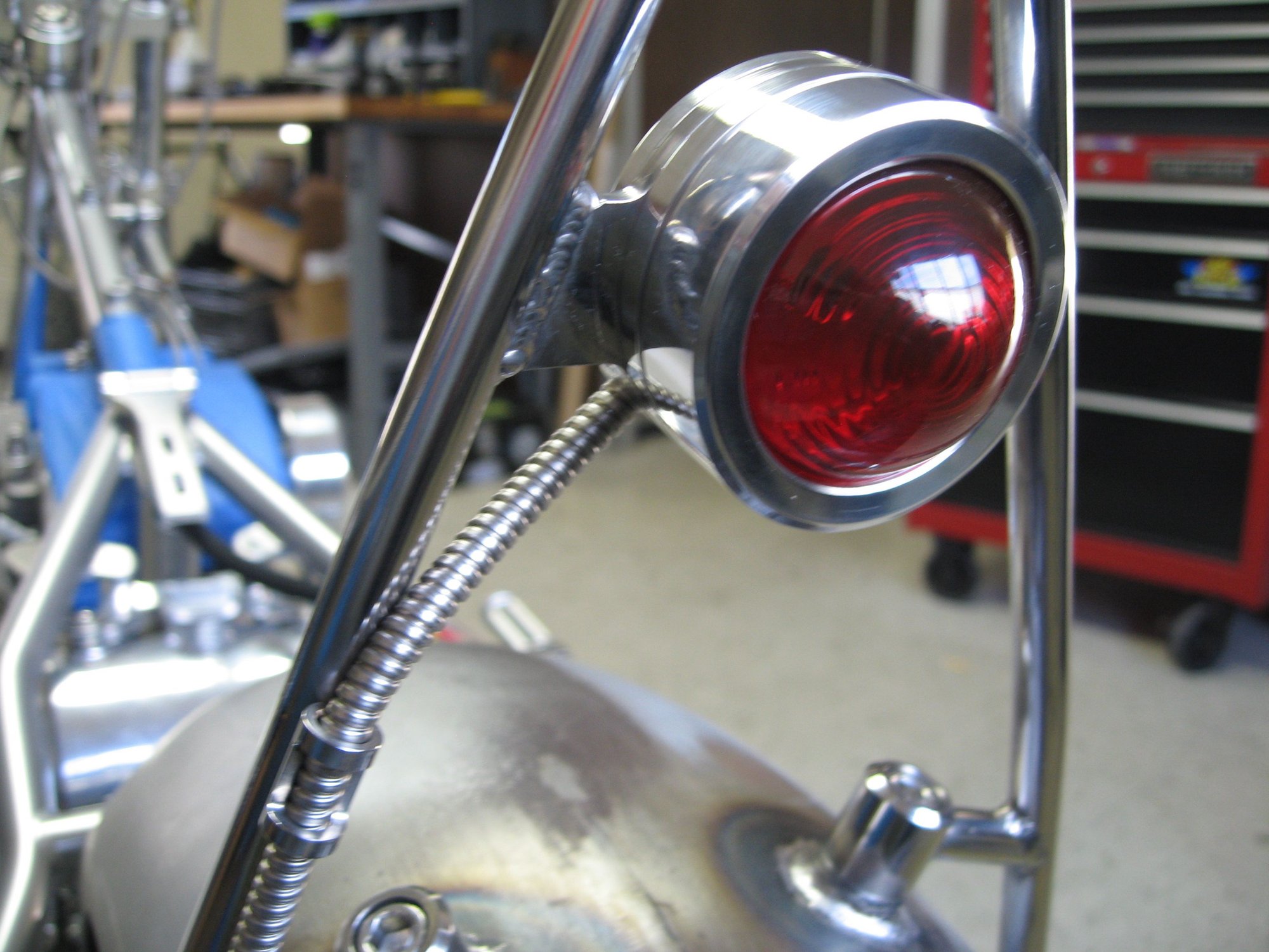

Making my taillight assembly. I sourced a USA made glass lens, and built the housing around it.
I machined some fine threads (24 TPI) and it drops right in, then is secured by the screw-down bezel.
Made the back plate so that I can route the stainless conduit at a 45 degree angle. I made the sissy bar from 304 Stainless, and made little conduit guides to give it some character.
It looks better in real life!
