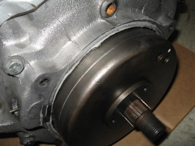

Originally Posted by Hannibal Smith
Hannibal, is that ridge on the left-side case by the stator cracked? Mine was. Instead of trying to repair that, I milled it completely off and went with a flat gasket. It worked.
Yes, it was cracked, so the previous owner just gooped it to seal with an enclosed primary. Since I am running an open belt, I just machined it all off.
Not unusual for '79's I guess. I'm still running a primary chain, although I isolated the primary and vented it like an Evo. It works well.
