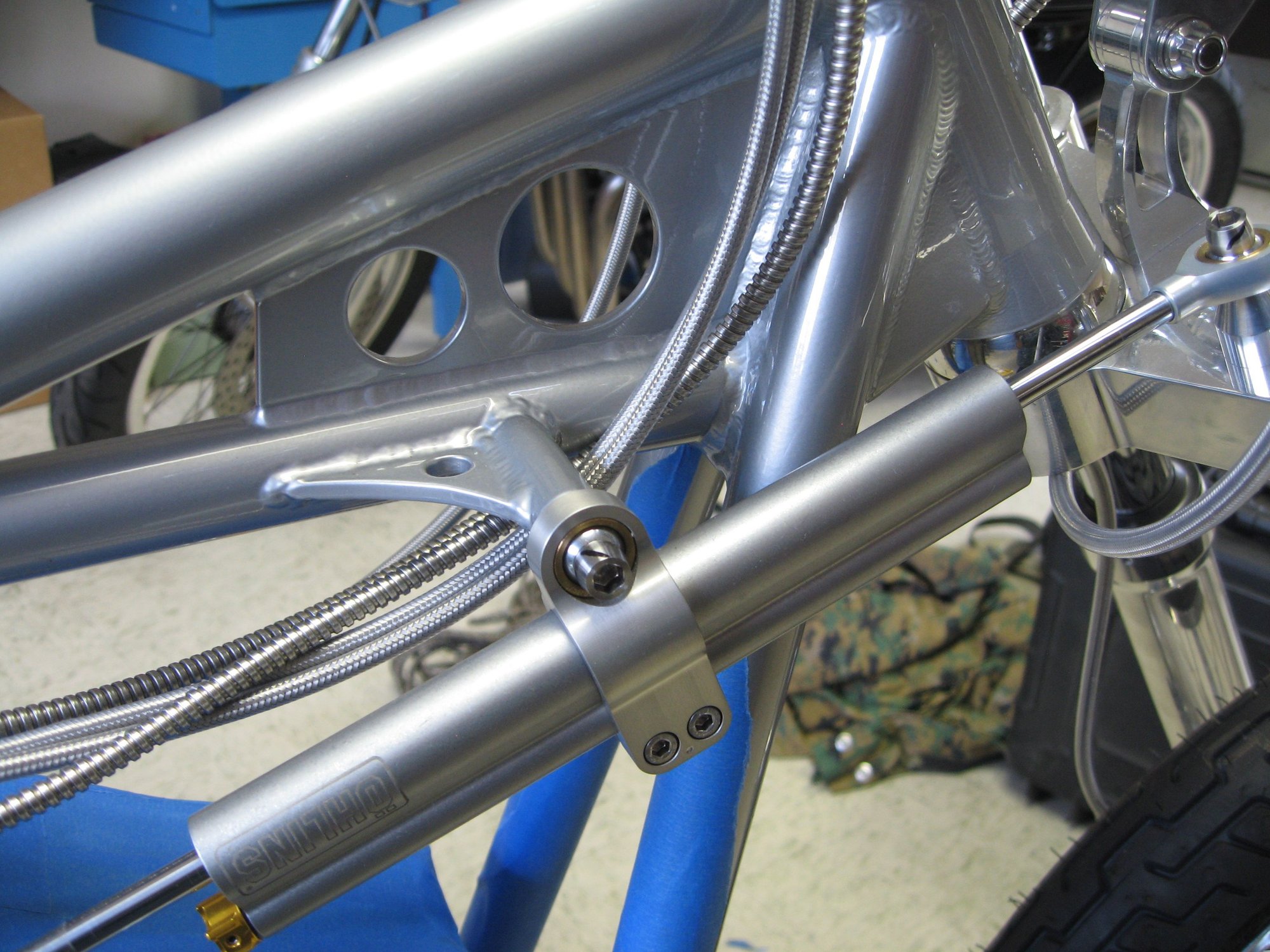

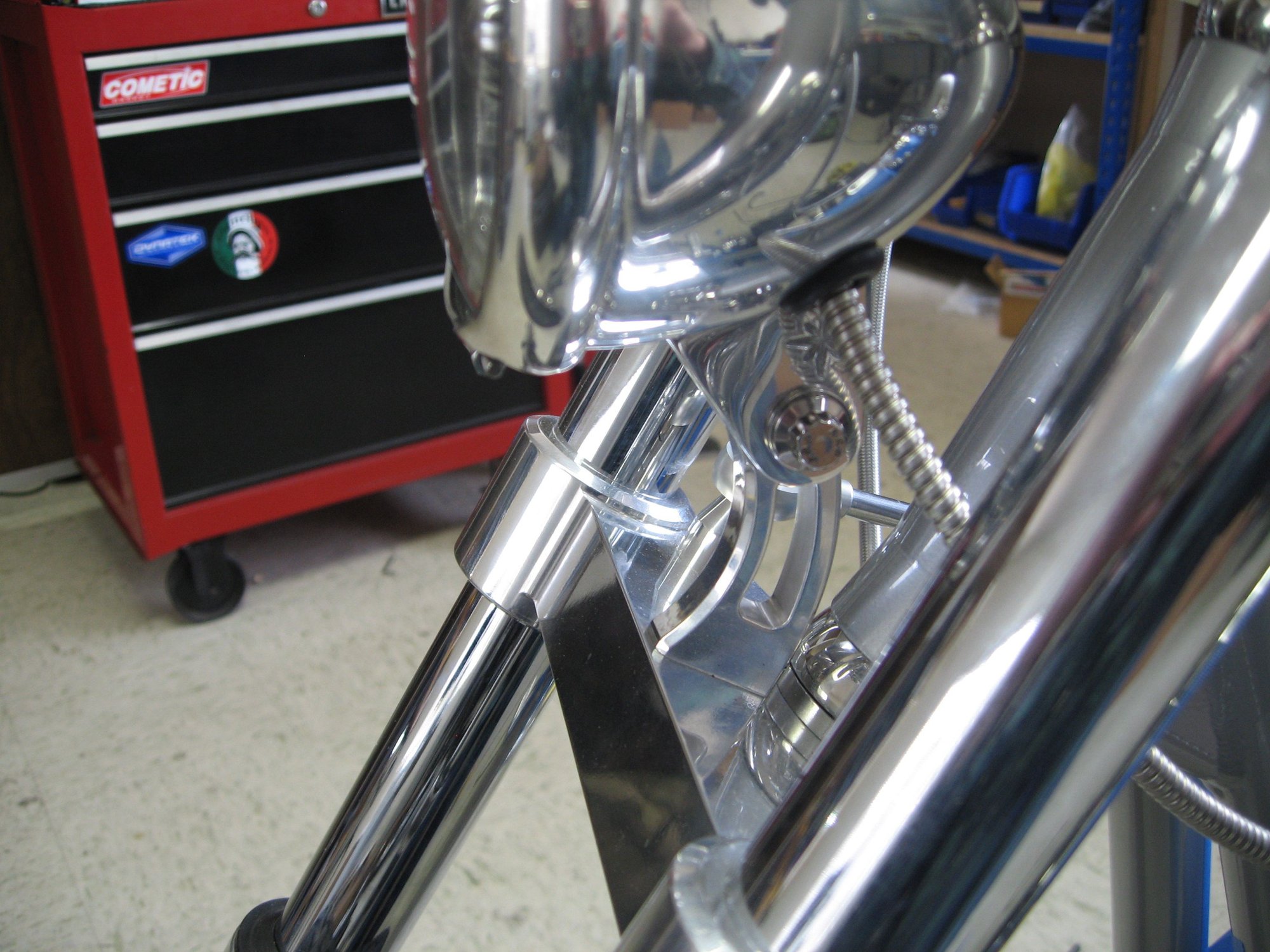

Made a mount to get the polished aluminum headlight bucket into the spot where I want it.
The wiring is exposed, and it all runs through stainless steel conduit. I drilled a hole in the bucket, and ran the conduit out the side.
The headlight bucket is made by Headwinds.
Installed an Ohlins steering damper. With the narrow front tire and the beast mill I am running, this mellows things out and minimizes getting "grabbed" by ruts.

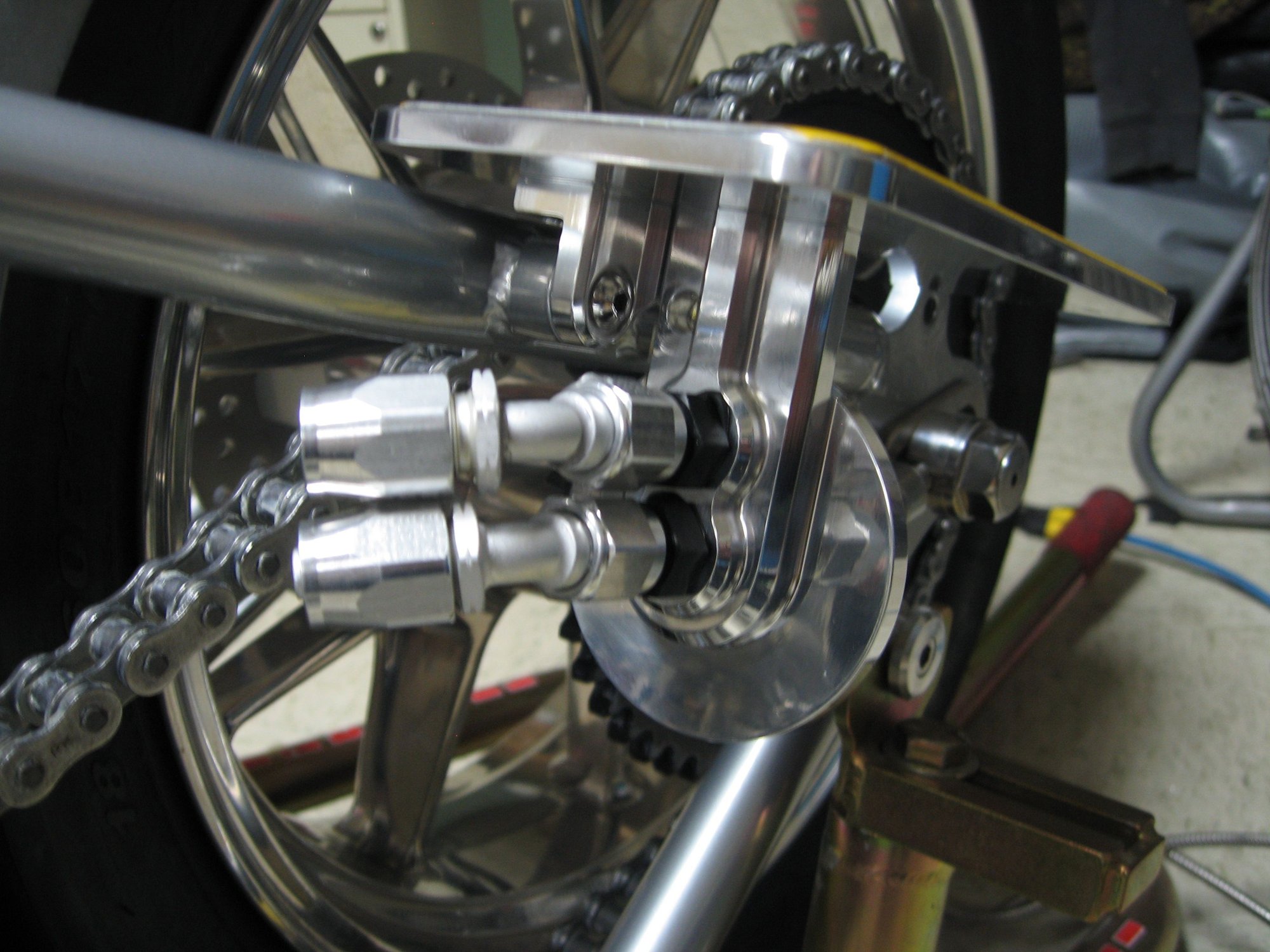

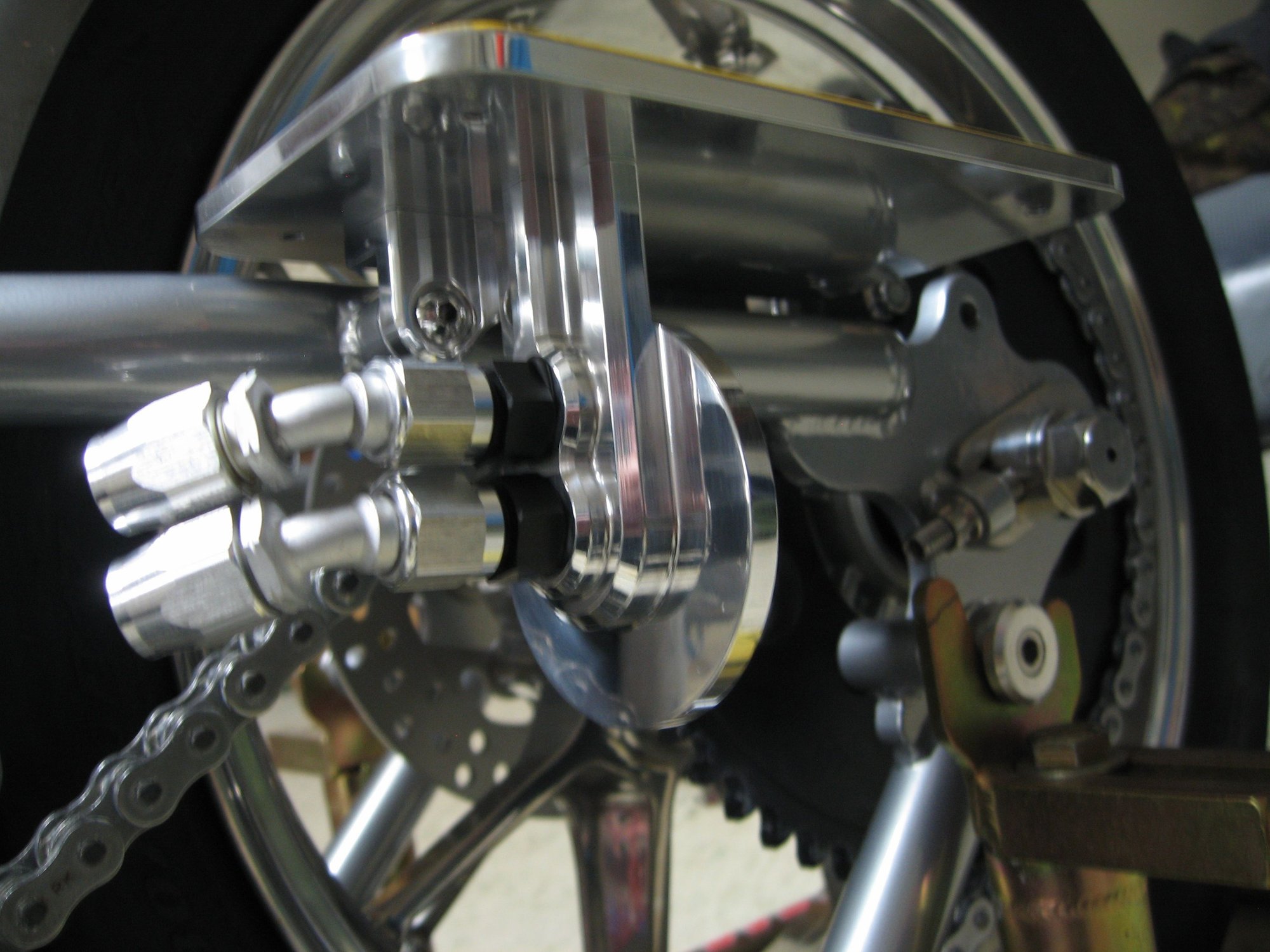

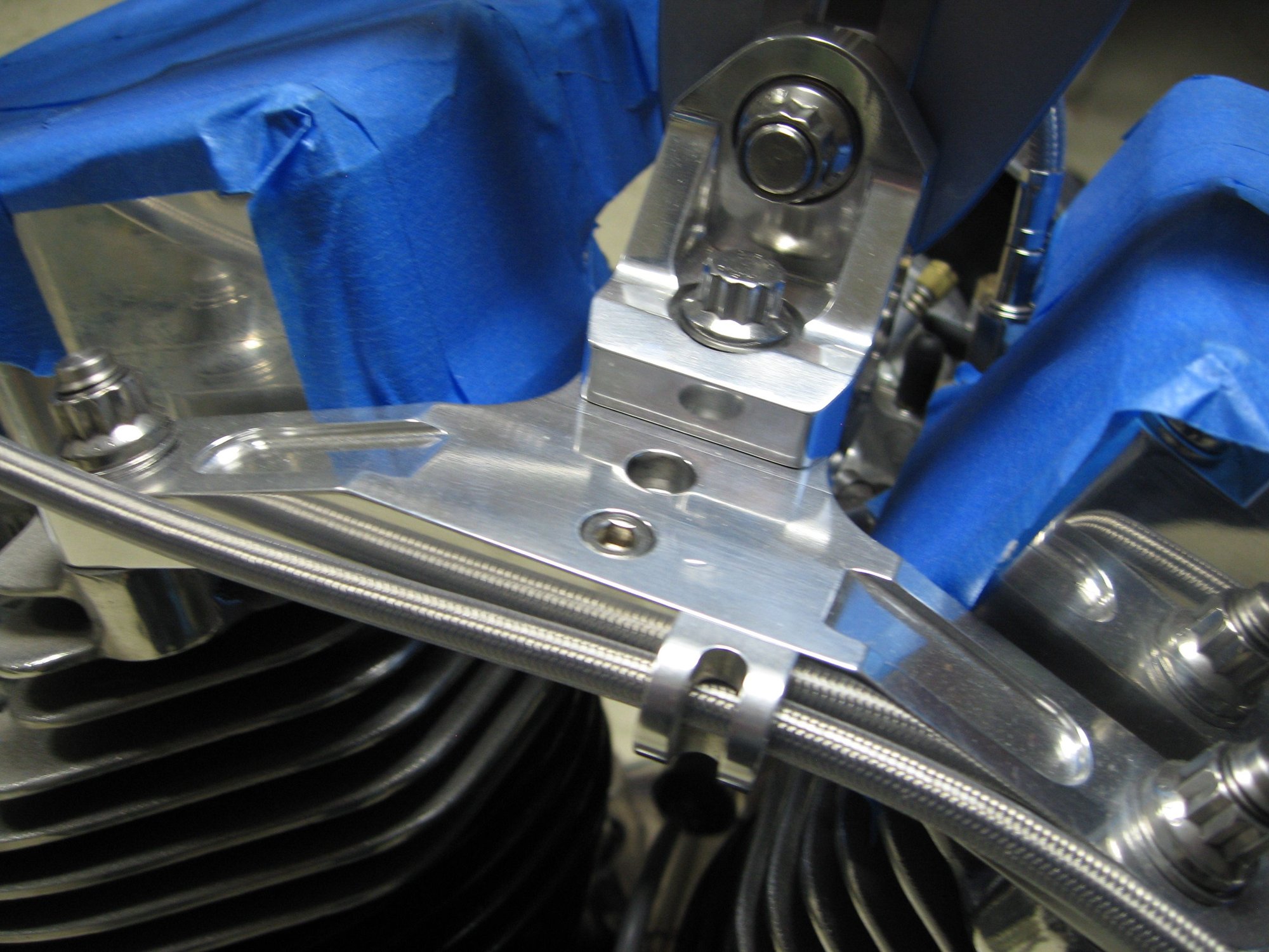

Top motor mount almost done. I made a coil bracket that goes with it. The clutch is hydro, so that is the line for that on the front.
Remote oil filter bracket and plate holder rolled into one. I didn't invent this concept, it's been done before.
It's really hard to truly be original when it comes to choppers. So much has been done before by great artists and craftsmen. We all get influenced, it's just our take or overall vision that makes them stand out. This bike just showcases the complication of it all. I like to see the machine and not hide things away.
