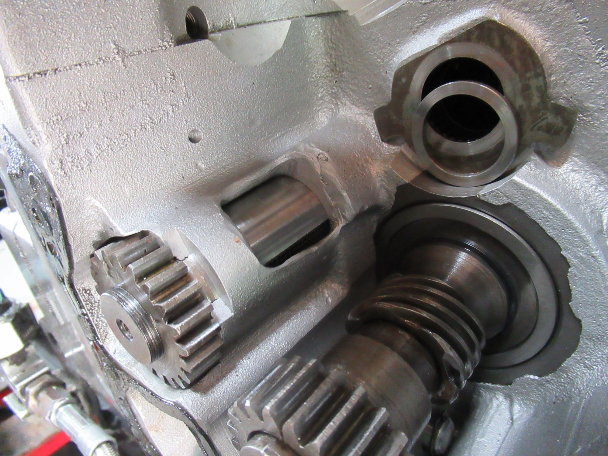

As Twizted said, pushrods rubbing and moving the tubes around can't be good for sealing, not to mention putting aluminum particles into the oil. I got new corks and o-rings but stopped installing them when I saw how bad this one rubs. I am going to inspect all the inner tubes and fix any tight spots too. Thanks to @johnjzjz for finding these impossible (for me) to find pushrods.
I've been thru this motor and it is pretty tight with a good breather opening. I also installed the PCV valve in the breather hose that John recommends.

Joe you'll find they were rubbing at the joint area where the top tube seats inside the lower, I have taken a dremel with drum wheel and cleaned up the insides of the the upper tubes to help this on machines with mixed together year parts, doesn't take much. I've also resorted to a little smear of hylomar on the rings and bottom corks to cure a few real problem children when it came to push rod tubes seeping. Some just don't want to play right no matter what you do.
Breather port does look good.

Nice job on opening and cleaning up the breather gear window
