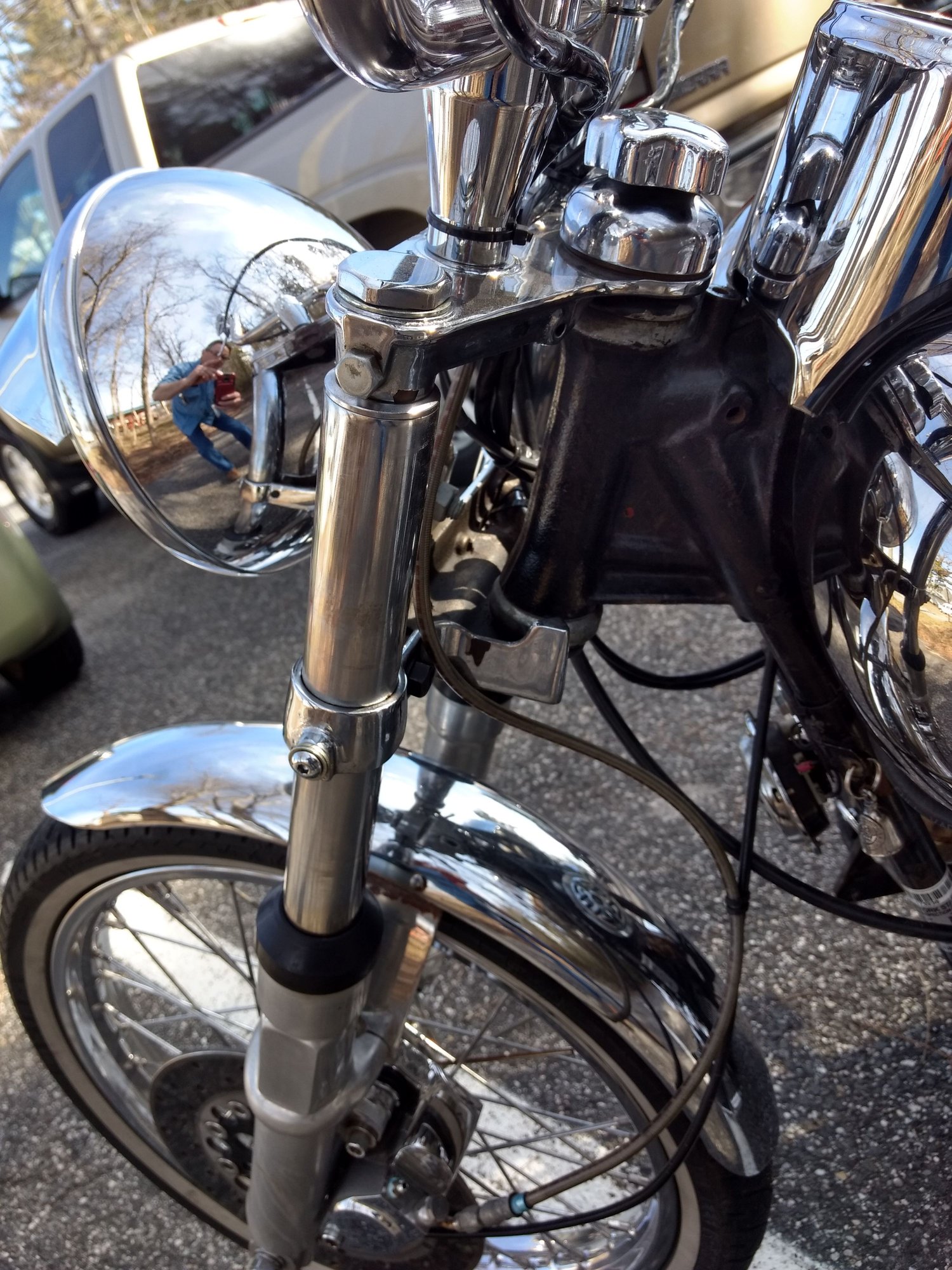

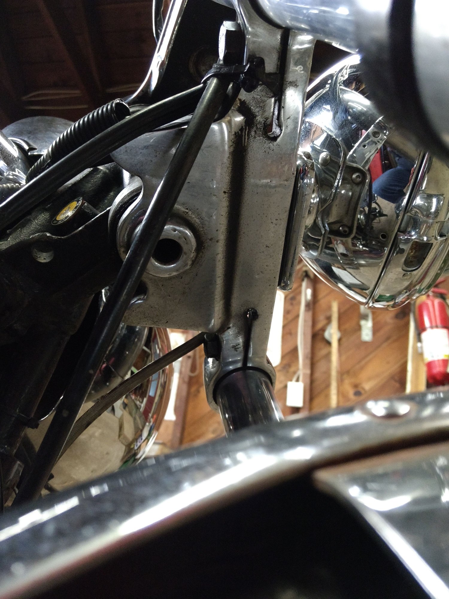

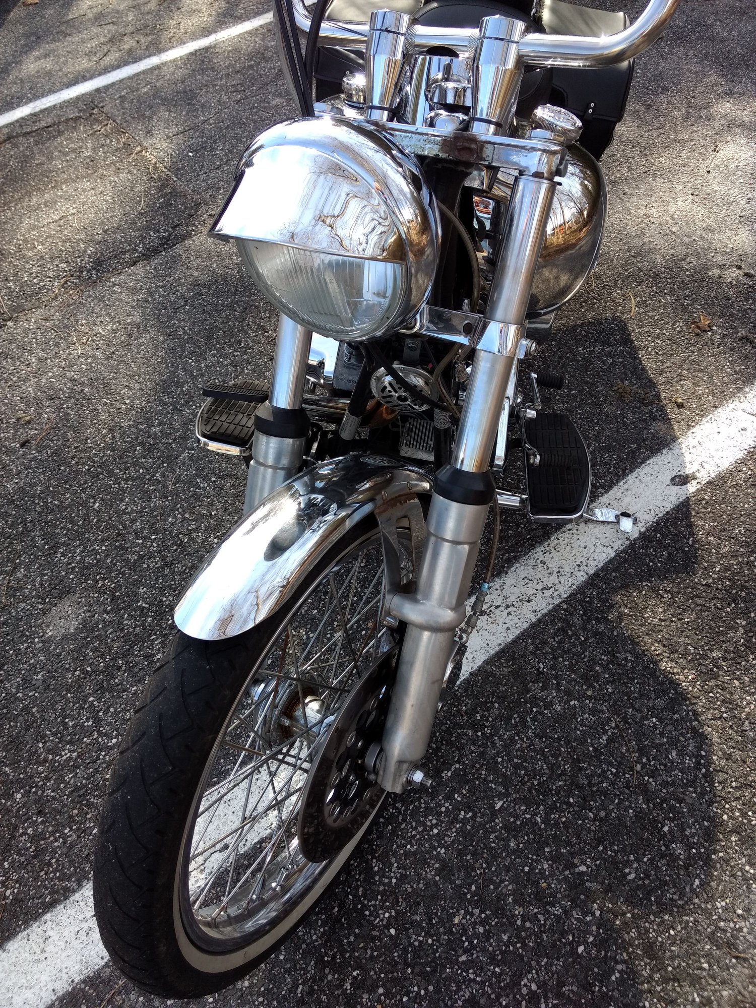

Well, here ya go.. took these just now and there's no mistaking it... Maybe this explains the mounts on the lower frame on the right side 3rd pic....

that is a pan type adjustable - they always come with the frame having a pin installed in the frame and the stay pieces all affixed to the bottom and facing to the rear of the bike
can you post a picture of the bottom of the lower tree just under the bearing location ??? don't know what they did

unless it has a system under the top tree I don't see what it does and how it actually might work the way it is
having said that I am in aware of a china add on that might do a squeeze somehow
