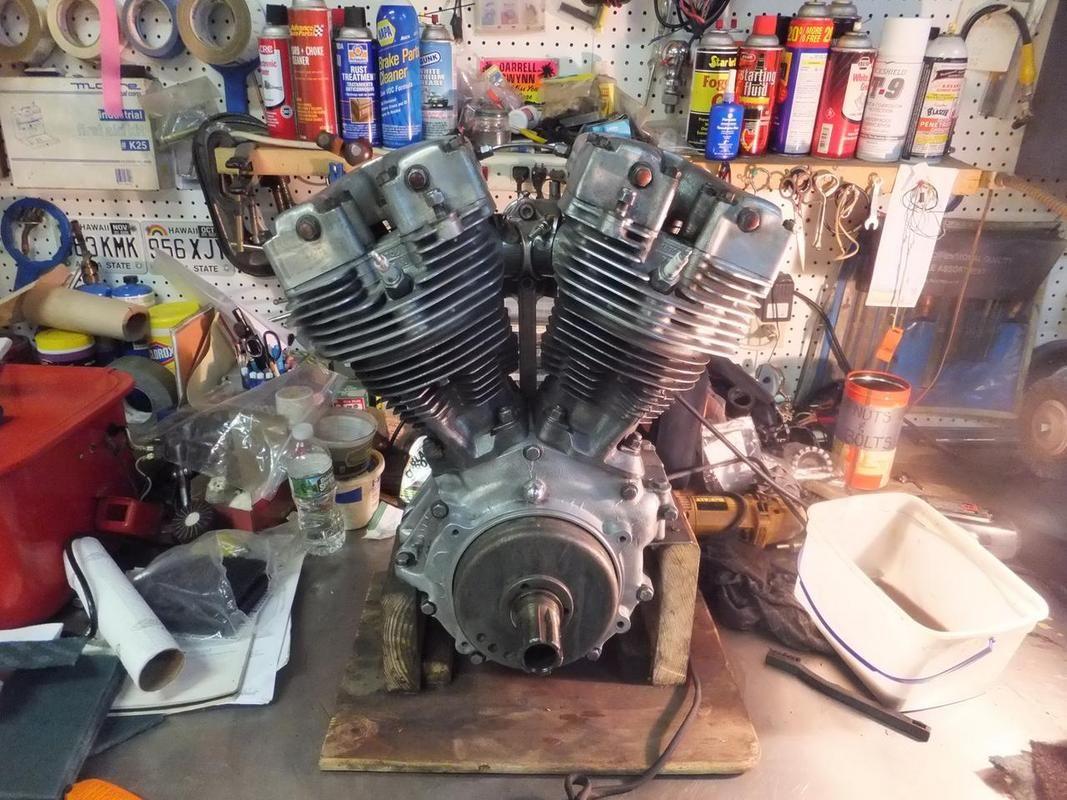

The transmission case on my Flathead had been painted black somewhere in it's life. Real thick crap, very industrial. It took some time but using Aircraft Paint Remover I got it all off. Spray it on, let it bubble, then light scrub with a soft wire brush. Repeat as needed to get it all off.
Could it be done in the frame? How much patience do you have? If you pull the motor I bet it wouldn't be too bad to do on an engine stand and save yourself pulling the entire motor apart.

by the time you strip the motor down enough to remove all the paint, you're five bolts away from pulling it. and you don't have to worry about accidentally getting paint stripper on your frame. motor stands are easy to make:
