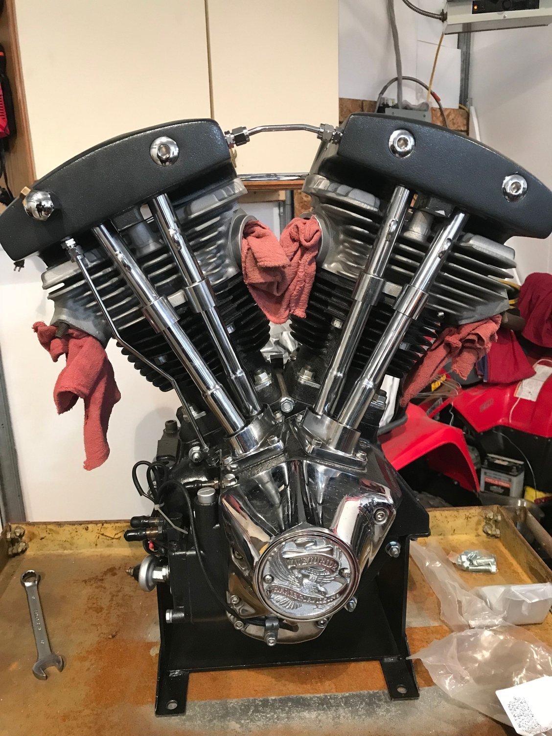

Uh...I don't want to stir up any bad news here but it looks like the arrow on that piston is pointing toward the rear of the engine.
All the pistons I have installed are supposed to have the arrow pointing toward the front of the engine/bike.
Man, I hope I am not seeing this correctly.
