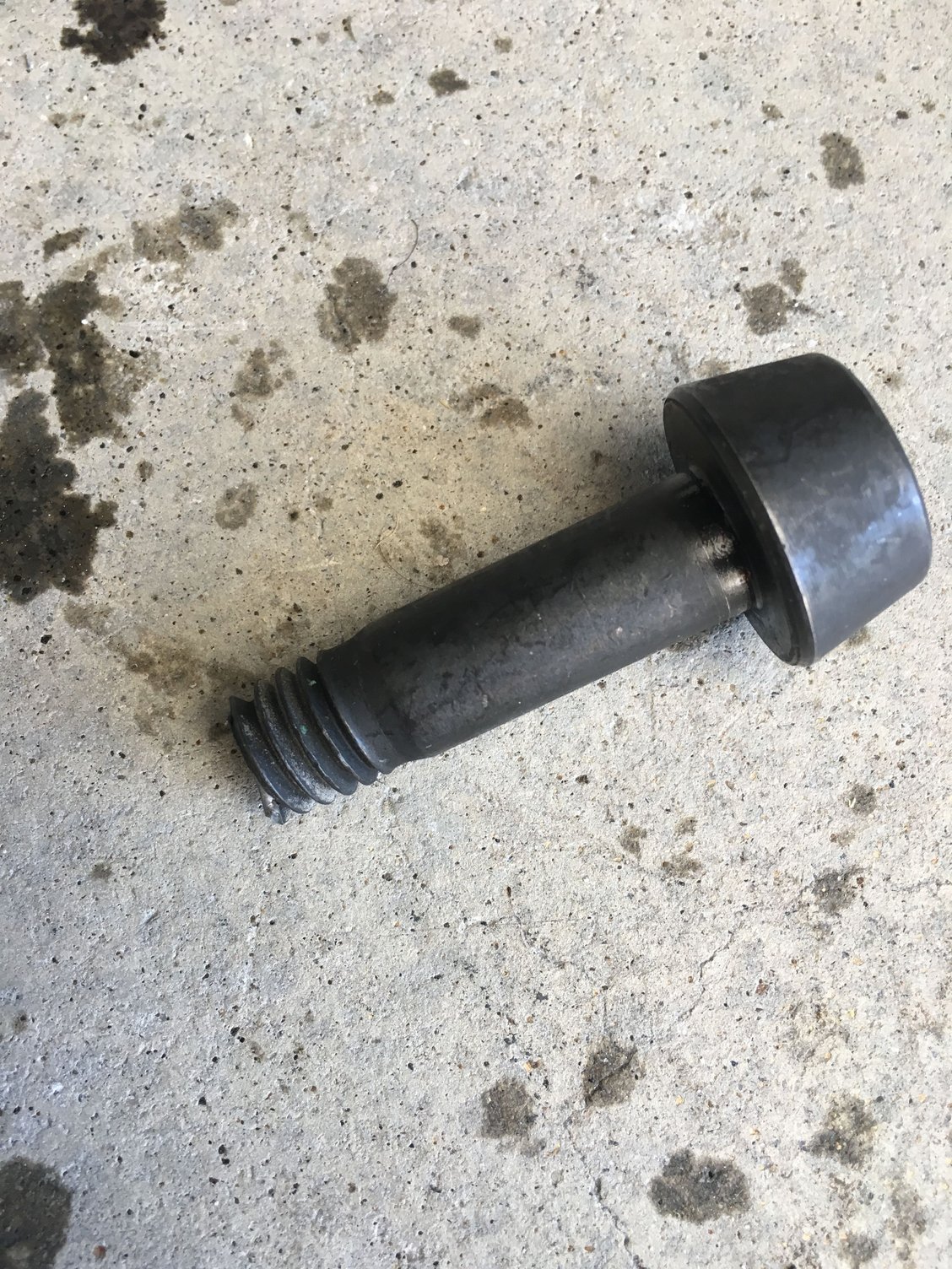

What am I?

Originally Posted by Rick's Ultra
What am I?
Brake caliper mounting bolt I suspect.
