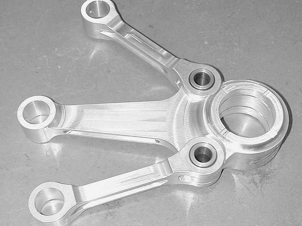

It mentions not knowing how the rods are connected to the crank but Im betting its a master rod setup like a radial engine. Can't see any other way to make it work and that would change the firing pulses and with 3 evenly spaced rods it would be smoother.

if I remember its 3 front rods and the ratio on the rockers was manipulated the third cylinder is at 1/ 2 its performance but it is 50 years ago the last time I seen one
Some variation of this...
