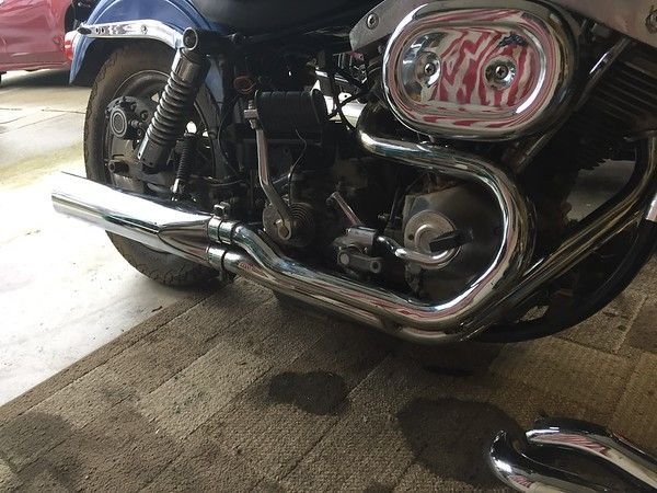

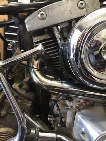

Before I ever put it up on my stand I realized I was definitely going to have to find an OEM exhaust system for it. Biggest issue (and it has been discussed amongst us before) was finding one because as mentioned one of the first things to go on a newly purchased FXE was the exhaust set up because they were restrictive and considered ugly.
Was checking in on another forum and a member there suggested a Facbook group "Old Iron Harleys 1933-1985 (No Evos)". Found them ,asked if I could join, got accepted and started looking through the "4 Sale" section. Found a guy out of New York that had a set for a Sporty and three sets for for the FXE models.
About a month later (and several bucks lighter in the pocketbook) they arrived. Overall and considering their age I was pleased, very pleased actually. The support tube needed came with the bike but I had to go through my stash of bolts to get the proper ones (Shovel bolts have distinct markings). Spent several hours cleaning the exhaust and muffler components, went to the stash for the clamps and mounted the unit for fitment. Fit perfectly.
The two pieces in the lower corner of the last pic are the heat shields (front #65608-80 and rear #65609-80). Officially they were not an available part for 78 models but they are going on anyway.
The other good thing about the muffler is that it was never puched out so it will retain the original sound (good or bad as that is).

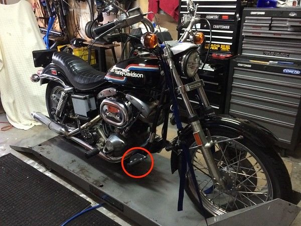

Just a quick posting for today.

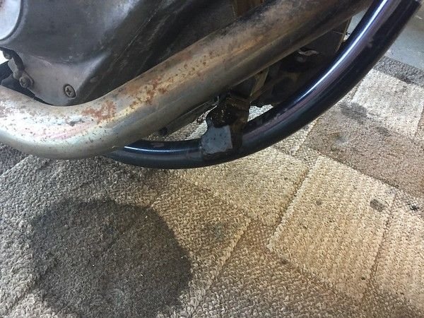

I brought this up on another thread on someone else's post in the Shovel section. One of the first things I noticed on my 78 FXE was the absence of a tab on the right hand side of the frame that would allow me to use foward controls/footpeg mounts.
The frame tabs was still used on 1975 FX/E models.
At first I figured the prior owner had cut the tab off. Called Wasco Frame Service up out of Tacoma Washington. Guy has been around like forever and he has done some excellent repairs on a couple of frames belonging to friend of mine. his statement to me was that for 1977 and 1978 HD at the factory cut the tab off of FXE models. He described the way it was cut perfectly...like some one took a cut off rotary blade, took off the tab and then had the frame painted.
Guess that is one way to make sure you don't try turning an entry level big twin into either a higher priced FXS or FLH.
And to add some suport to the idea I did find (a few months later) some pics on a Craigslist add for a 1977 FXE that had no tab and according to the seller, had a dealer installed footrest mount attached. Never contacted the seller but figured I would throw in the pic.

racepres, actually I am referring to the double hole tab utilized for the "Highway Footrest".
1975 FXE models clearly still have the tabs
It is lacking on my 1978-1/2 FXE
It is also missing in the green 1977 FXE I posted a pic of.
And while clearly not definitvie the Parts Manual only shows the "Highway Footrests" available for 77+ FXS, FXS-80, FXB,and FXSB models. So somewhere along the way the tab was taken off for at least a couple years I believe.
