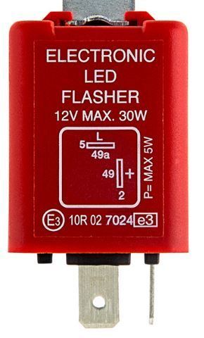

get this one been using them for years
https://www.ebay.com/itm/2X-CF14-Car...53.m1438.l2649

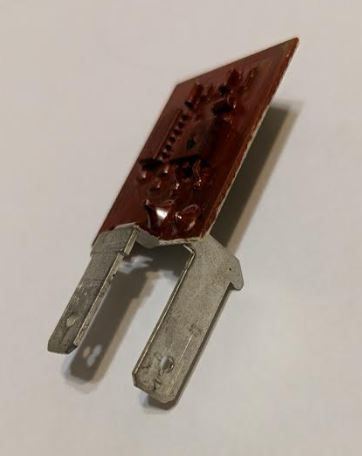

Pulled the cover and there is a small printed circuit board. Not likely to withstand the Harley electrical system without some protection.

My system uses a two pin, I'll look for the equivalent of the 3 pin one you've been using.
The third pin is just an additional ground.
