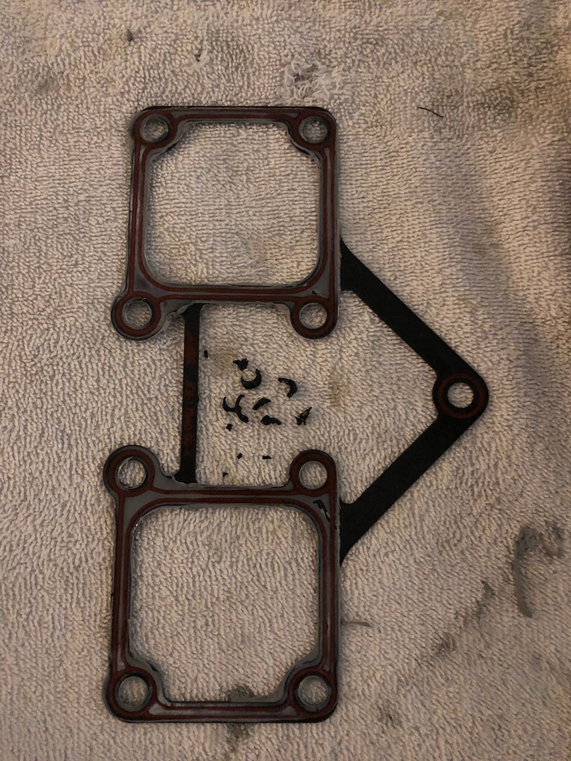

well i pulled the rocker box off and found some pieces of black rtv in the oil passages in the rockershafts and rocker box.... im assuming this did not help me what so ever...

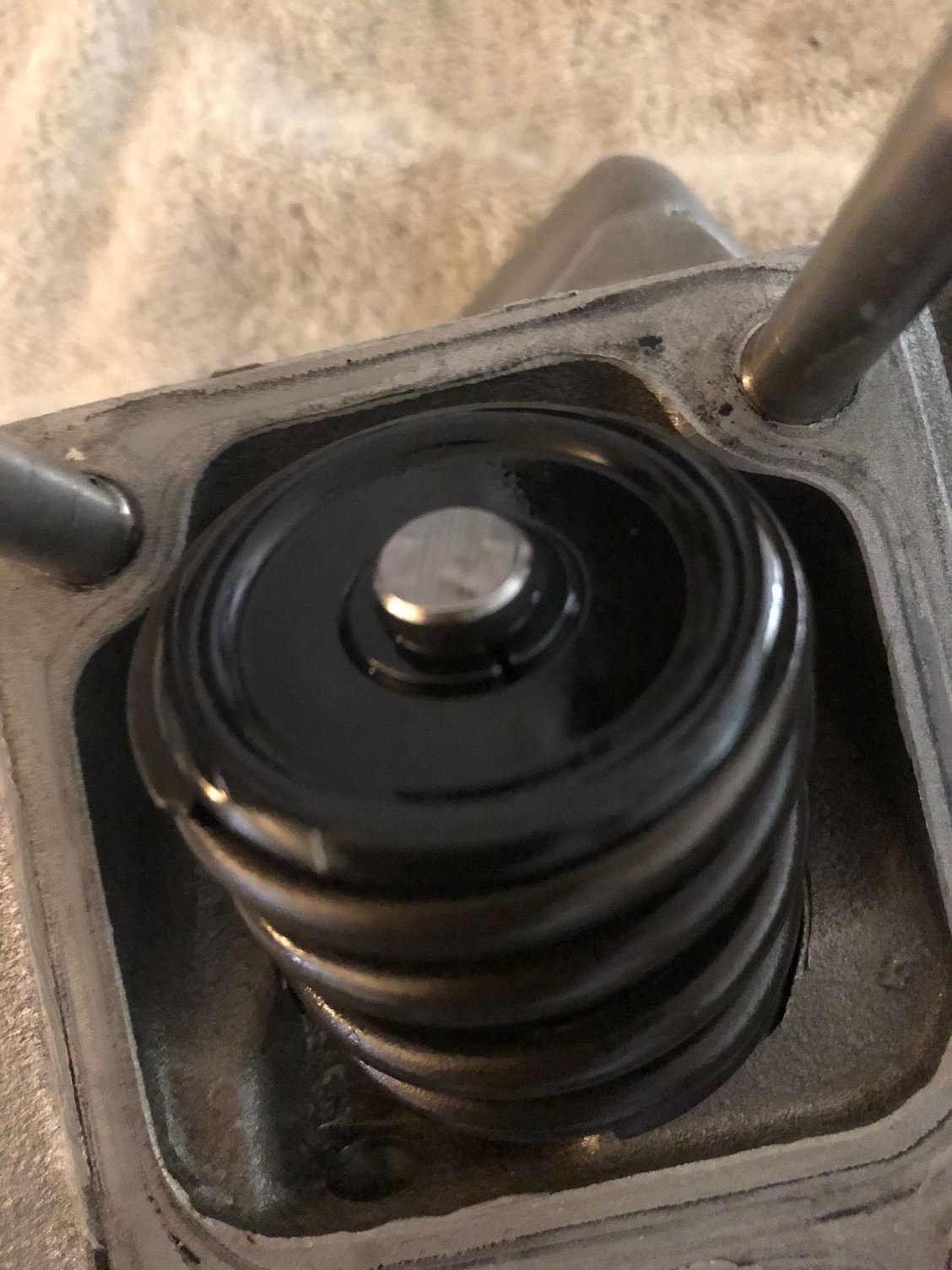

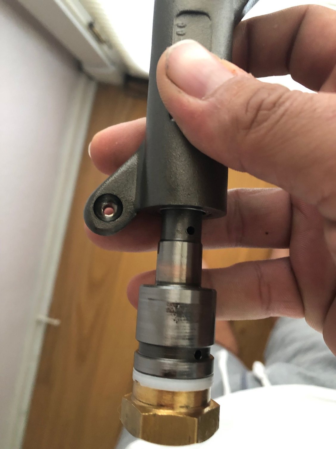

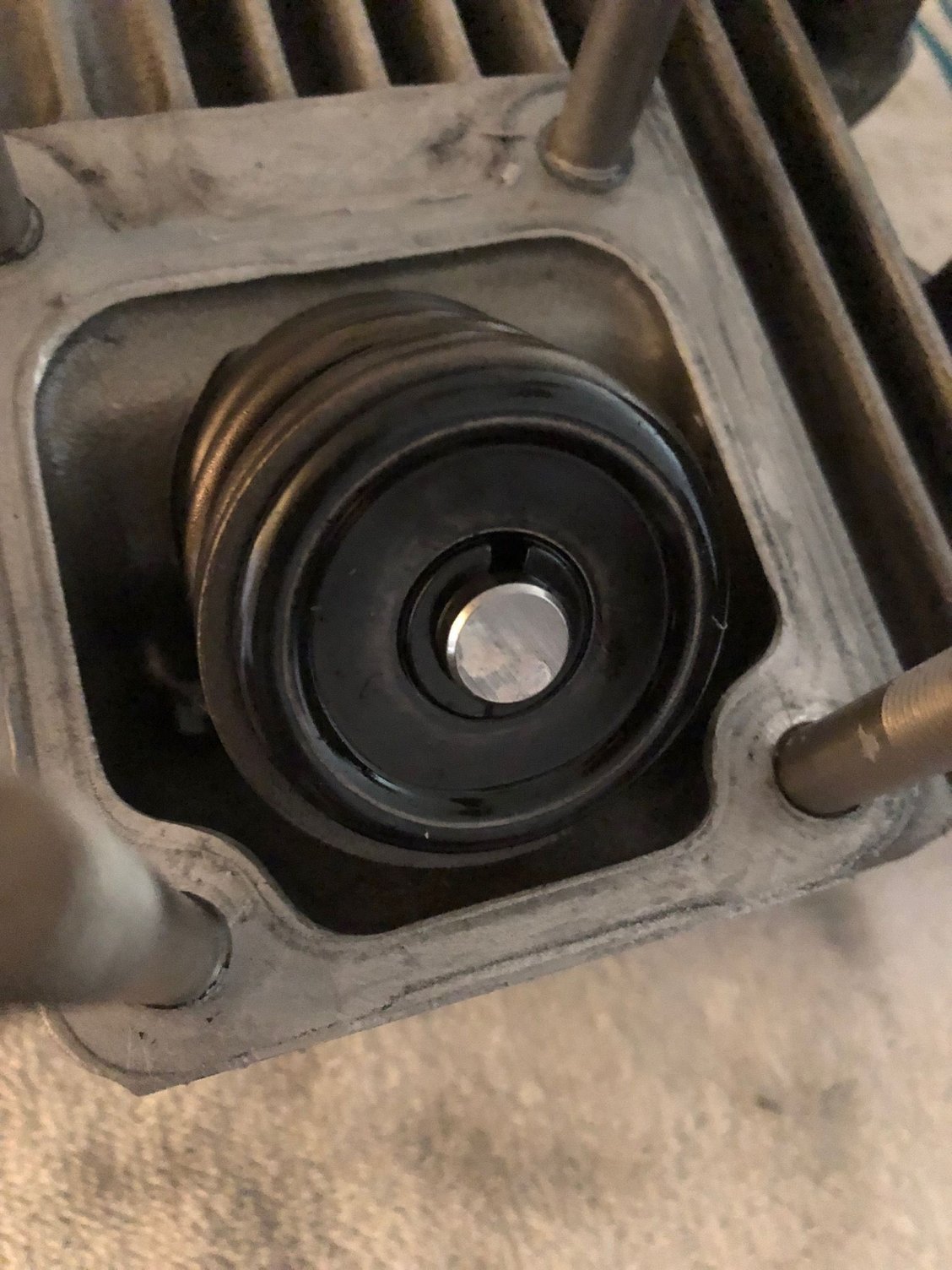

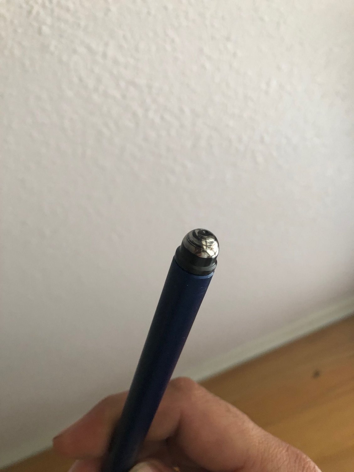

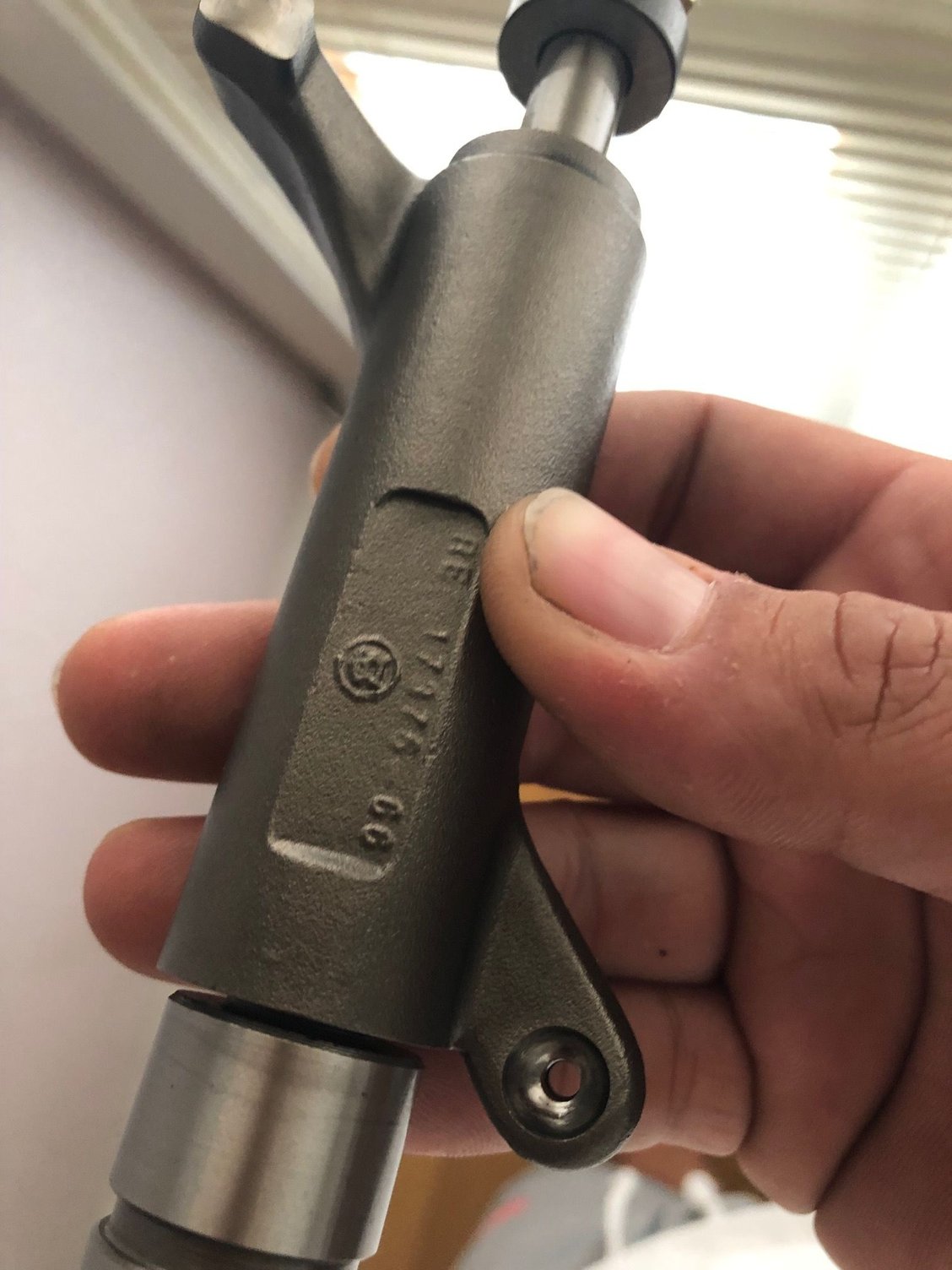

they have some play the engine is 10 years old and some scoring inside the brass bushings also there was alot of the rtv scattered in the box and in the arms and shafts

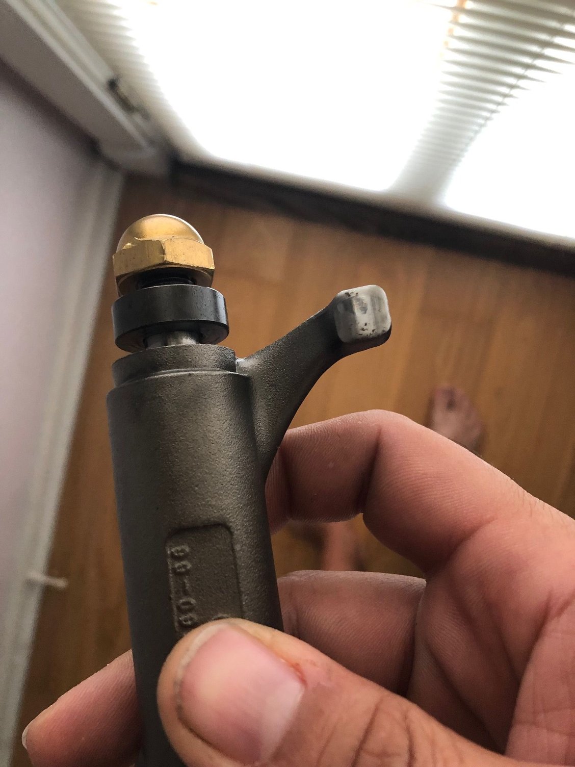

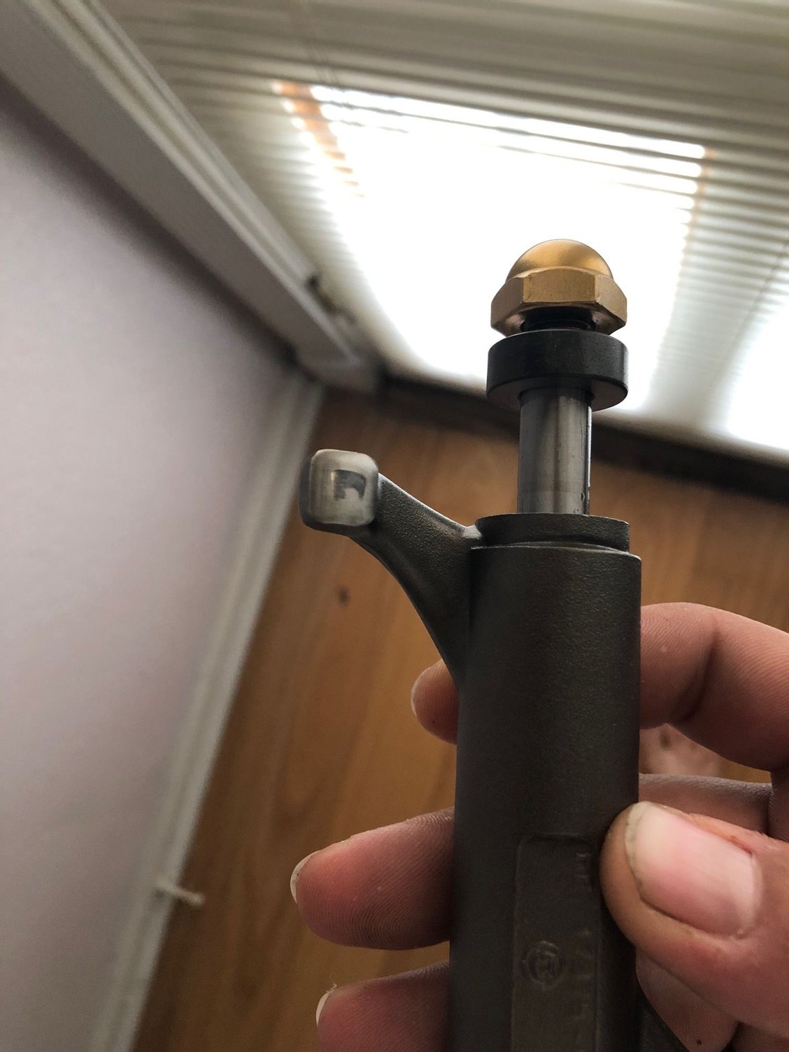

im thinking they may have got hot from no oil getting to them and getting loud the intake has less play ill post up some pics

the pieces of rtv theres more of it just scattered i tried to get the best pics i could of the wear marks and stuff lmk guys

typical wear nothing stands out as being lean in oil supply
install the shaft in the correct location and clean and dry see how much wiggle it has - new installs have zero - 25 ,000 miles its a slight rocking in the spring end mostly but both sides well be a bit loose
