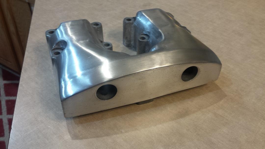

I should rename this thread 'top end rebuild'.
So my valve guides got delivered to the wrong address, thank you USPS. It's a frequent mistake in my neck of the woods. While I'm waiting i decided to start cleaning up the rocker boxes. What a difference a little elbow grease and some sandpaper makes. There's still a little pitting visible. We'll see if some buffing compound can take care of that
