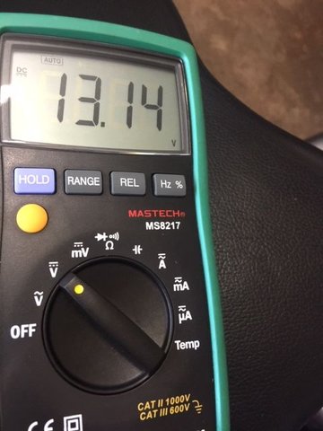

My battery reads between 12.8 and 13.2 on a digital depending on whether I take the reading right after I take it off the tender or if it's been off the tender.
Here is my reading today after I had it on a tender.
The last time I tested the regulator, it read 14.3v......idk but it seems to jumps around if you don't hold the throttle steady.
