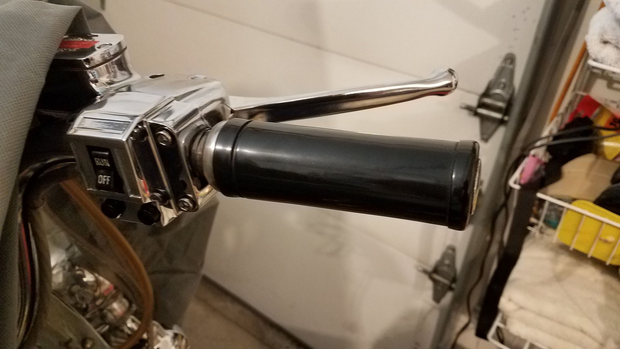

Likes: 33
I have a '79 with a Super E. I have been running it for about 15 years. This winter I bought a universal throttle from JP and then ordered a universal twin cable setup from Venhill. After a few hours of experimenting, it went on and looks a works really well. I wish I had done it years ago. It is nice a smooth and looks good. After dealing with this stuff for lots of years, you are really only limited by your imagination and the depth of you pocket. KW
Did you need to replace the bars to accept the twin cable grip? With the design of the old spiral, the 1" handlebars are not 1" under the spiral grip. Is there an adapter piece?

Likes: 33
Mine has aftermarket bars. I didn't have to deal with the internal throttle. I have changed them in the past though. It isn't that hard to remove the mechanism. It just takes a little time and patience. Ken
