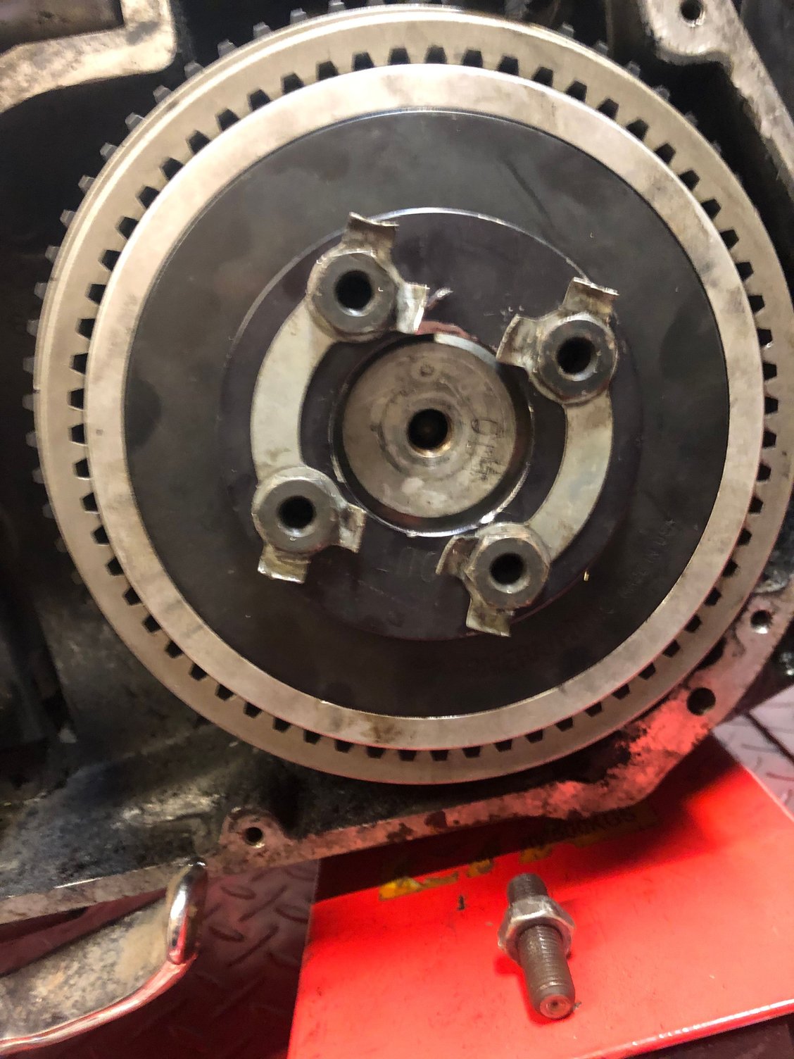

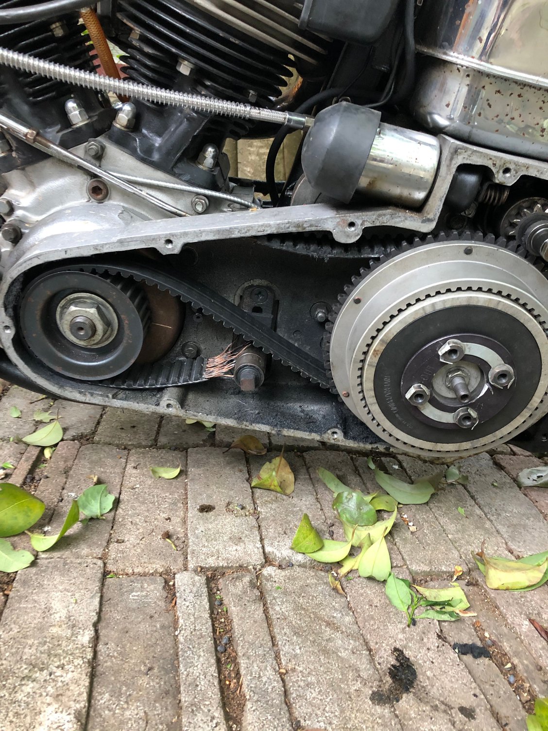

My primary belt broke (luckily in my driveway) and I need to remove the clutch to get the new belt on. It’s a primo.
so basically how do I remove it? It is different than the clutch in my service book. I’m having a real brain fart on this.
cant I just back off the 4 bolts or is there too much pressure ?

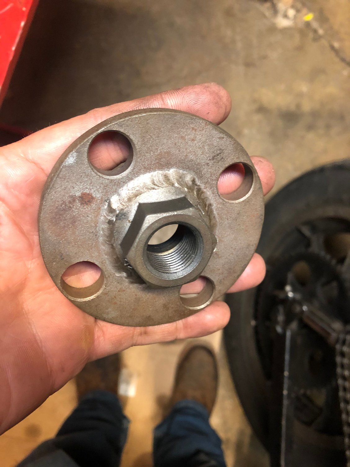

I have this puller given to me by the guy I bought the bike from

empty the clutch drum of discs and steels taking note of how they came out - then the tool uses the special nuts you have and a bolt he did not give to pull the hub and drum off together

Do not know anything about your clutch; however, this website may help and has downloadable guides for that clutch.
https://riveraprimo.us/pages/installation-guides
See attached PDF. Hopefully it will help there may be others at the provided website.

ok thanks
I think I got it
that link was very helpful, I started to back out the 4 bolts and the pressure plate kept coming out and keeping tension on the bolts and I got alitle nervous about backing them all the way out, but looks like I can just back them all the way
I ordered a new belt and should have it later this week

replace the idler bearing while you are in there
order two belts, murphy says as long as you have a spare with you on you on the road, you will never need it.
