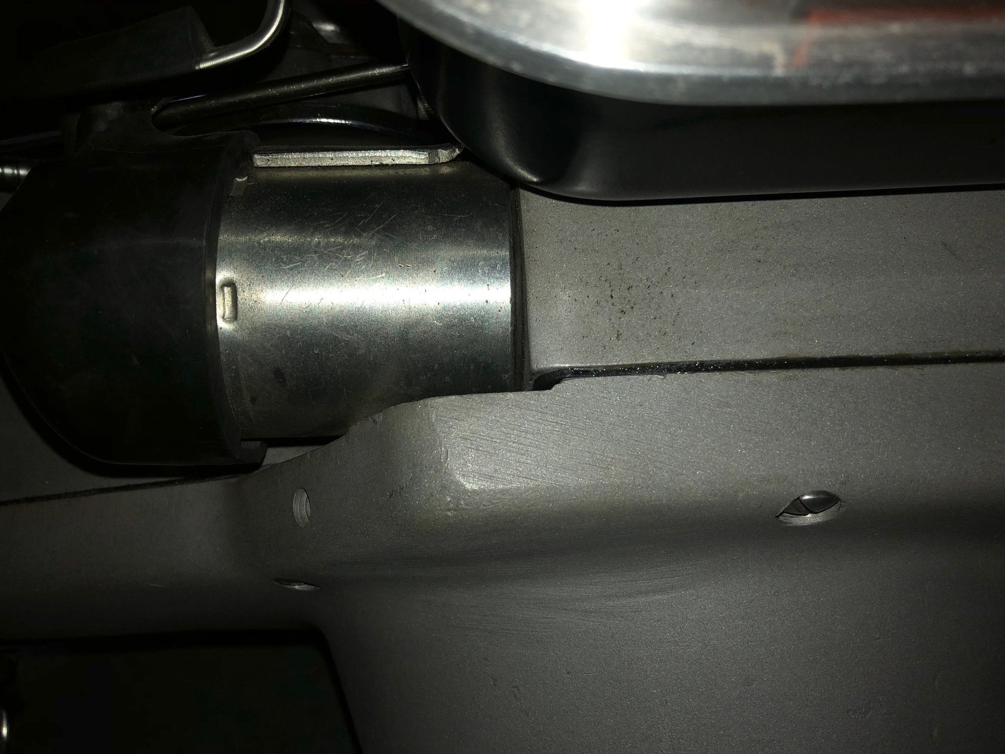

You put it on the solenoid then put the solenoid in the primary, the lip acts as a gasket that gets sandwiched like the foam seal would.

Mine

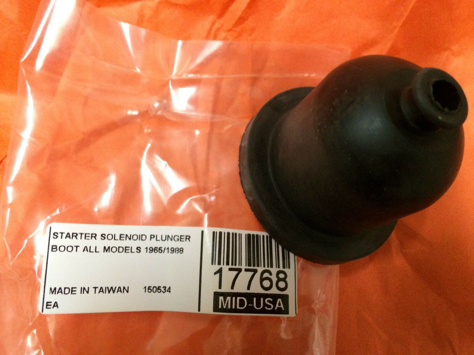

2 types of the same thing are or were available - one with out the shoulder and one with the shoulder paul pictured

Is this the type you guys are referring to as being sandwiched or is it a different style than the one pictured? It is not my pic, I used a picture from eBay, but that is the style on my bike.

Thats the one I have.
