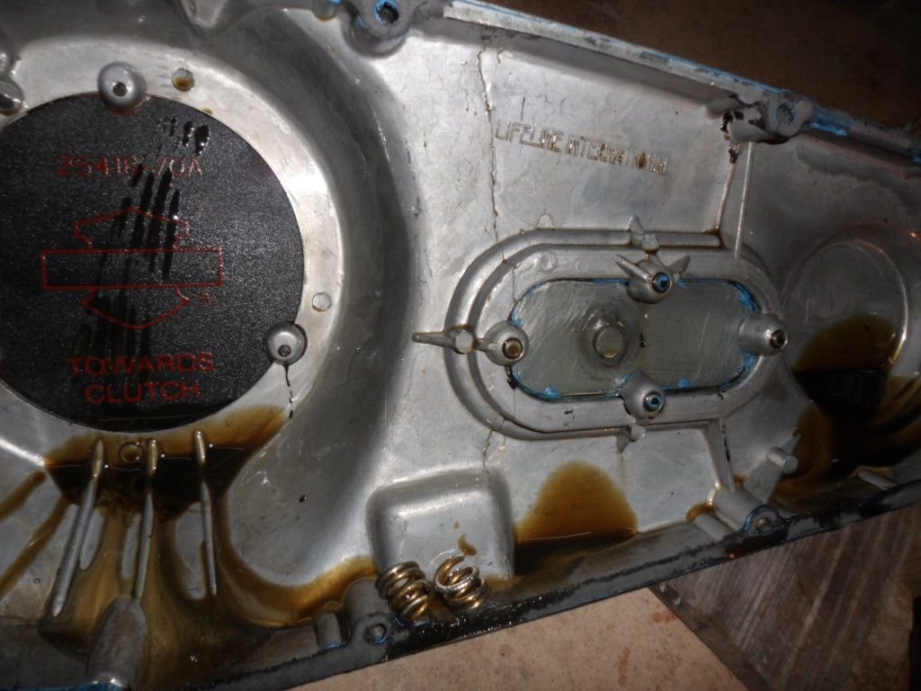

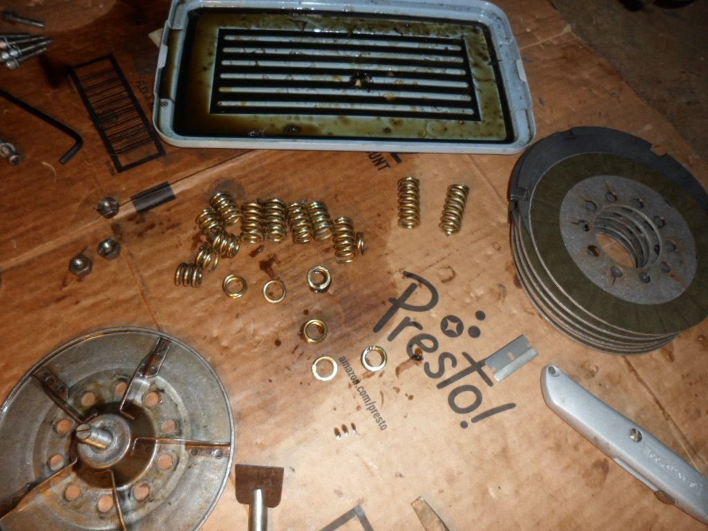

Well I answered my own question... when the cover came off there were parts of 2 clutch springs in the bottom
When I got the pressure plate off and apart only 2 springs were intact but were distorted
I cleaned the friction discs in gas they look like they have been barely used seem to be a green color. I rubbed a couple them down on a flat concrete surface but they really didn't change the appearance much at all The steel plates also looked fairly new they do not have ball and springs on edge. I check for flatness on a mirror and 2 of them had a single area where I could get a .006 feeler blade under it. That doesn't seem like a problem to me, or is it?. Looking at the pressure plate above, I found one of the gussets has the 2 spot welds detached where it meets the center section, if that's a big deal I can weld it but it looks like it may never have been attached
The picture above shows there are no safety wires on the 2 bolts. Is that something I need to correct?

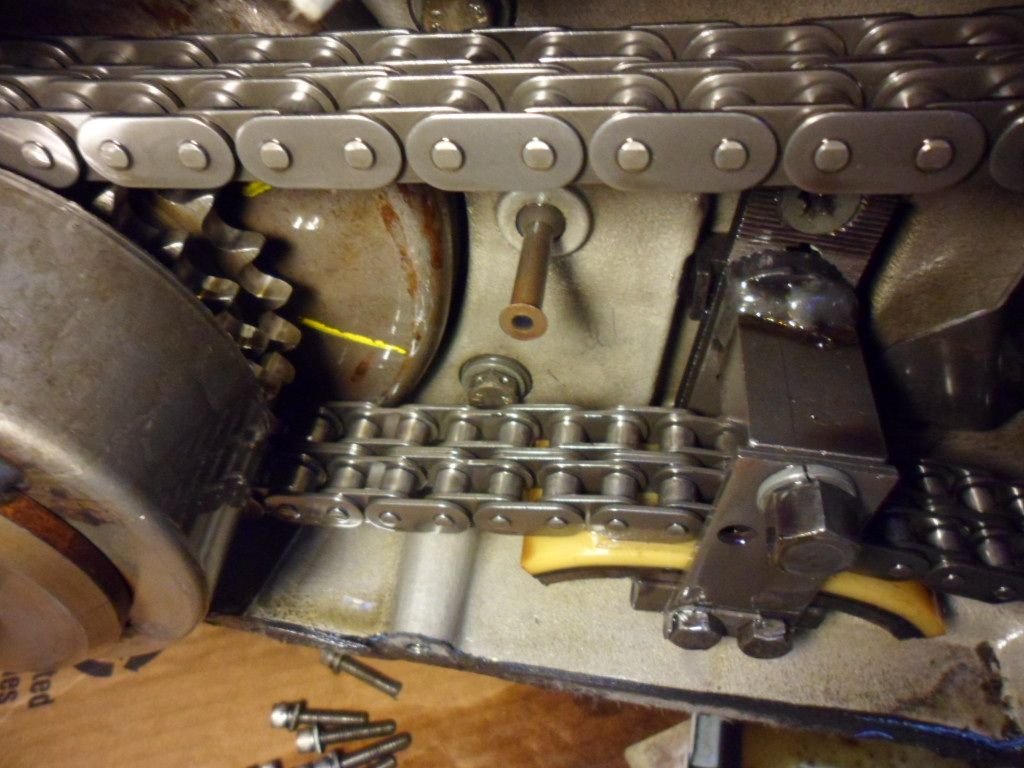

Also that primary chain oiler pipe, I was thinking of drilling through it to vent the primary space as everything is plugged, the issue is to vent or no as it is set up as sealed.
So are there any opinions what would have caused these springs to break, cheap chinese stuff or some other issue? Any recommendations for a replacement set?

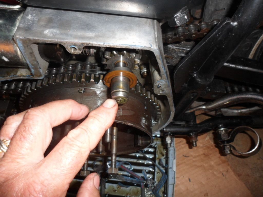

I also noticed on that the shaft from the starter (that has the thrust washer on it) there is a bushing that had a loose left hand nut on it. My manual call that a pinion shaft nut but doesn't show a separate nut
