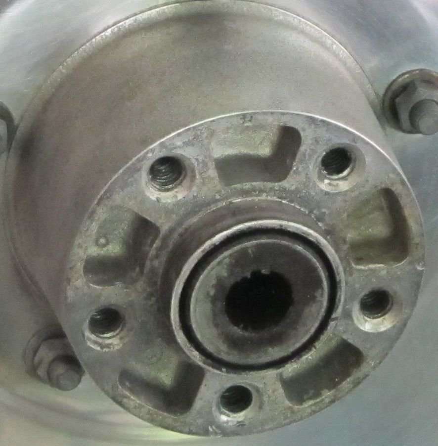

Hello
I have a Harley Davidson Spun Aluminum Disc wheel part # 41057-83 & its missing the axle spacers that are on the out side of the rim casting, dose any one know the part #'s for these spacers ? here are a few pictures of the wheels that i have, the picture of the wheel on the right shows the wheel with the spacers, the one on the left is missing the spacers . . .any help in finding the part #'s would be very welcomed, thanks.

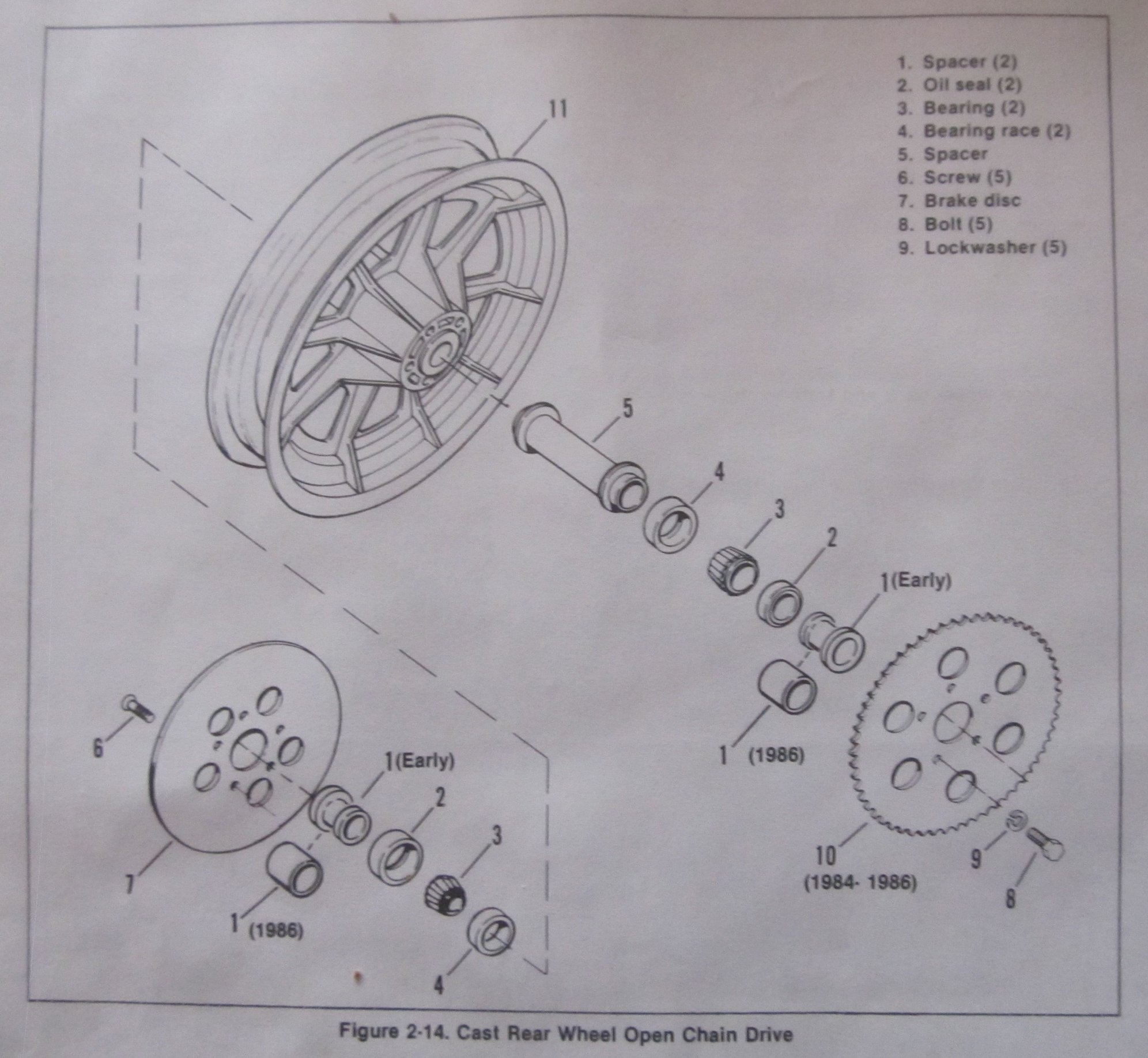

Hello
I found this in my 84-88 FXR service manual. . .the diagram shows the spacers i am looking for, any one got these part #'s ?
I need the part #'s for the bearing spacers item 1(early) , thanks for any help ! could probably use the oil seal item (2) also . . . .
Old Oct 3, 2020 | 02:25 AM
panz4ever's Avatar
panz4ever
Joined: Oct 2005
Posts: 7,488
Likes: 3,687
Looking at an 87 parts manual I am showing that spacer being used for spoked, cast and solid rear wheels. Looks to me like it is #40906-82A and requires two, one on each side.
