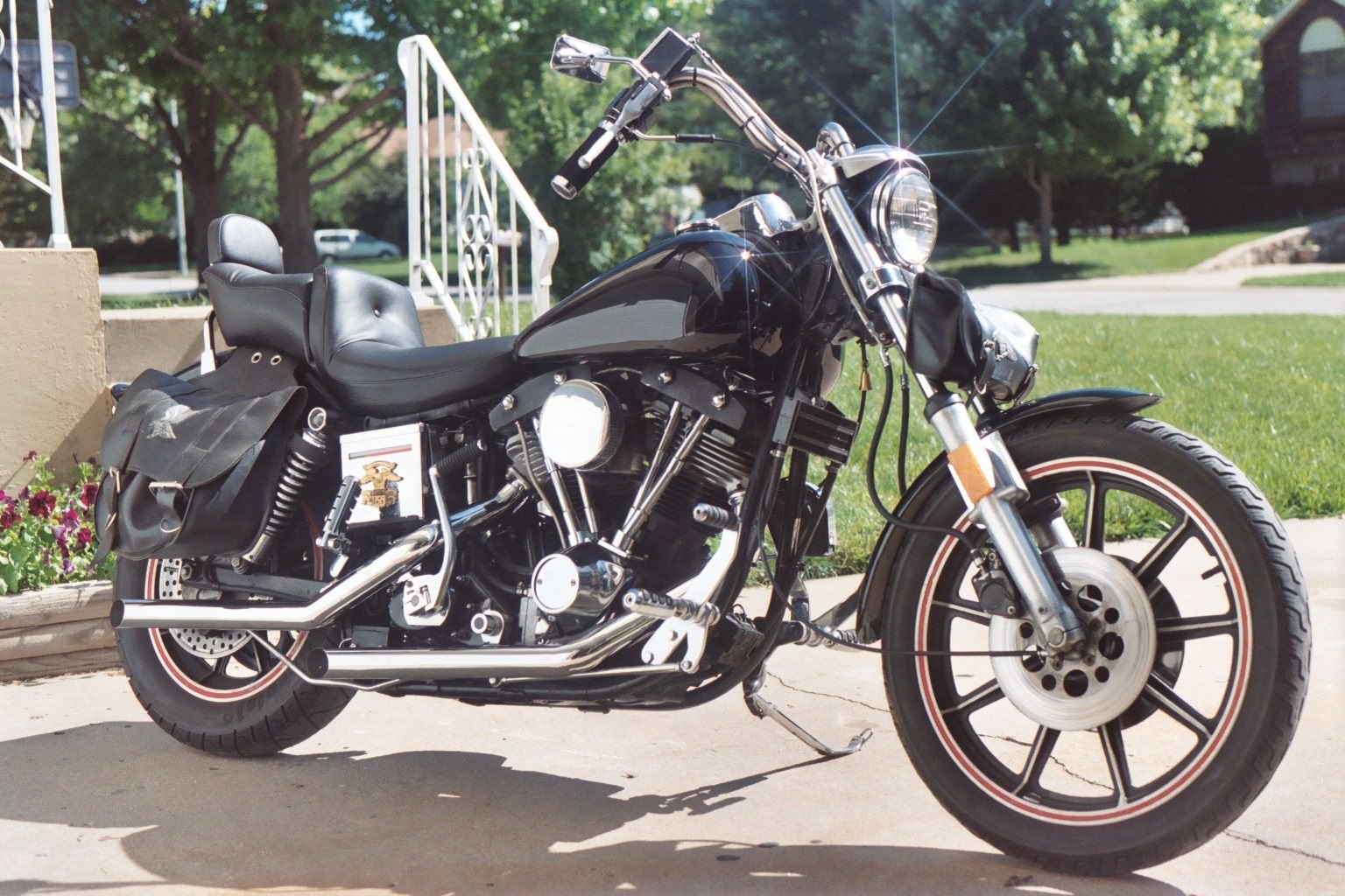

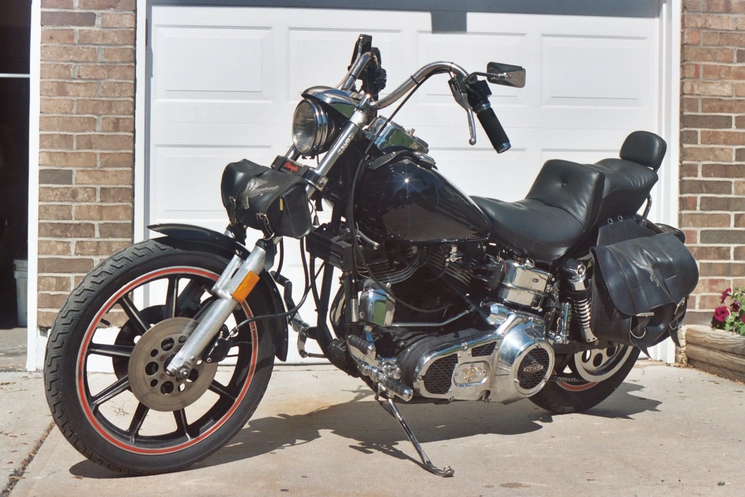

Here are pictures. I believe, if I understand the manual, that I have the correct amount of free play in the clutch, if that's the time you start to feel resistance when you pull in the lever?
I know it needs to be ridden, but I'm not that guy. Just getting my Sporty up the gravel driveway on a 6% grade is a challenge. Basically, I'm just trying to keep it going until I can find a buyer, since it just doesn't make good sense to ride a 38 year old bike that you don't know how to fix and it's getting harder to find people who work on them. My husband would just jump off and ba-dum-bing, fixed. Whoever noted that it's not stock is right, obviously you can see that forward controls and a bobtail fender are definitely not original Sturgis. I had to have a shop in Eureka Springs, AR (who just closed up and retired last month) fix the master cylinder since my husband died during the rebuild, he said it was pretty solid except for some minor electrical issues.

If yer gonna sell it anyway... leave it be.
If I was a buyer, I would probably prefer that.
Unless you were going to Completely bring it back Bone Stock..
Even at that, I doubt you could amortize the Cost..
Nice ride... someone is looking for that.

you have a turtle top trans and all the operating linkage is sloppy and worn out - look at the trans and shift it yea its moving all over the place

Maybe, tho I would suspect those forward controls first... My Cowpie [Turtle Top, Dairy Queen] works Just Fine.. But I maintain it..
