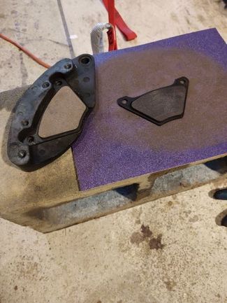

Also wanted to show what RacePress is always stressing to do while you have the pads out.
Here is a glazed over pad that has plenty of meat left. This is my front
Here is the pad after just a minute with 80 grit on a cinder block. This is my preferred method but you can achieve the same result several ways
This makes a huge difference in the performance of your brake pads

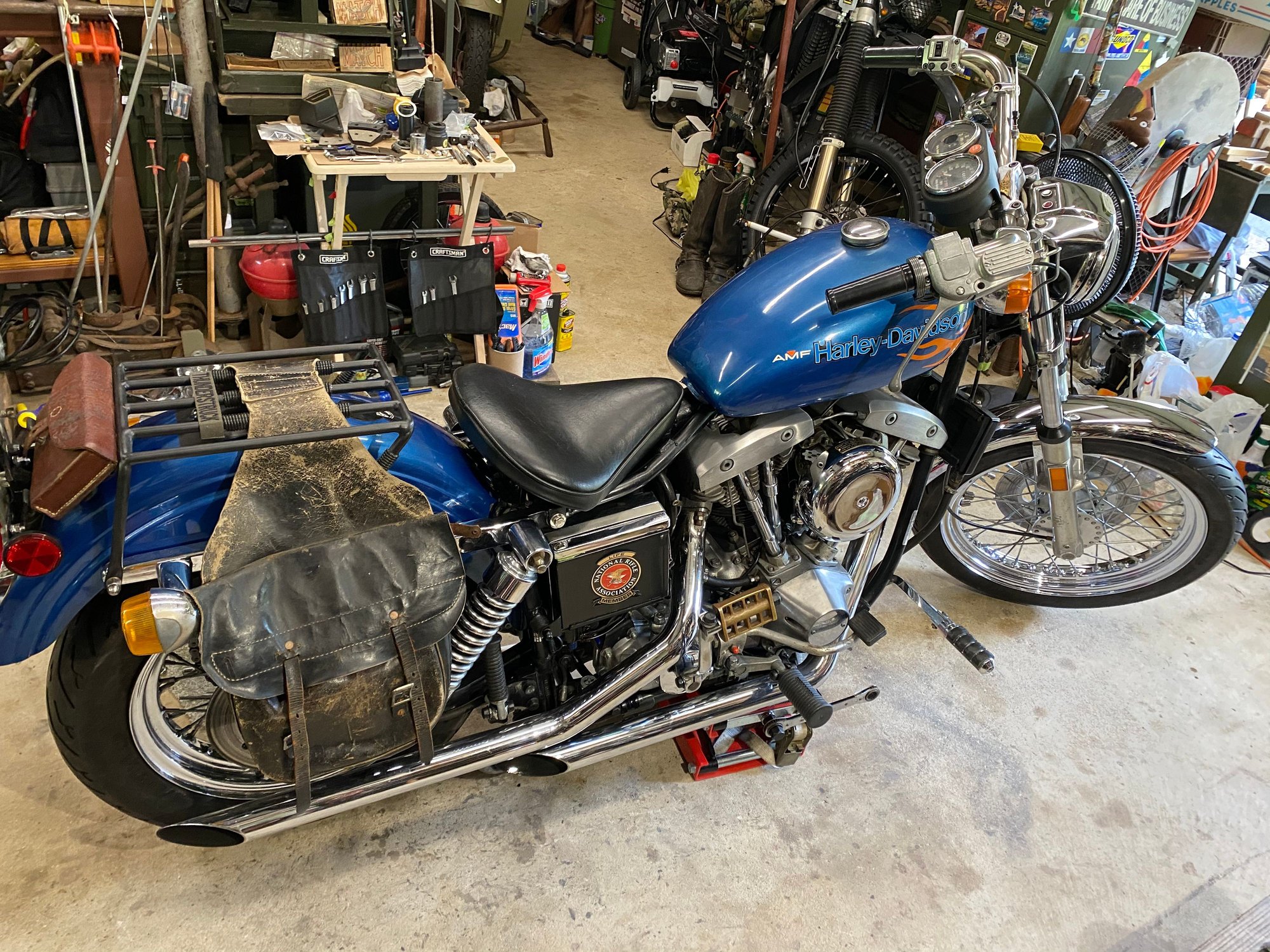

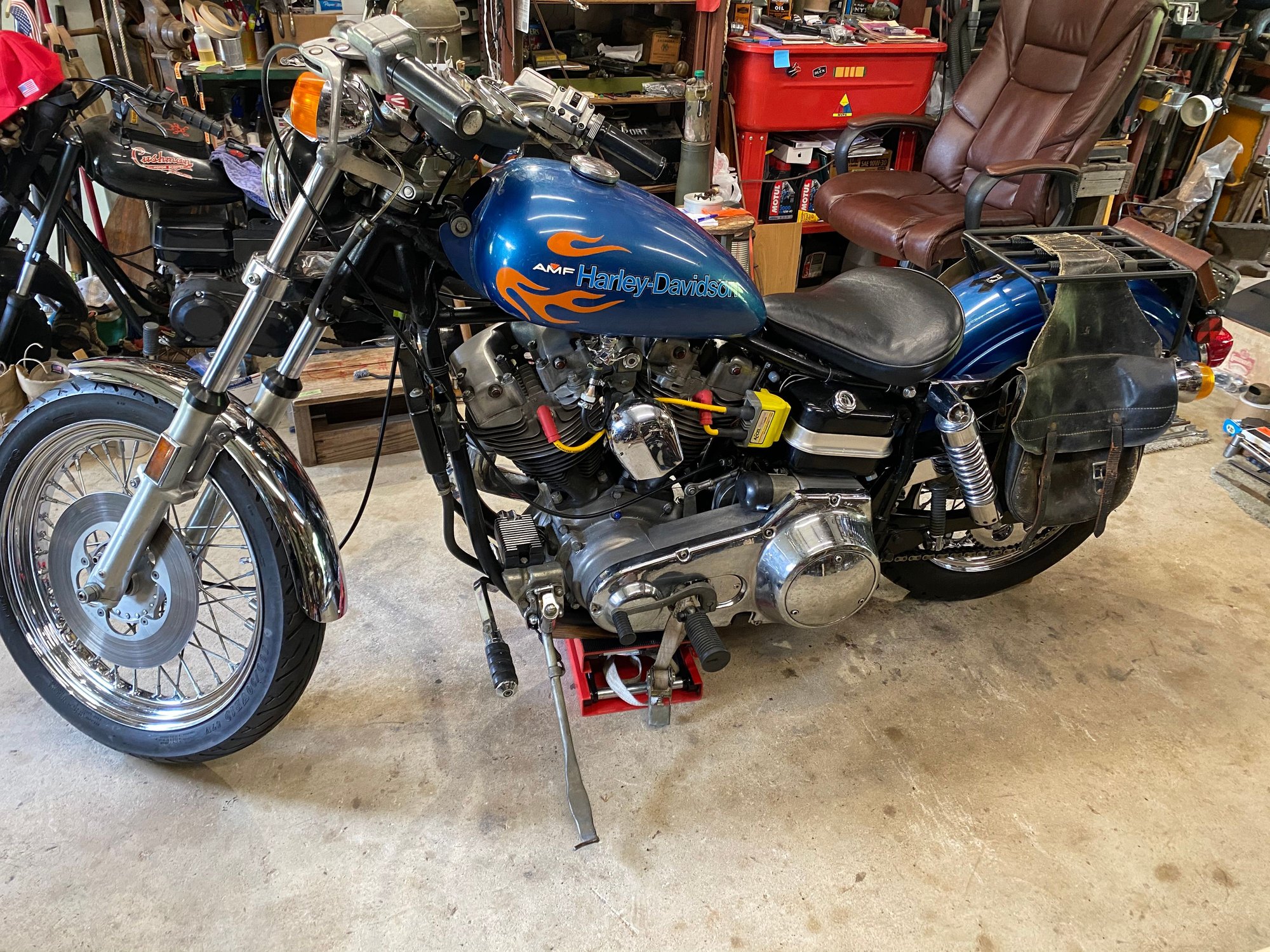

Default Baird pix request
Here you go Baird. 1977 FXE almost ready to ride after 5 months of bringing back to life.
