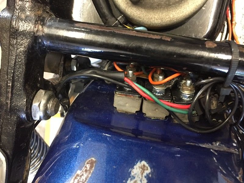

went to start the shovel today and all i get clicking every 5 seconds from 1 of the 3 circuit breakers under the seat without even pressing the starter and when i press the starter the starter relay clicks as well. the ign lights on the dash are not lit when i turn the key on the battery has 12.3 volts. i did have the fender off so maybe i have disturbed something any help would be appreciated

you have a dead short - first thing is figure out which breaker is clicking. then follow the wire(s)

looks like the ign breaker all the wires are connected would it be wise to remove and clean the terminals thanks

Always a good place to start....the last thing you had off.
Are the wires connected to the correct circuit breaker as well as the correct post on the circuit breaker? Make sure that none of the wires that should not be touching are not touching one it shoud not.
Never hurts to clean the wire ends and terminal post and/or replace the breakers with new ones as the need arises.

no wires were disconected exept the rear blinkers so the struts could be re chromed can circuit breakers fail thanks

Anything can fail at any time when its abused -
remove the wires that’s really on the breaker popping - that are doing a a function and then the key on re attach one at a time and see what one is causing the short - now you have the color the wire is - first step - take a look at the wire diagram and see what it does

Or a pinched wire that is grounded.
You said you didn’t take off any wires except the blinkers were taken off. So you did take off wires. And there are a lot of wires mounted at the rear fender.
As mentioned, start pulling off wires until the short/clicking goes away. This issues should be a rather east fix.

I would recommend going with what johnjzjz and lowoilpressure suggest....either a piched wire or one that is grounding out.

I would 1st look at the circuit breakers under the seat on the fender. You removed and replaced the fender. Nothing was shorted before but now you have a short. You said turn signals were removed for plating. Should not hear clicking short circuit breakers unless you are pressing the turn signal button. Take your time and look at every wire on every connection of every circuit breaker. One of them has a hot wire that is touching the frame or a ground wire or the fender.
