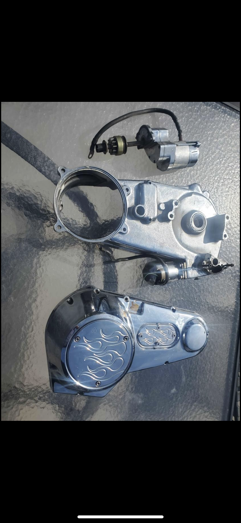

Says it’s off a 1340 not sure of the year though. Can’t tell if the inner primary is buggered up where starter attaches. $300 or best offer. Will any of this work and i assume it’s not a stock starter but China.

That's off an EVO. For sure inner primary and starter motor will not work. Can't say on the outer primary.
Also, pull your outer primary off and see if it has the caged needle bearing pressed in for the starter jackshaft.

Thats a 9 hole inner & outer primary for a rear belt drive, you need an 8 hole primary , keep looking , 600$ + dose seam like a lot !

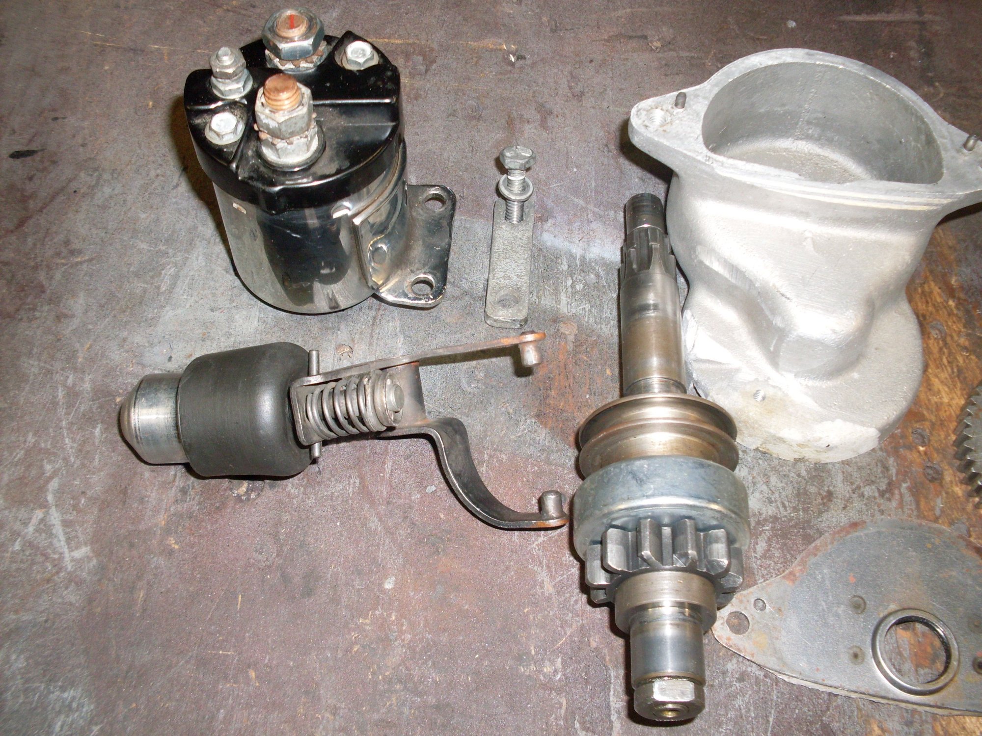

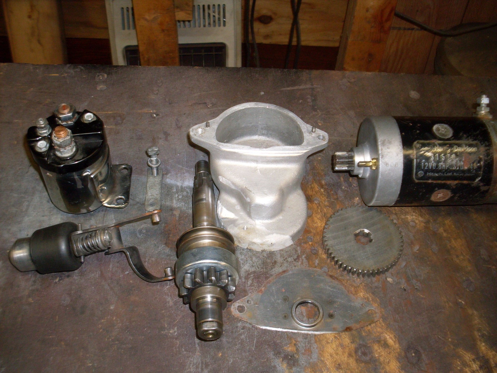

I have most of the parts you need. I do not have the pivot bolt for the lever. I do have the spring that goes inside the Solenoid for the lingage but it was behind the starter to keep it upright so that you could see the AMF. Sticker. I am not in a big hurry to sell the stuff as it it good stuff to keep around, but if the other deal doesn't work out, hit me up with an offer and I'll probably help you out.
