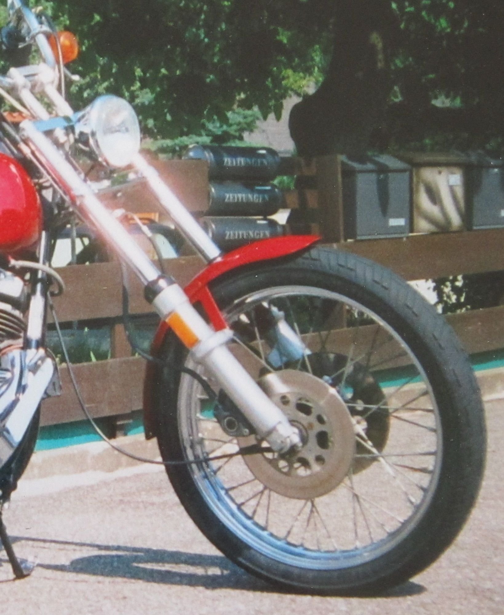

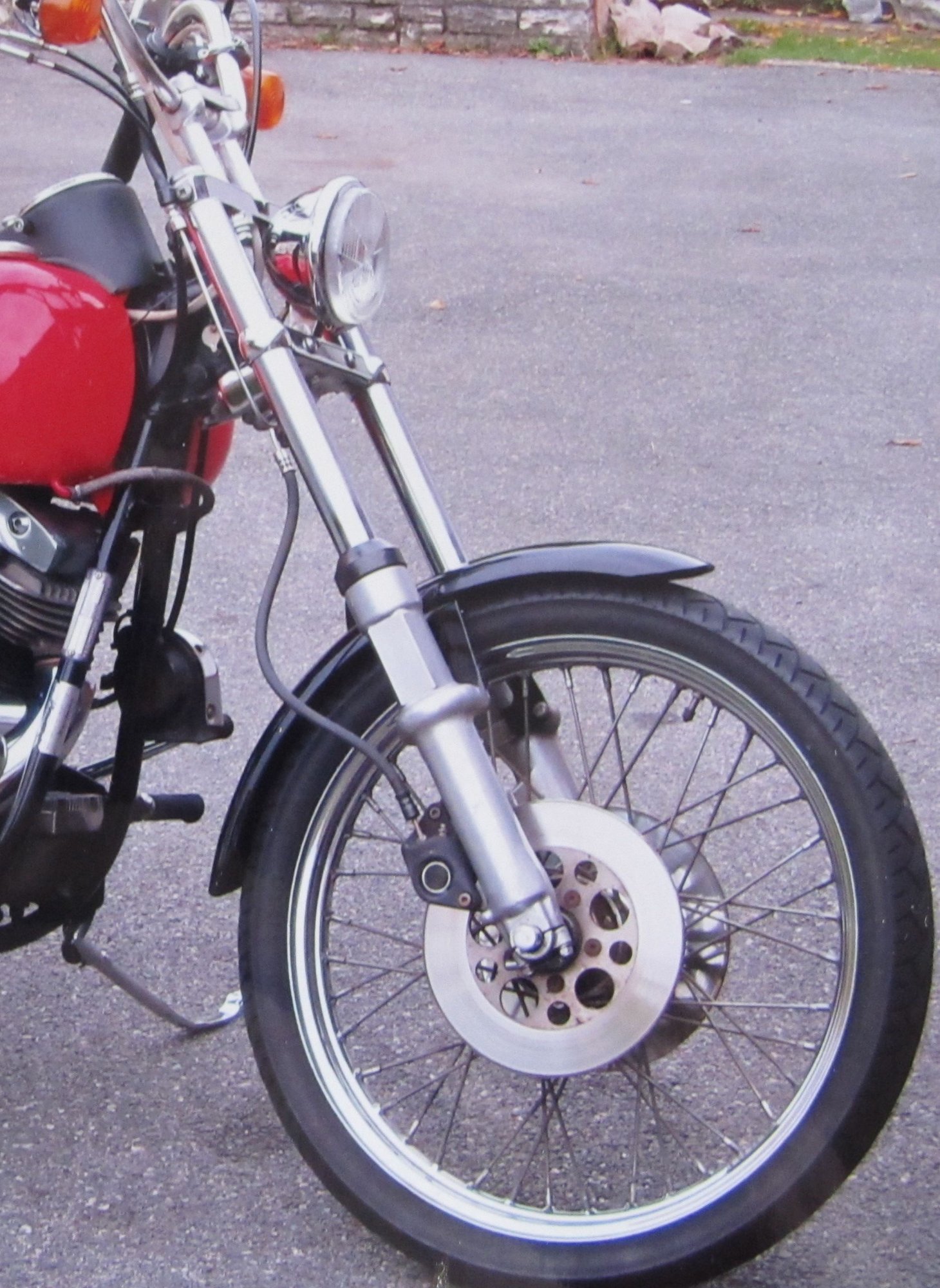

i tried to look up the parts needed but my parts book only lists the parts needed for a trans. drive . . .
heres how my Wide Glide came with wheel drive speedo . . .
& heres after the conversion to trans, drive i might still have the Wheel drive parts . . .PM me if your interested in them

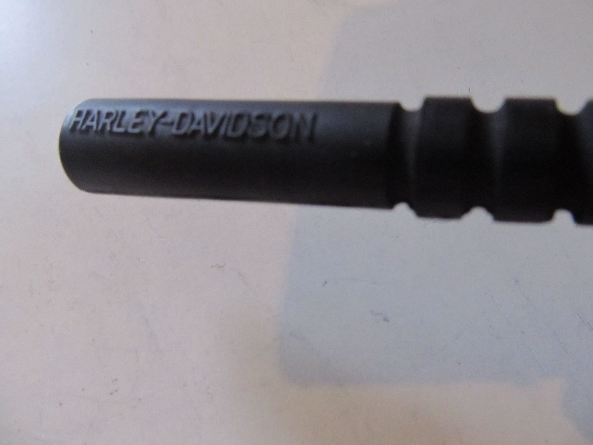

to pkty ,
here are some photos of my right side wheel drive parts . . .
here's what i have . . .sorry I am missing the drive unit , Axel is H-D Part# 43875-73 80-83 FXWG, spacer is 17mm wide
Kilo-meter/mile speedometer H-D Part# 67005-68c 82-83 FXWG
notice how small the cable connection is . . . it measures 11.6mm (coming from speedometer)
trip odometer is in good shape . . .
speedo cable where it screws into the drive unit . . . "HARLEY-DAVIDSON" . . .where didn't they put their name ? lol Well if your interested in these parts PM me , i am sure we can work something out !
