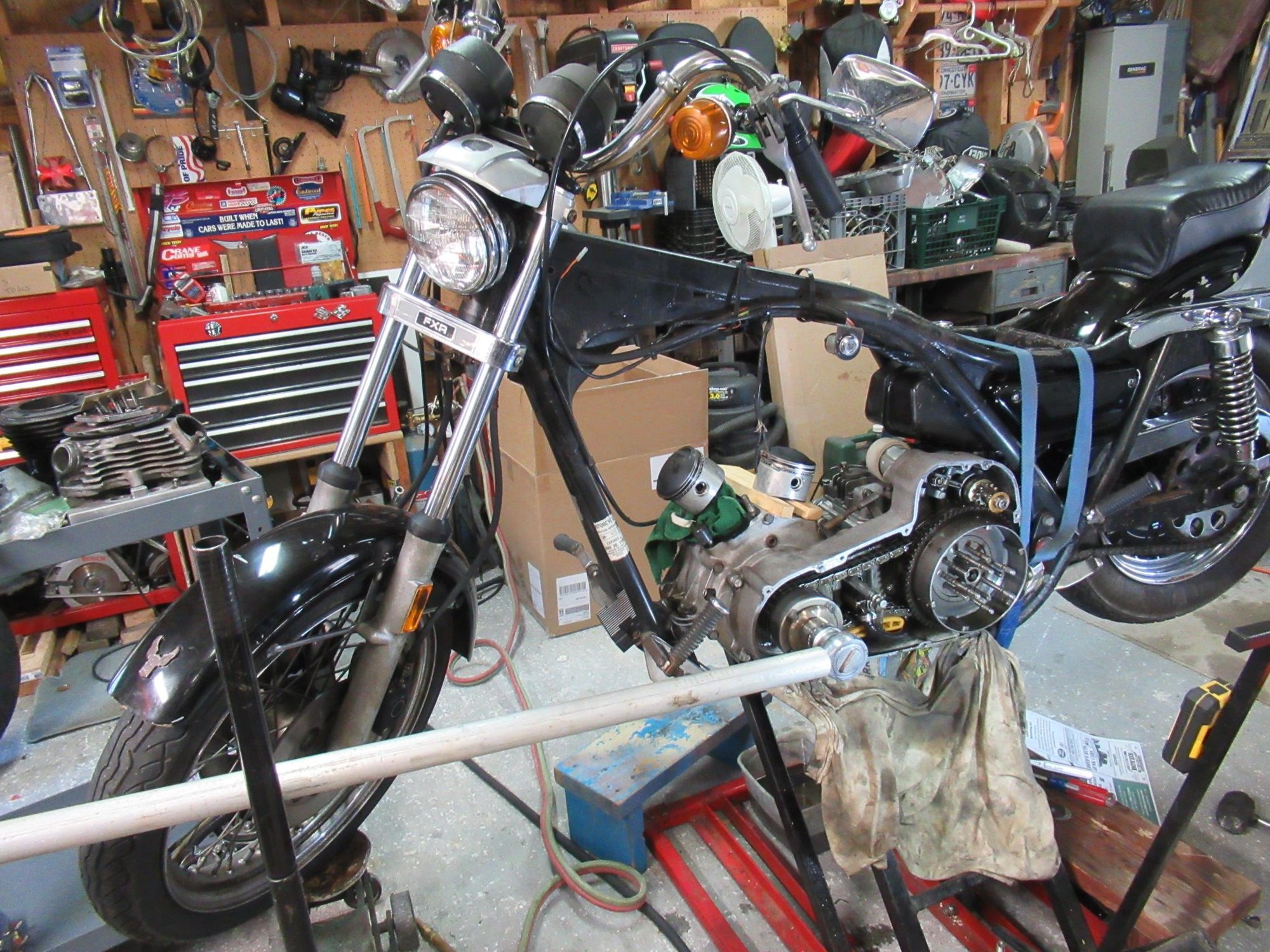

Maybe huge vice grips, with a pipe on the handle, and a sledge hammer to whack it. Maybe some PB blaster too, if there is any corrosion.
Originally Posted by Joe12RK
This is what it took to get mine loose - someone used red loctite! That's a 5 or 6 foot length of pipe! I am replacing the pistons, rods and bearings so not worried about damage there.
Originally Posted by SparkyD
First time I had to take mine off it took 4 days:
Sprayed with breakfree it the morning before using impact gun for several minutes. Sprayed again and went to work. Got home and put the impact on again for a while. Hit of breakfree before bed.
Did this 4 days in a row, on the 5th morning it came off. A practice in patience.
That looks like an old SK 1/2" drive ratchet like the one which was passed down to me by my grandfather back when I was a teenager in the `50s. They don`t make `em like that anymore. I bent a 6' cheater that was cut from a piece of 1 1/4" steel electrical conduit when in a similar situation. It got the nut loose though and didn`t break my ratchet....... `Still don`t recommend it though... Go impact.
