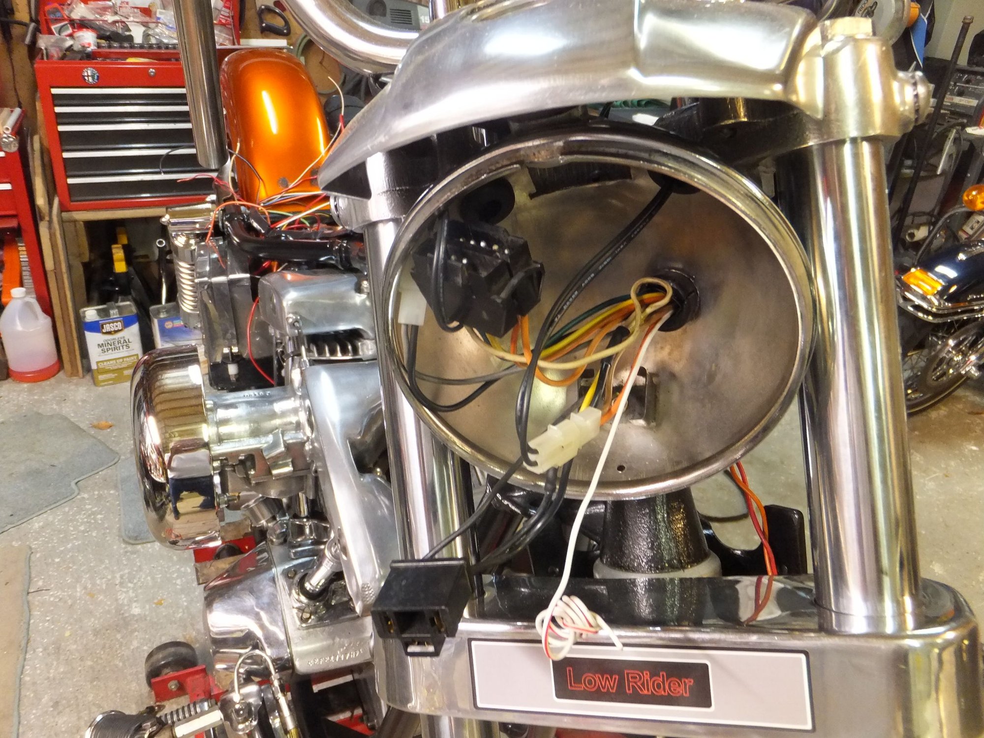

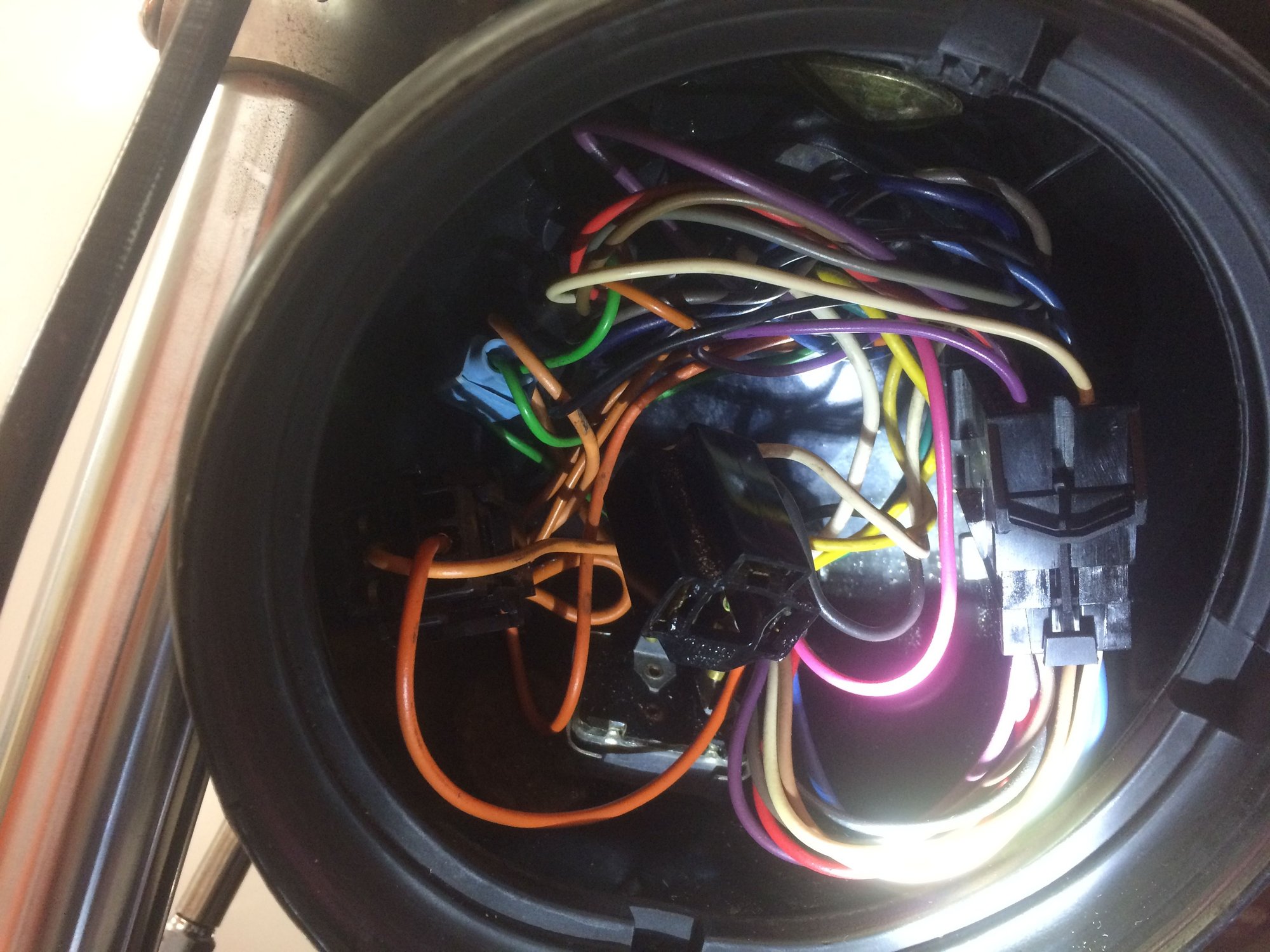

If you can live without turn signals it gets a lot simpler:
The big black one snaps into the top of the headlight bucket and is out of the way too.
