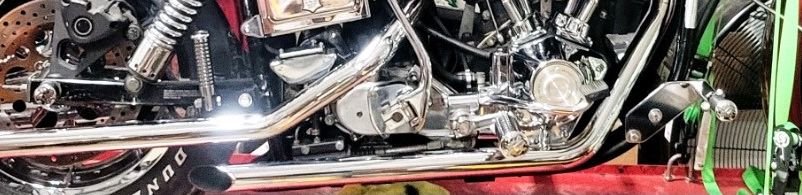

My '85 was like that, but the rear master cylinder is on the new extended foot peg which will require fabbing a brake line. At least according to the Drag Specialty pic, and their comments that say a custom brake line is required that doesn’t come with it.
This is my trouble with DS. I bought a passenger back rest for a chopped tour pak made by DS (through a dealer) that ultimately wouldn't fit a Harley chopped tour pak without drilling more holes in a brand new painted part. I got dinged on the return to the dealer, who couldn’t have answered the question if I’d asked because DS ships the parts boxed and sealed to their dealers, and you can’t talk to DS either. Here is what you see if you click “contact us” at the Drag website.
And here’s a pic. Sorry for the resolution. Had to blow it up.
