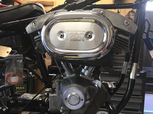

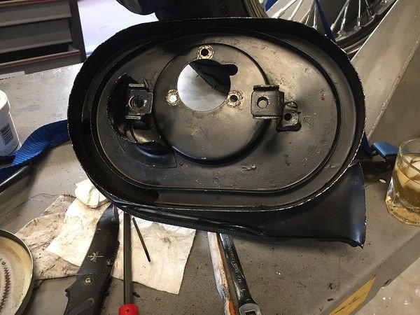

FYI backing plates and air cleaner covers changed over a course of a years you are asking about. In 1977 HD went to the "pig snout" air cleaner backing plate but kept the oval chrome cover used on earlier models. That all changed bigtime mid 1978 when HD introduced the "ham can" style air cleaner and backing plate. FX models caaried the 1200 on the aircleaner covers They did not get the option of the 80 in motor until 1979 models; FLH models mid-78 could be purchased with either the 74 or the 80 cu in motor.
Pig snout backing plate on the left; ham can backing plate on the right
Pig snout with cover installed and "1200" name plate on the left; Ham can with cover installed and "1200" name plate on the right.
Thanks Panz! That is exactly what I needed
MY carb would have been OEM in '77 so I need to be looking for the Pig Snout.
if you know of any sources I would appreciate it

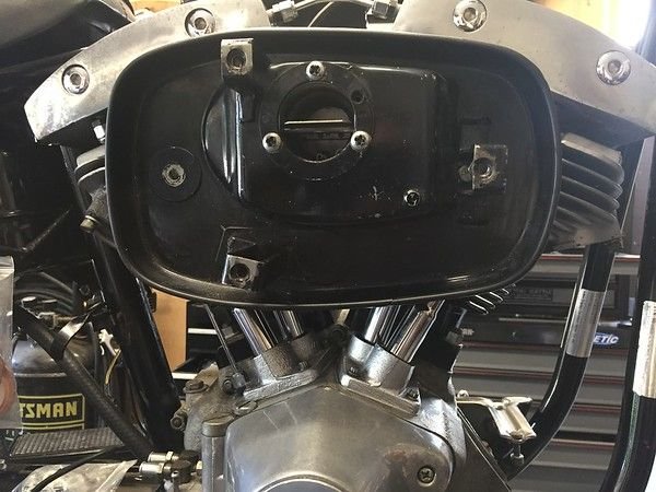

My 1970, with S&S Super E and stock style air cleaner. W&W in Germany makes adapters to get stock backing plates to work with aftermarket carbs.
Adapter from W&W, slightly modified to clear backing plate.

Herez your backing plate
https://www.ebay.com/itm/25550316724...IAAOSwSNViZCqH
Looks to be in decent shape. First one I've seen in a while. They were used for a short period of time (1977-E1978) and came stock for sportster models as well as FLH and FX seires. They were MoCos attempt to meet the EPA/CARB more restrictive regulations. Don't find too may around because it was one of the first things dumped by the new owner (along with exhaust). Folks just went with the pre-77 oval backing plate.
