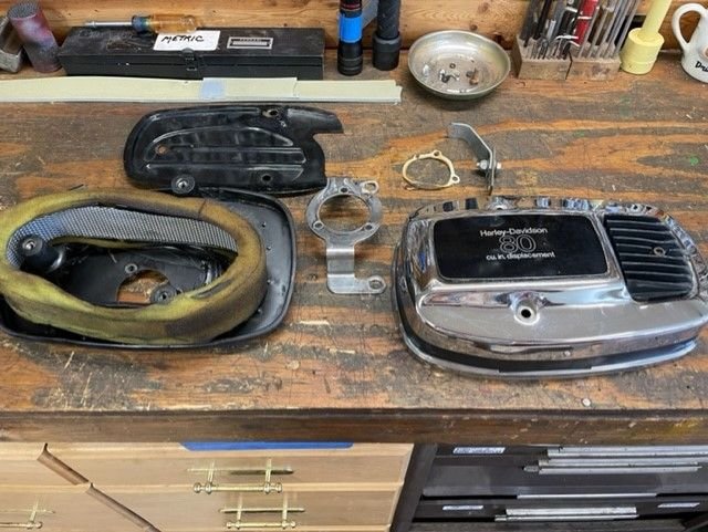

Dug out the ham can air cleaner.
My mistake - it's from a 1984 FLHT and probably wouldn't look right on a late FLH shovel.
Free to anyone who wants it.

No, that won't work. Thanks for checking.
That's a good deal for anyone who can use it.
