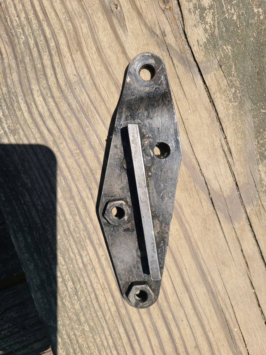

Helping a friend put his bike back together. I have restored a shovelhead but it's been 30 years ago. And it's a little more head scratching when I am not the one that took it apart and all the bolts are in one bucket.
Where I started and where I am at now.
this has me stumped, what is it / where does it go?

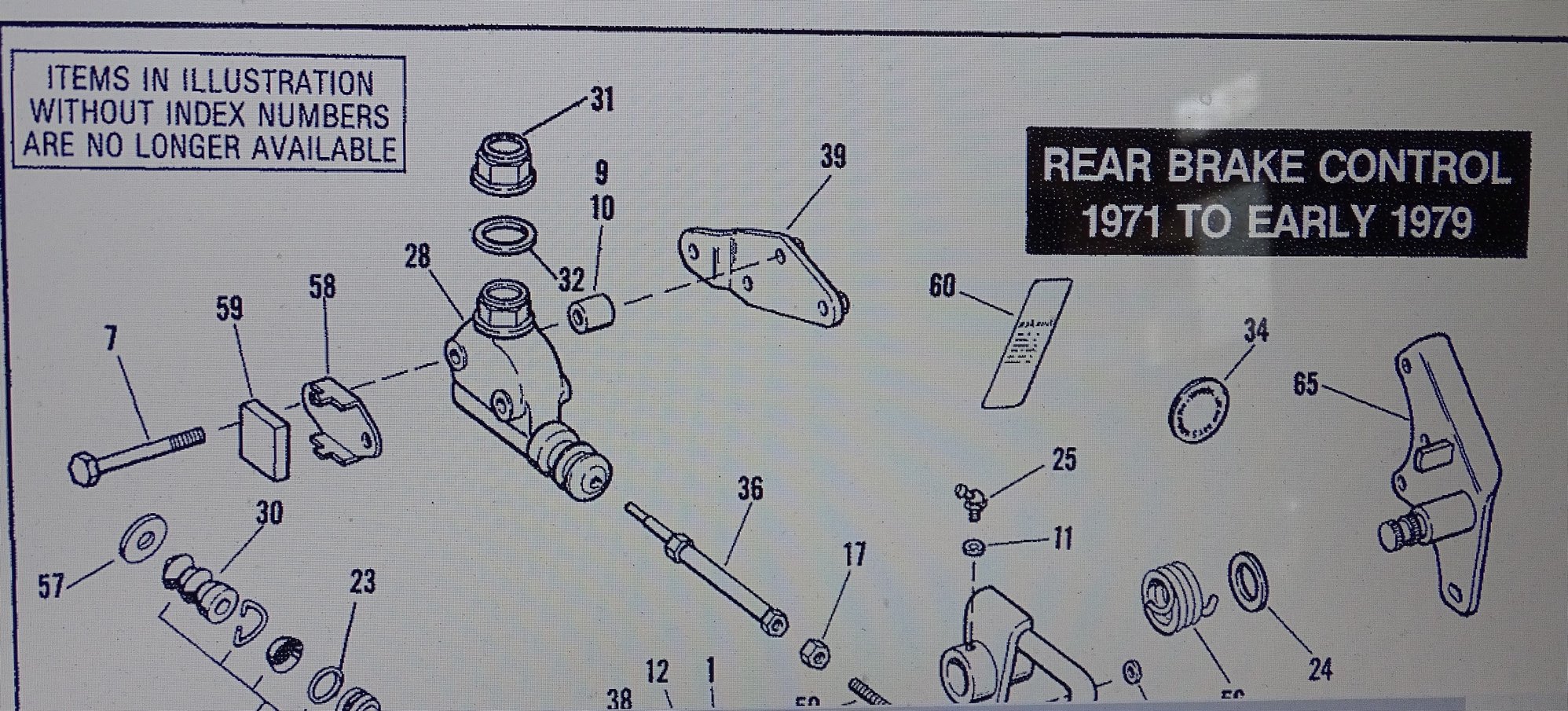

its the rear master cylinder mount on the right side of the frame near the muffler hanger ...for use with mid controls,on FX models...HD No- 42299-72-support bracket. E72-E79

that bracket bolts to the frame just under the trans. holds the master cyclinder

I also meant to add that if your going to use forwards with the master mounted in the front, you do not need the bracket, its only if Mid's are used

Magnum45pete- thanks for the diagram
