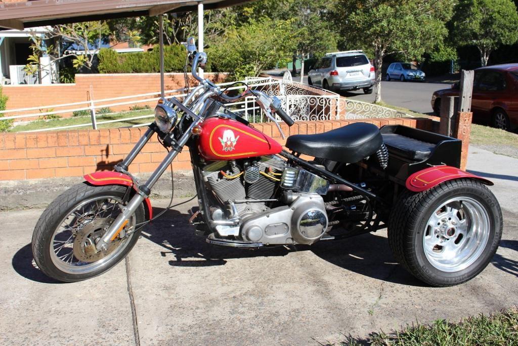

i charged the battery on my trike was showing 12.4 volts but when i tried to start it the engine was turning over as if it was flat but showed 12 volts the battery is 3 yrs old and trike not ridden for 6 mths terminals were tight and clean . my hd mech said it should have started.i bought a new battery and it started first go any thoughts ?
