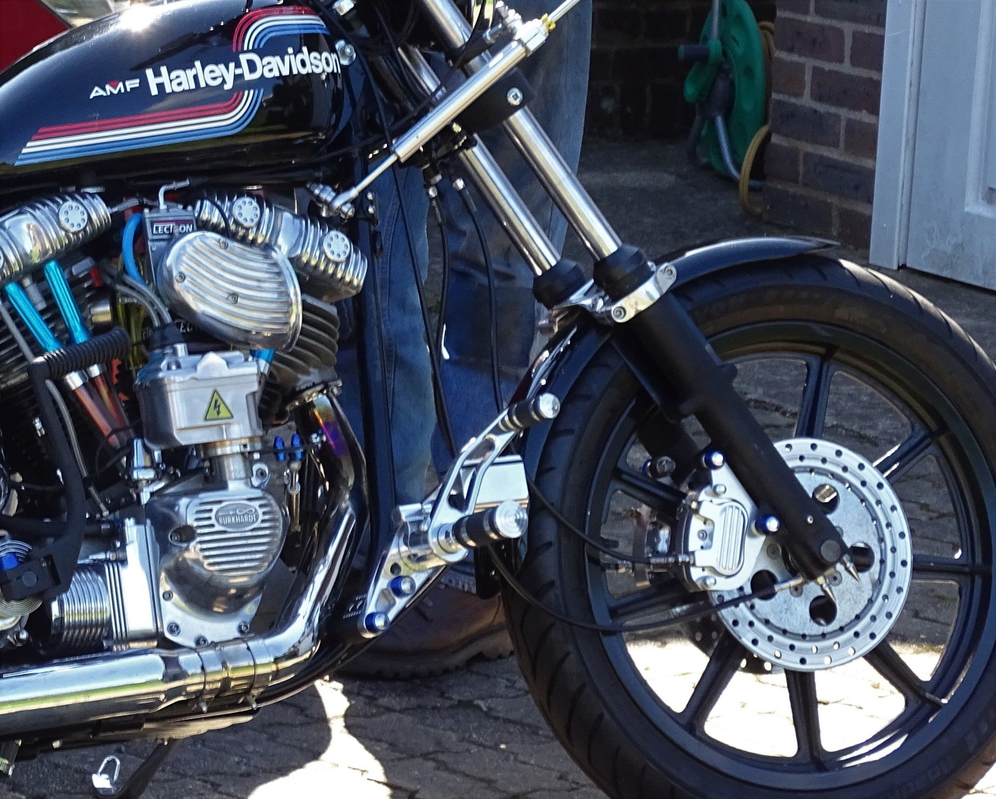

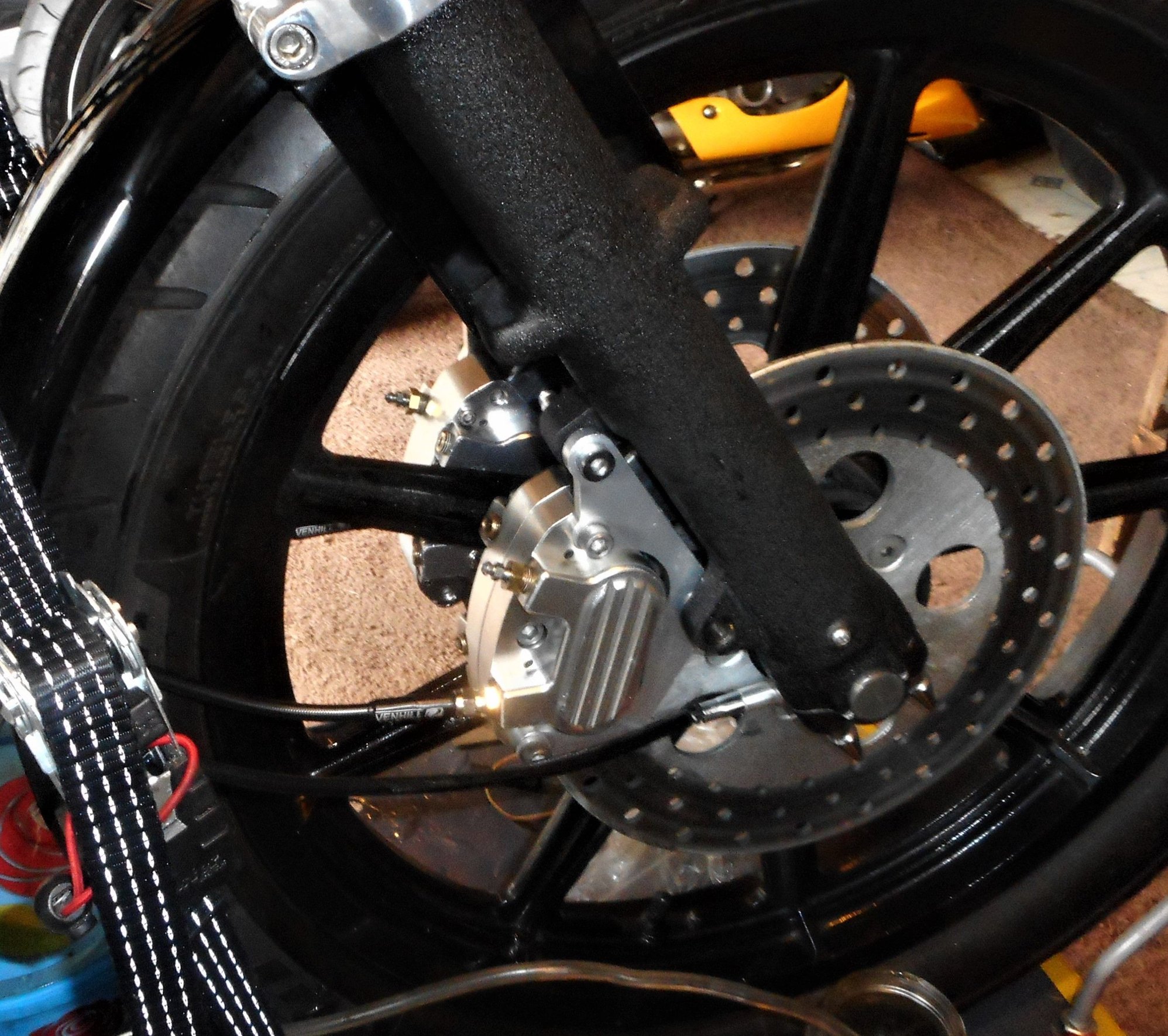

It makes a big difference depending on the original brakes and if you actually ride the machine more than coffee shop hopping and look at me bike nights.
I haven't had a bike without duals on the front the last 3 decades, done many a later front end conversations on older machines.
These went on this 73 I brought back from the dead for a buddy. Picked it all up from a shops junk pile for $300.

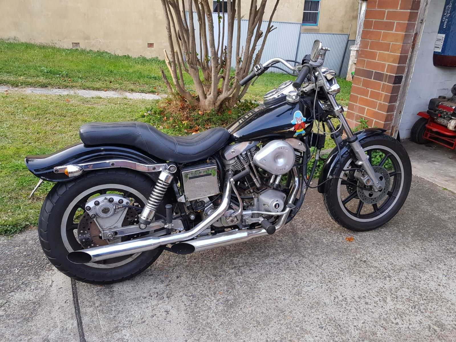

my stock 80 lowrider twin disc front brakes were useless. checked the pads and looked good but someone said change them and clean the discs. wow what a difference. it stops now
