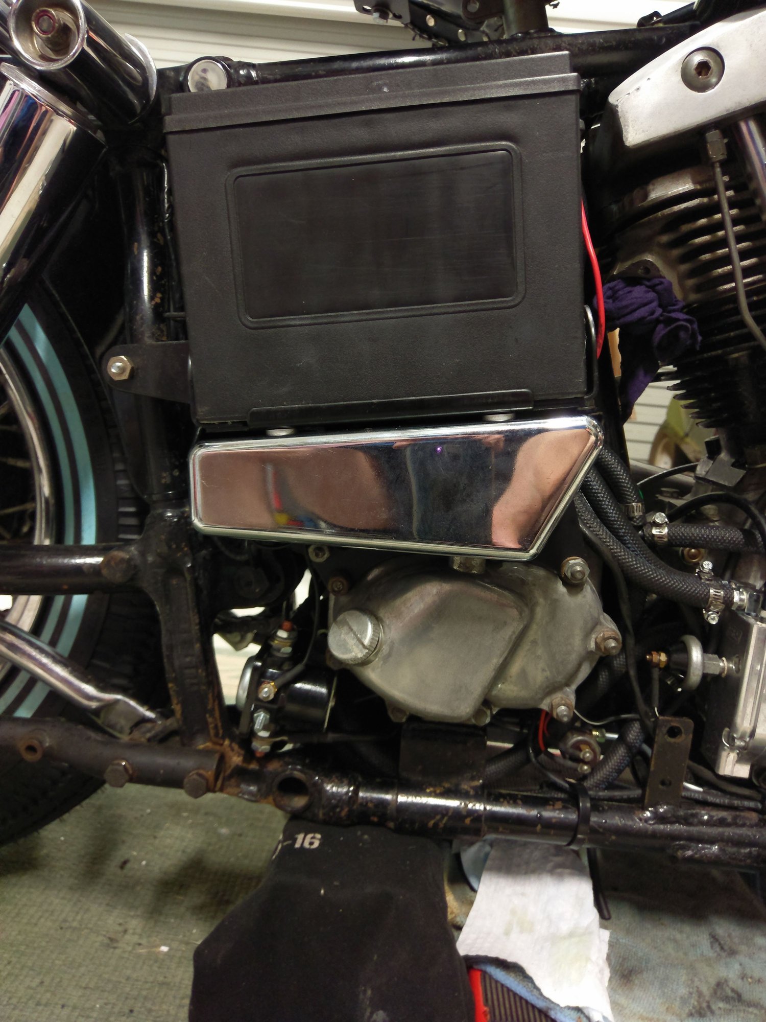

So I've made up a mount for the new relay from an old bracket left over from another project.
It uses the exhaust bracket bolt holes and sits nicely on the inside of the frame at the back of the gearbox, behind the exhaust and there's plenty of room for the wiring
I'll paint it up black and reckon it looks pretty prettyCheers

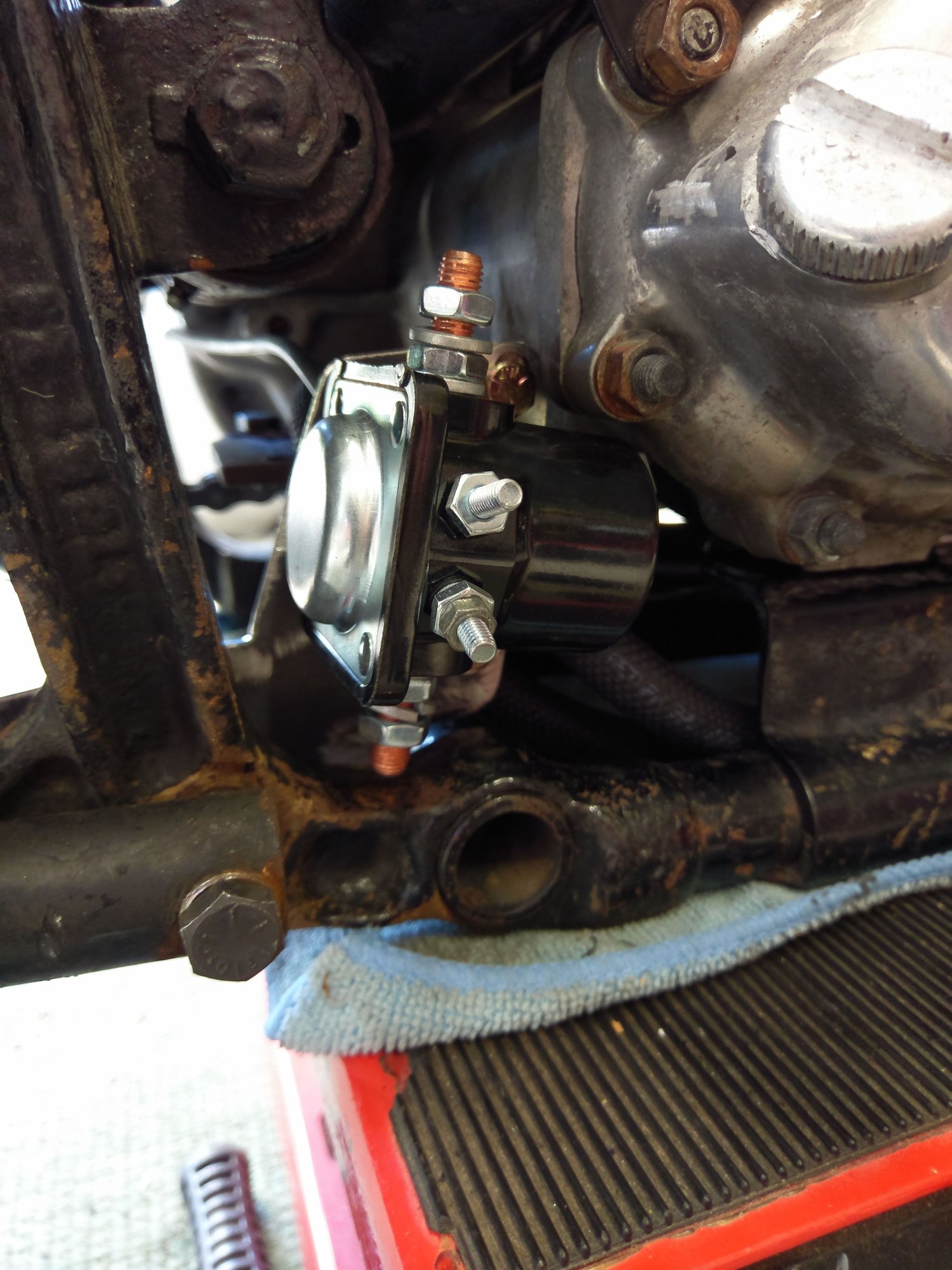

Doesn't look too bad even if I do say myself...
