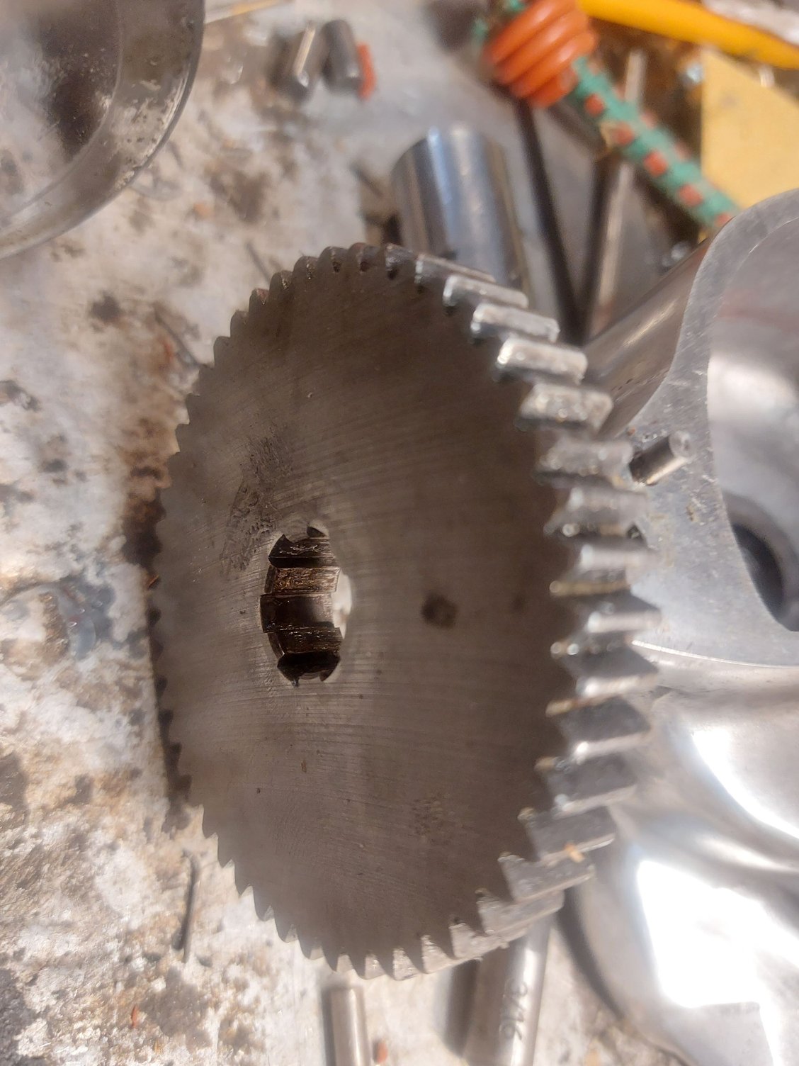

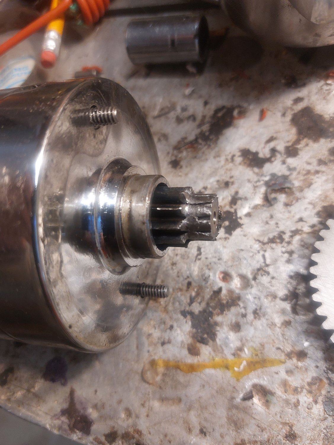

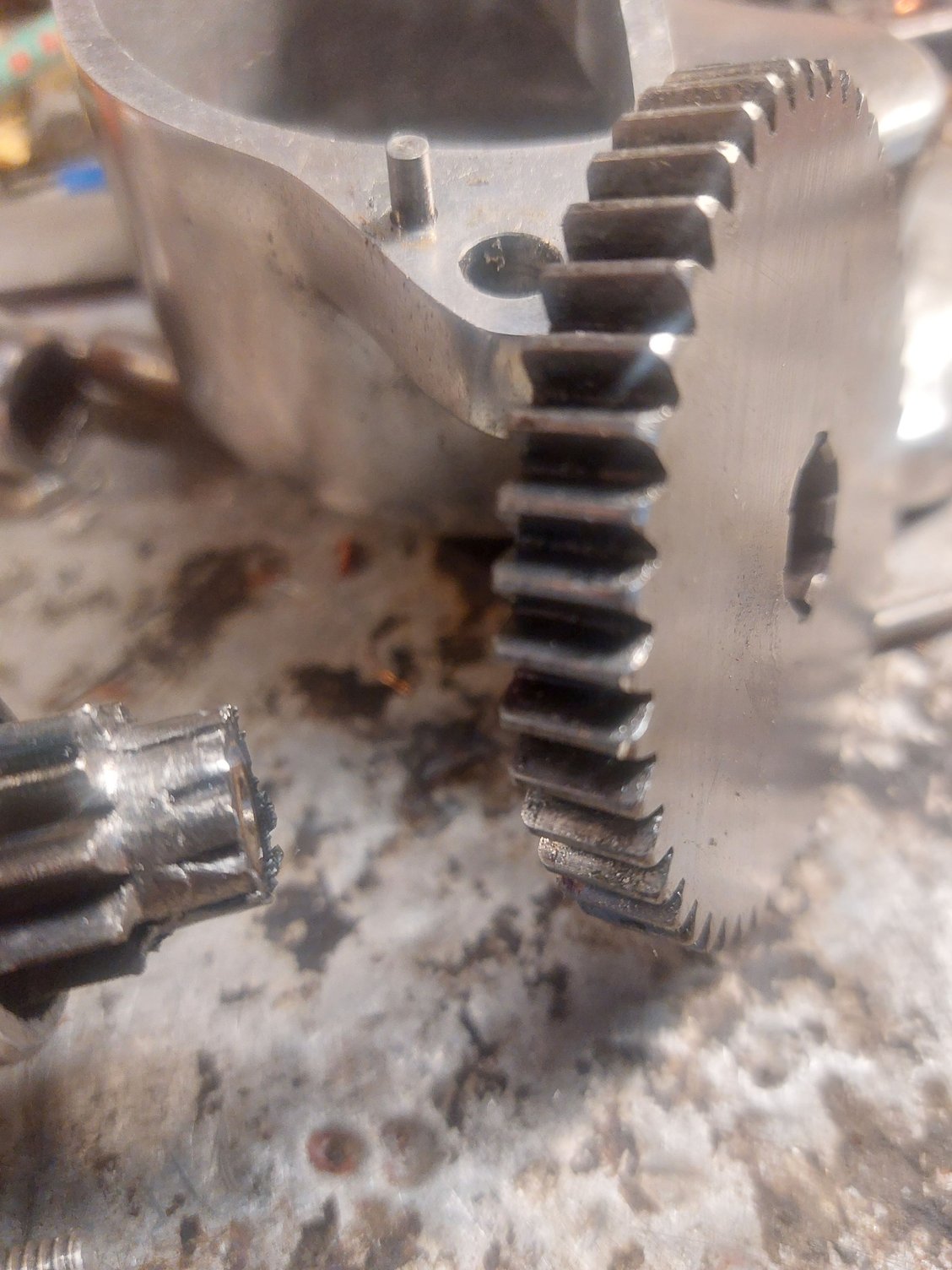

Well, in this case, the little gear on the end of the starter motor is totally stripped, and the starter gear is a bit rounded on the inside gear. I'm not sure if I should just try to pull the starter gear and replace it, or just get a new starter. This chrome one is about 20 years old.
I"m not even sure if I can find a replacement starter gear.

All I could find is a new armature for $100, that has the gear on it.
Or you can get a whole new starter for $150. From J&P. Cycles. Haven't seen just the gear offered.

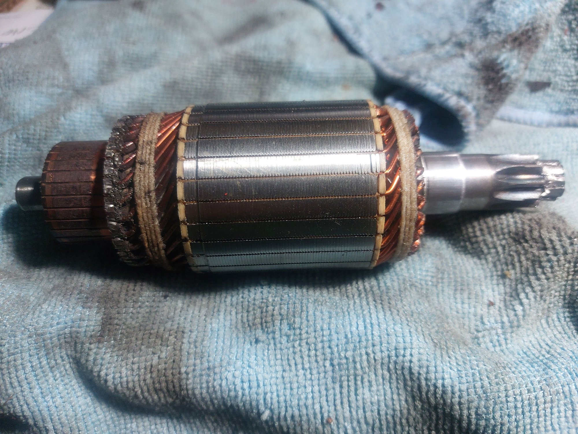

sheesh, I did not realize that gear was part of the armature. What a huge PITA. I have taken apart generators, but never a starter.
I found used armatures on Fleabay for $15.00 each, but that begs the question.......how good are they?
Guess I have to bite the bullet and buy a new one.

Looking at how chewed-up your's is, do you have the solenoid spacer in there? It's vital for alignment.

No Biggie... it is Just as John says aftermarket gear made of Silly Putty.. Sometimes you get what you pay For...sometimes...less
BTW; Concerning timing... Too much advance, or a worn mechanical advance mechanism, stuck on Full Advance, can/will cause engine to "kick-back" on starter...or Kicker too....

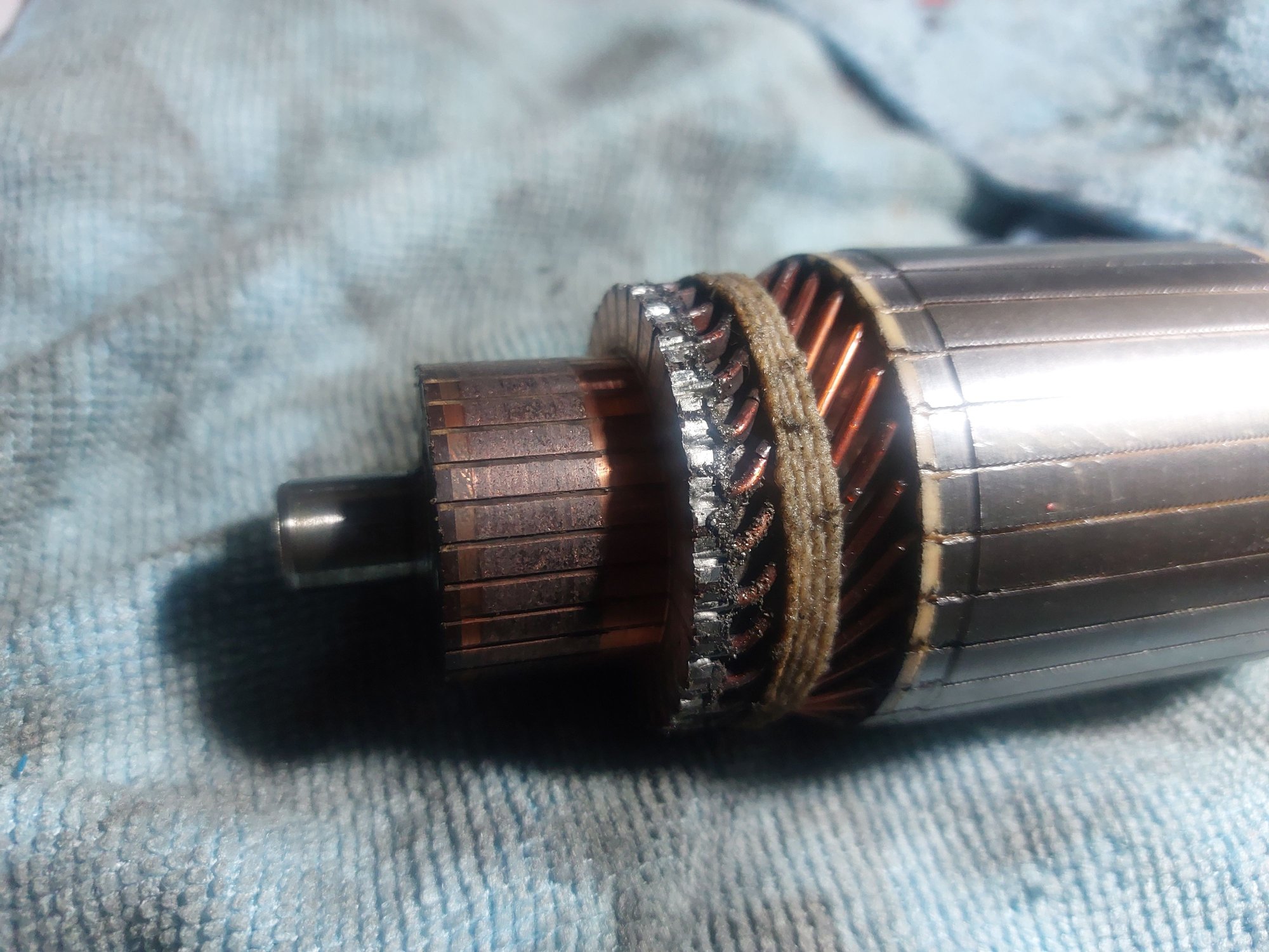

I'm at a loss as to what caused it to happen. I have to retard the mag to start the bike. So I don't think it was advanced. Even so, it's worked for a long time now. In fact, this starter looks amazing inside
At any rate, being a cheap old fart, I decided to buy a used Hitachi Armature off of flea bay. Mostly because IF something else is causing this issue, I'm not out a lot of money.

Old Nov 9, 2022 | 03:22 PM
johnjzjz's Avatar
johnjzjz
Posts: 12,878
Likes: 5,449
From: la la land jerzey
The brush area shows you it was working very hard to do the job
as race said timing to advanced - chain too tight - low amp battery - will do that as well
