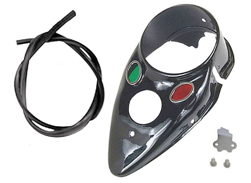

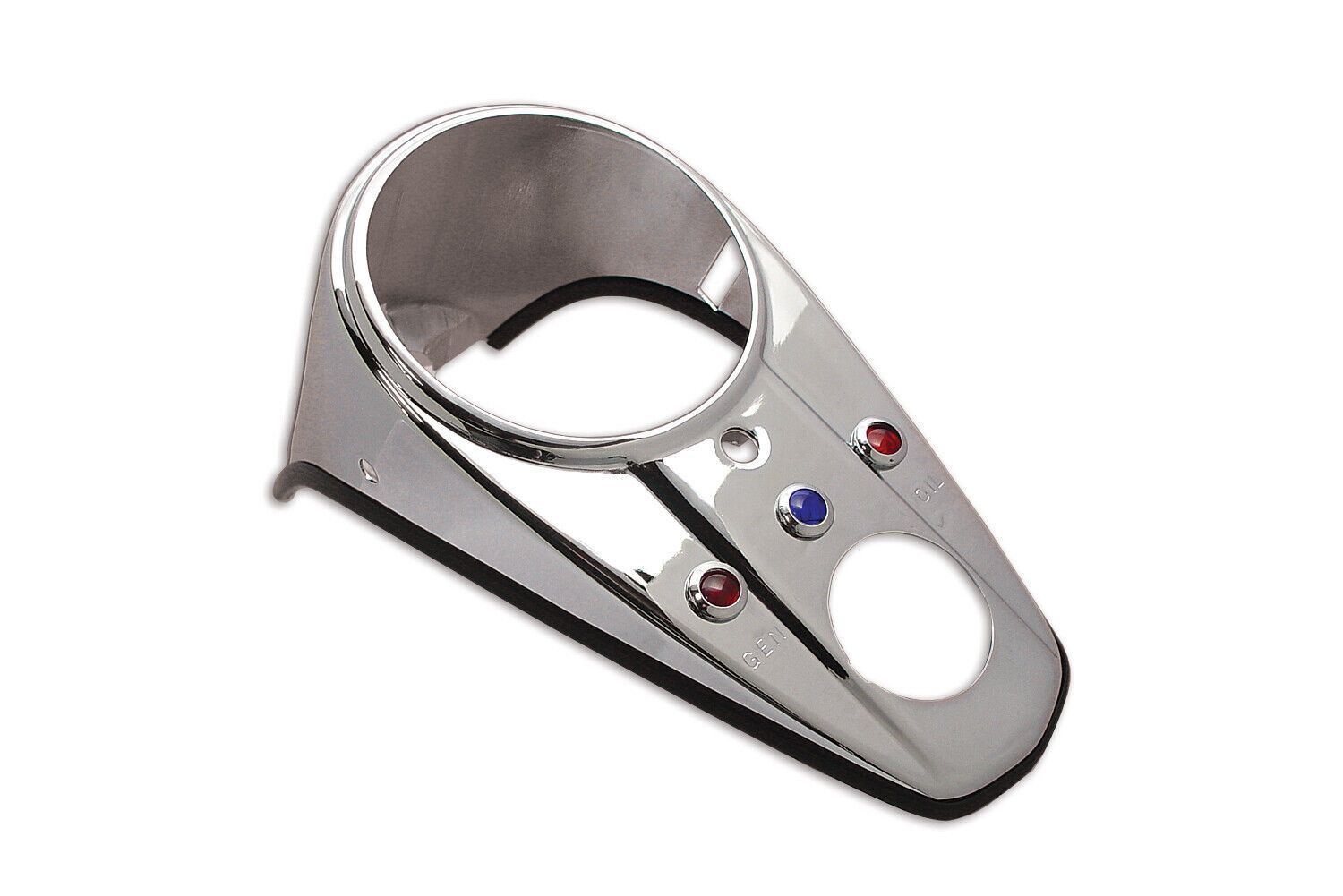

i have 3.5 split tanks with a 3light dash and id like to swap to a cat eye.
just curious before i go wasting cash buying just a dash has anyone swapped it over using he old bracket?
i see the hold down bolt is in a different position but i have no real experience with these dashes otherwise.
thanks in advance.

Cat eye the stay is the 2 on the side of it and the 3 light has a center attach behind the speedo - but they do make the bottom plate for conversions
