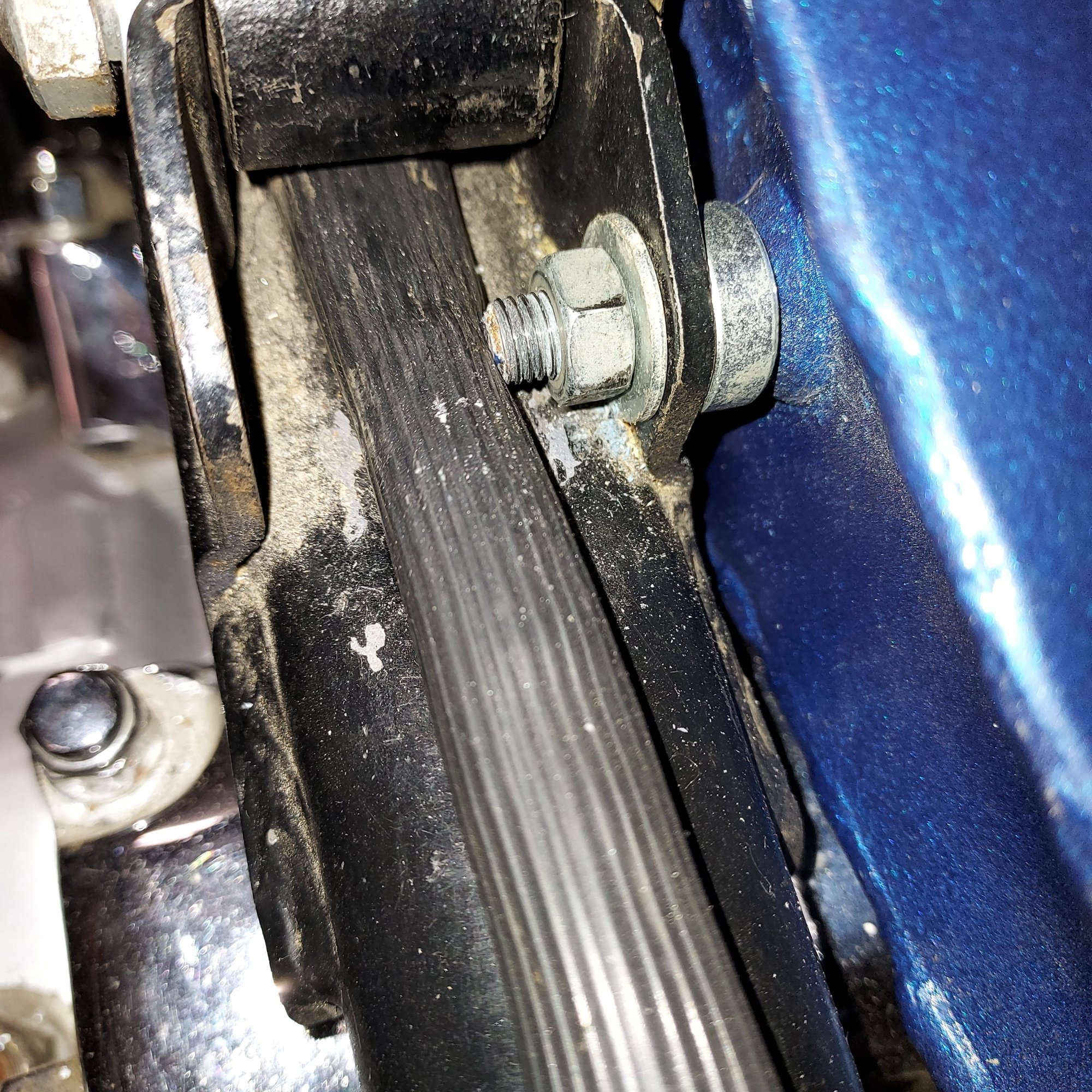

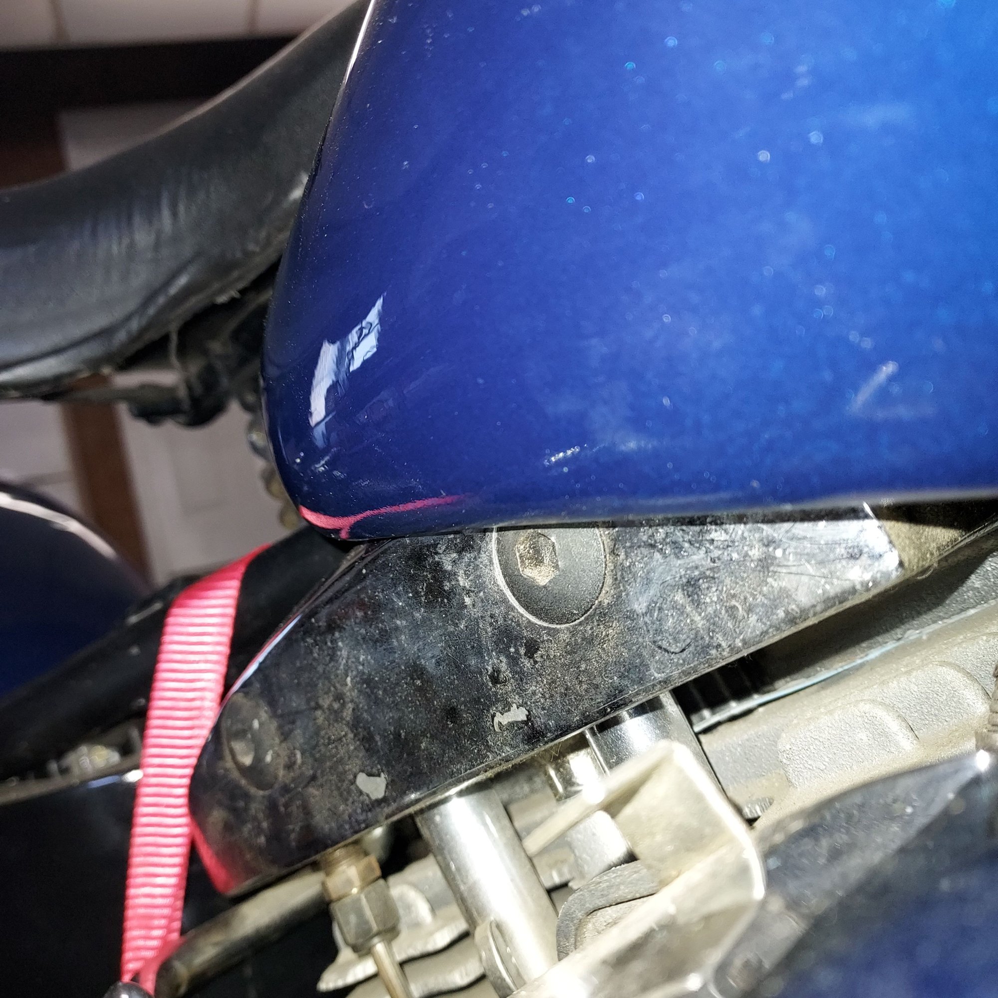

  1. ​​​​​​​

Sorry for the huge pictures but this is what I am dealing with.
i have those spacers on my rear mounts

We see that type spacer quite a bit some times because of the tank curv one is a little shorter then the other so sitting on the machine its uniform to look down

I would want a 1/4" at least in all directions from the engine. It's going to grow as it heats up.

That is how I have mine spaced, before the spacer I could not get a sheet of paper between the rocker box and underside of tank. I know my tank is original, perhaps the engine grew in height during her life and multiple rebuilds (not being sarcastic). It happens, do what you must the gain some clearance, no one is going to notice later.

I mounted them with a 1/2" spacer on the right side and a 5/16" spacer on the left side. It now clears the rear head and looks even. Thanks for the replies.
